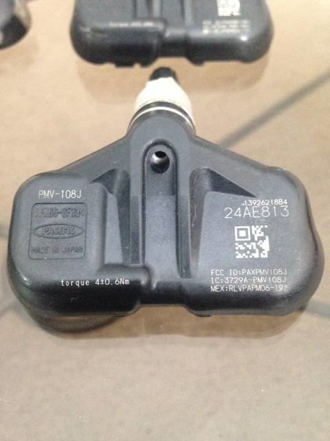

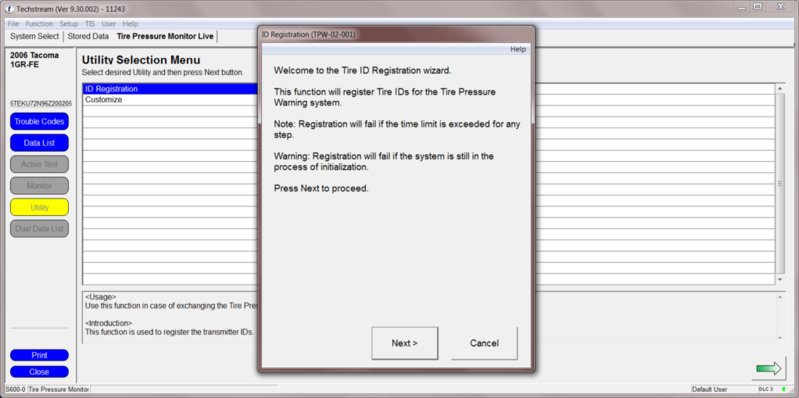

    Yes, to use TIS Techstream to input new sensor IDs, you need to know the IDs beforehand.
    If the modules are physically viewable, the ID is printed on them:
    If not, you can use a TPMS reader, like the Autel TS401:
    Or, a tire shop can read the sensors, probably at some cost.

    So i would need that and a MVCI ODB2?
