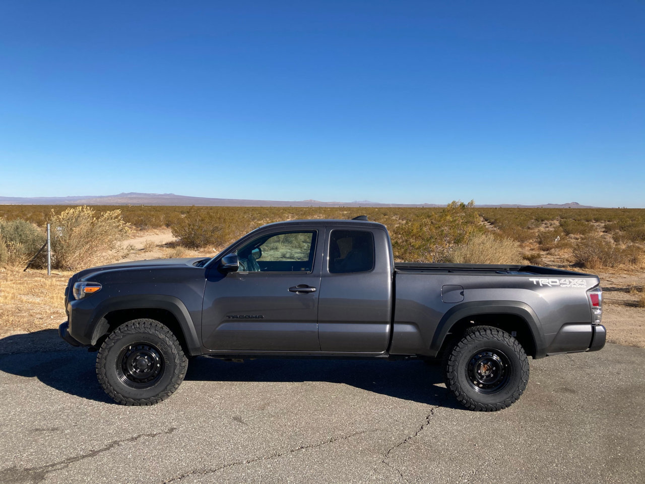

    Hi TacomaWorld!
    Digging up an old thread but didn't want to start a new one for the same issue.
    I bought a 2020 Off-Road, took the stock alloy's off and kept the tires/sensors on them for my summer tires.
    I then bought a set of Road Ready Wheels steel rims (essentially replicas of the spare without the weird elongated hole for the valve), a set of KO2's, found the part number for the steel wheel TMPS (42607-06012) and bought a used set on eBay out of a 2013 Corolla for $40 and new fit-kits from Toyota for $8 each.
    This is the first modern truck I've owned, admittedly I had no idea the TPMS system was this convoluted. I just assumed if the part numbers were the same it would all work. Now I've got a tire pressure warning light and all the tire pressures show -- in the dash.
    Pep Boys installed the tires for me and didn't say anything. I've been to Big-O, Les Schwab and Toyota and got 3 different opinions. Toyota wanted to charge me $150 just to look at it. Big-O said the sensors are bad and couldn't read them, Les Schwab could read the sensors as a Corolla but said I'd need new aftermarket ones that the trucks ECU could read for $400...
    So... what is the truth here?! Can a 2020 Tacoma Off-Road use TPMS sensors from a 2013 Corolla?
    Any informed advice would be greatly appreciated!
    Rick.

    Robert, I finally got the TPMS sensors from TPMS.com installed today. I can't tell you how happy I was to see the pressure readings update on the drive home! Thank you so much for that tip!
    For anyone reading this, the TPMS.com sensors were 1/4 the price of the same sensors the tire store and Toyota were going to charge me. No fit kits needed, they come with the TPMS.com sensors. Toyota dealership were next to useless with advice that amounted to 'just drive it with the light on'.
    New truck ownership would suck without Tacoma World!
