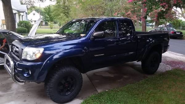

    Thanks for the help guys. This is how everything turned out. Put 3" Toytec on it and 265/75 GY Duratracs on the FJ wheels.

    Looks like you fared ok Op. truck looks nice
