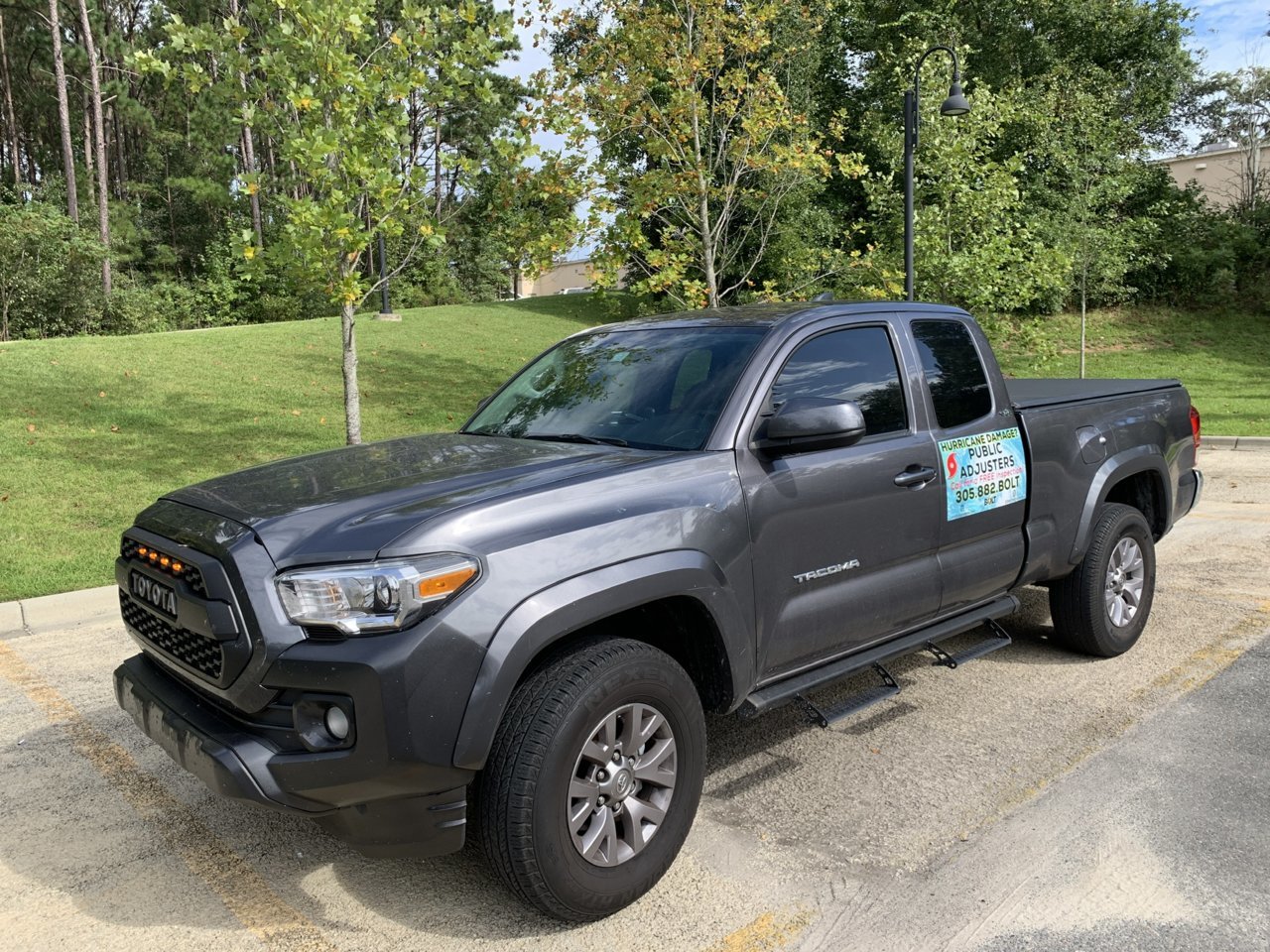

    here’s a photo of my taco!
    thank you!!

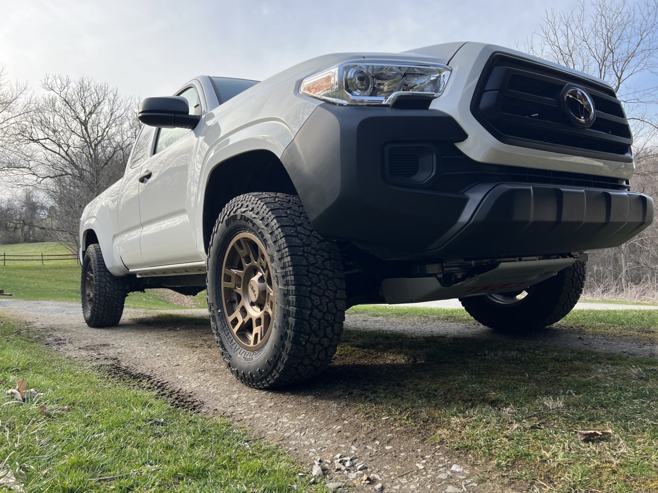

    I went with 255/70-17; on TRD wheels; that’s a 31” tire. About 1/2” bigger than the stock tires with 16” steel wheels

    Falken Wildpeak. Zero rubbing no lift, barely notice MPG loss

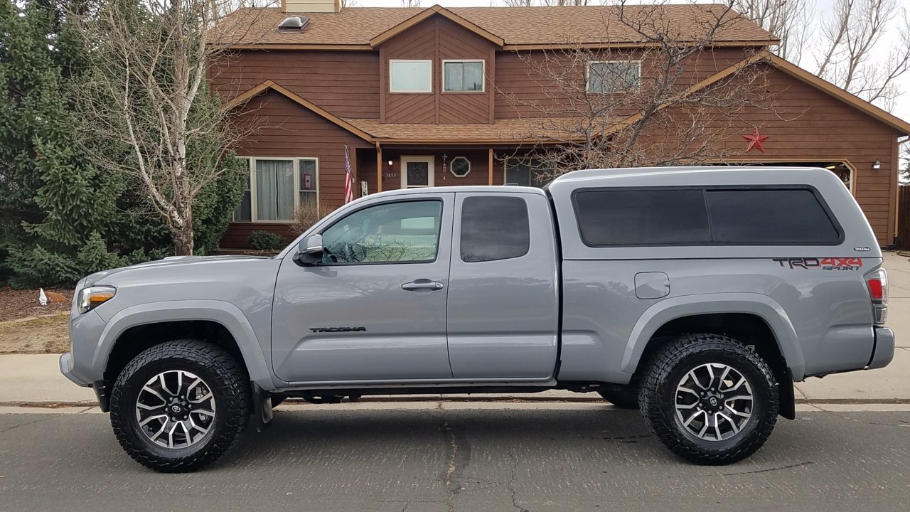

    Access Cab with 17 x 7.5 and 265/70/17 Wildpeaks. No rubbing on anything.20210404_165358.jpg
