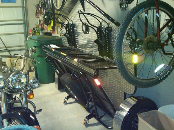

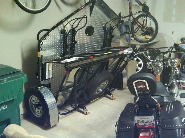

    I was in the same boat as you. I can't have a trailer sitting outside my house. So instead I purchased a drop tail fold up trailer. Its very very well made and top of the line IMO. I can tow two 1000 lbs bikes side by side. Drop tail also makes a single bike trailer.
    The good thing about them is they fold up and have pop down wheels that allow you to stow the trailer in a garage. When folded, I can move the whole trailer around with one hand.
    Check out their website. http://www.droptailtrailers.com/
    Kendon trailers also makes decent trailers but I prefer drop tail due to their hydraulic drop down
