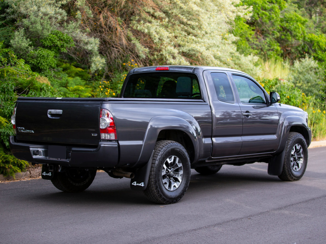

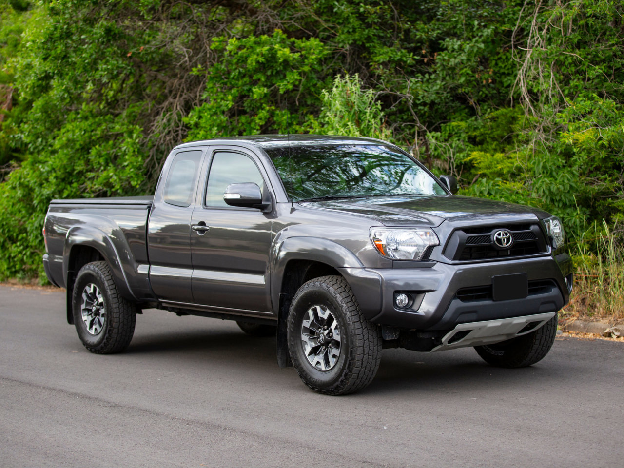

    Hey everyone. Just joined and looking for some suspension help. I’ve been searching the forums and have mostly figured out what I need to do but want to present my situation just to make sure.
    I just bought a “new” to me 2015 SR. The previous owner was incredibly meticulous with the upkeep and installed extras to essentially make it into an SR5.
    I’d like to upgrade the suspension and have pretty much decided on the Bilstein 5100s since that seems to be the Tacoma thing to do. I wanted to raise the truck an inch but no higher. I also want to keep the rake how it is so I’ll need to raise the rear as well.
    If I get the 5100s and opt to raise the front 1”, do I need anything additional like new springs? Will I need the AAL for the rear with the 5100s if I raise the back 1” as well? I just want to make sure I’m not missing anything. From my understanding, raising the truck front and rear 1”, I won’t need an AAL or new springs for the front.
    Also, any suggestions who to order from? I plan to do the install myself.
    Thanks everyone

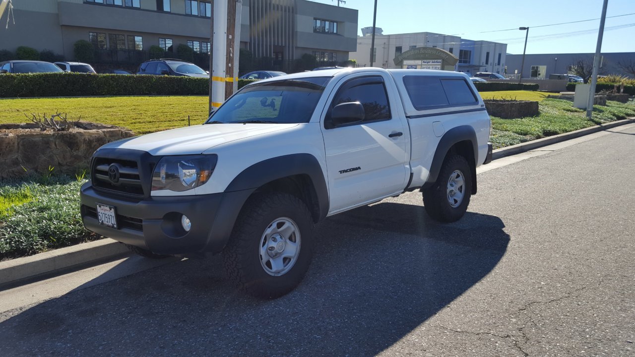

  20. Jun 25, 2020 at 10:20 AM
    #20
    P51DeP
    P51DeP Well-Known Member
    Dec 18, 2016
    #205140
    449
    Christopher
    San Jose, California
    2008 Single Cab Tacoma 4x4 Super White
    Fog Light Install, BFGK02's, Bilstein 5100's, 4x4 Armor Rear Bumper, Front and Back Light Housings(Euro Black) Sound Deadening Cabin, Tint all around.
    Same size in Ko2's. Pics are with the AAL and 5100's all around with stock springs. Tire size is just fine with a light lift, wont look goofy. Without the AAL you will have a sagging back end. I am just a dude on the internet tho so you do you.
