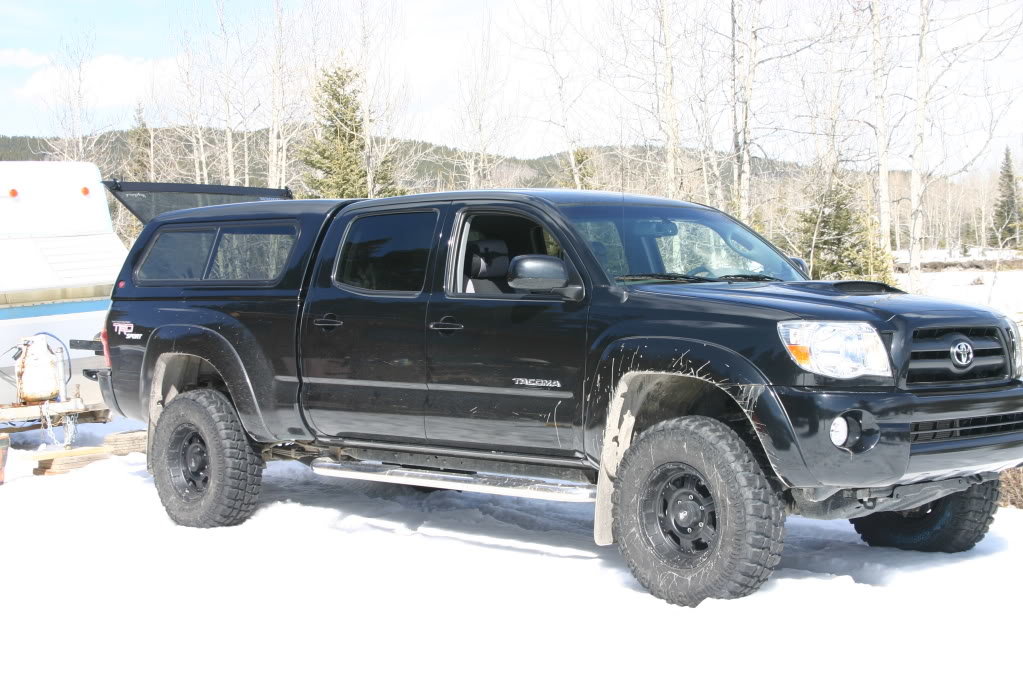

    This is my set up - it's another alternative to the TSB or AAL or block. It may not be as common, but it may or may not fit your needs.
    I also have a topper as well as a roll-out cargo bed and all my tools stuffed in the back of my truck. I was getting some very serious rear sagging so I added a set of airbags to help combat the sag.
    I have recently added Billy 5100's set at 2.5, and to level out the truck, I merely added a few more pounds of air in the rear bags.
    There are less expensive ways to gain lift in the rear, but in my case, hauling a heavy payload on a daily basis, airbags made the most sense. Plus when I pull my trailer, I can even add more air to the bags and maintain a level stance.
    I run a 265/75/16 tire - hope this helps. Oh, I should mention that I have the Canadian Taco, so these trucks have the extra leaf in the rear. I'm also going to try an AAL and see how the ride is.
