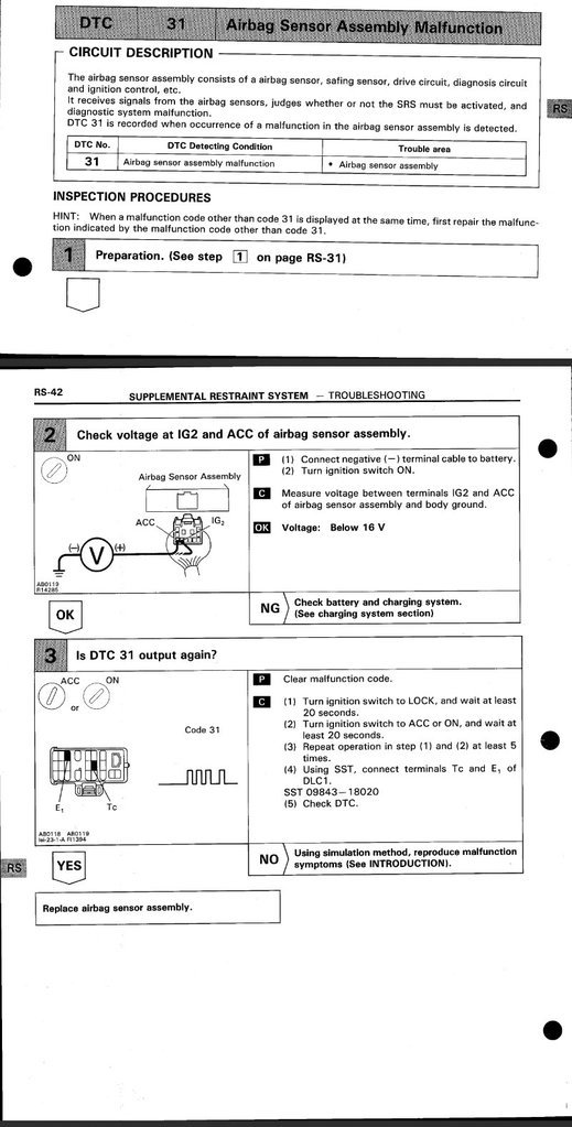

    Finally, the airbag light came on and I took it to the dealership. Left the engine running and the mechanic checked the code and it indicated #31. Made a stop at the store and upon restarting the engine the airbag light went out as normal. As I mentioned earlier, when the light comes on it stays on and when the light goes off it stays off. Just depends what mood it's in I guess. Where do I go from here?

    code 31 indicates a malfunction within the airbag sensor assembly, which is the airbag computer/ECU (electronic control unit). Would explains why it erratically lighs up and why it resets everytime the truck is turned off
    Was there any other code? sometimes another underlying problem can trigger a malfunction in the computer.
    Has the truck ever been involved in a crash?
    Also, how is your battery? A malfunctionning or dying battery can sometimes cause all sorts of weird problems
    Also, just curious, have you noticed if external temperature affects how the airbag light comes on or not?

    No, other codes came up and the truck has never been damaged. As far as the battery goes it's not new but has never given any problems starting etc. Being that the truck is out of service the whole winter I can't say what would happen when it's cold out. When I began using it this spring it did see days in the upper 40's but now it's in the 70's or 80's and seems to come on when I first start it up. Once it's warm and restarted it doesn't usually throw the code. I'll have to pay more attention to it and see if I can pick up on any kind of pattern. If the ECU is the little box under the ash tray on the hump behind a plastic cover, I was already there. I removed and reinstalled the yellow cable connector which I believe came down from the air bag just to see if there was a connection problem but that didn't correct it. Can the ECU be checked some how?

    Just to correct few things for this 96 truck as it looks like in equipment it is quite similar to my 95.5.
    It does not have pretensionners in seat belts. Seat belts are simple like in cars in 80-s.
    It does not have front crash sensor. The sensor is inside the ECU box (the box under the ash tray).
    I would be very, very careful when working with airbag connectors. If you do anything that might be related to the airbag circuit, disconnect the battery first and wait at least 30 seconds.
    I had similar symptoms in 92 Mercury Sable airbag. Light goes on after starting the engine that was sitting overnight. It was enough to stop the engine and restart it for the airbag to go to normal. I think these units are design to not turn off the airbag light once it is on even for a moment, till you disconnect the power (killing the ignition).
    For my airbag problem it was something related to capacitor inside the control unit that did not hold the charge (capacitor was used to provide the power to deploy the airbag even the battery exploded the crash). Nothing can be done except replacing airbag control unit. Ouch $$$.

    Yes, the ECU is the box under the ash tray, below and behind the plastic center piece of the dash, with the heater controls and radio. With a yellow connector with a yellow wire coming out of it. Here's the test procedure for it, scanned from the repair manual
    Very important to disconnect the battery before working on the airbag system and wait for a few minutes, to make sure all capacitors are empty. But in this case, you need to leave the battery on, as you can see, as you need to check voltage going to the ECU. The preparation step it reffers to at the beginning says to disconnect negative cable from the battery, remove steering wheel airbag (don't think you need to go this far, though), then pull out the ECU connector.
    Then, to clear the code, on step 3, you need a code reader again...
    Unfortunately, I don't think the ECU is something you can open up to change any part or piece of it. You'll have to change the ECU :(
    Try ebay or junkyards, because at the dealer it is going to be quite pricey $$$$.
    The part number for a 1996 airbag ECU would be: 89170-35010
    *EDIT*This part seems to be discontinued and not avalaible for purchase at dealerships

    Got back to checking my air bag issue. Truck sat for several days, so upon starting the air bag light came on. Shut off and restarted, light went off. Restarted, light back on. Shut off, restarted,light went off. This happened 4 times. Several days later upon starting the light came on and stayed on. I let engine run about 1 minute and then shut off. Each and every time I restarted the engine the light went off. I'm beginning to think that RysiuM may be correct in that a capacitor(s) may be at fault. I was always lead to believe that a capacitor was either good or bad, nothing in between, but given a short recharge time allows the unit to function normally but the capacitor must drain enough over time to cause the fault. Since I've owned the truck, it has sat for 8 months at a time without running or even a battery in it and it's never lost it's capacitor charge. I guess I'll be scouring the junk yards to see if I can locate a replacement ECU. Does anyone know what years or models would use the same ECU?

    By ECU you mean SRS Control module, right?. You probably need the one without dual airbags and belts tensioner - meaning old. 95, 96. By wiki "A passenger-side air bag was added in July 1997" so probably 97 and newer have different SRS control module.
