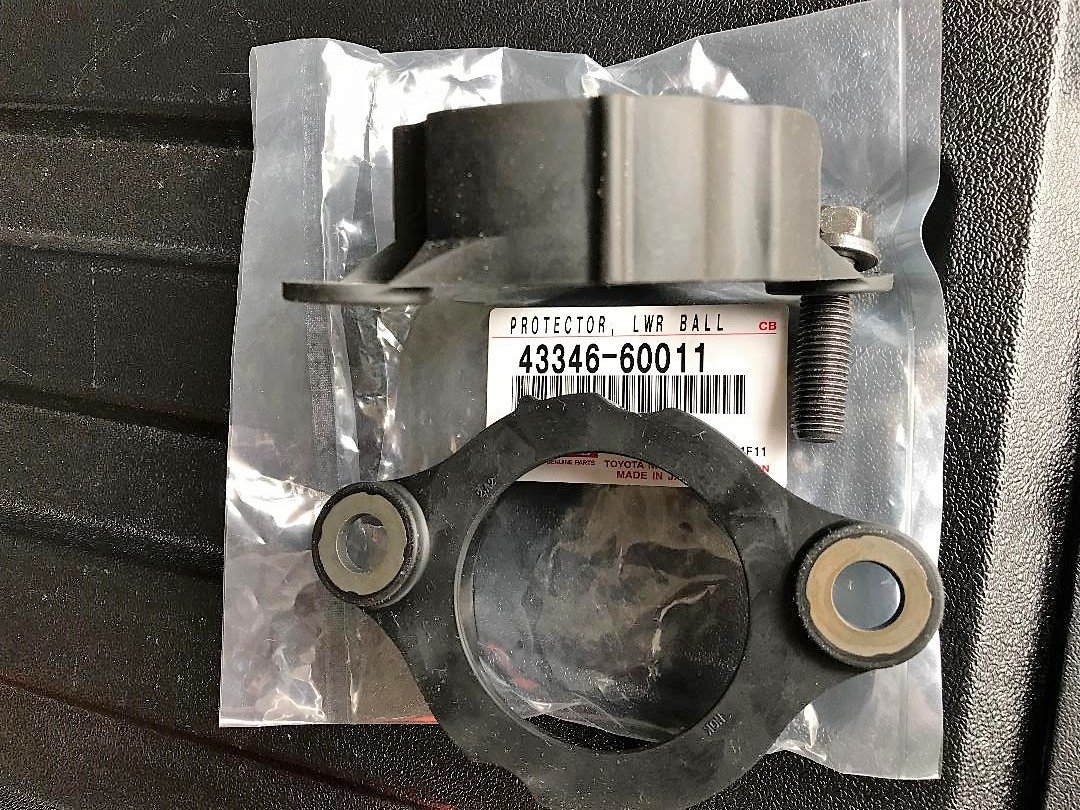

    In regard to using the longer OEM 90119-10933 black bolts, I measured the depth of the blind holes in both my '97 V6 Taco 4x4 OEM knuckles when retrofitting the 43346-60011 LBJ Protectors to my 01/97 Taco in 2021. The blind holes had depth to spare for using the black bolts with or without the LBJ Protectors. If you understand how the Protector attaches to the LBJ, it makes perfect sense. When attaching the LBJ Protector to the LBJ in either possible orientation, only one blind hole in the knuckle is used to attach it. The other blind hole in the knuckle must be capable of accommodating the full length of the black bolt without the extra width of the washer embedded in the Protector (shown below). So don't be afraid of using those black bolts. IMO, Leon's data proved them to be the best OEM LBJ bolt available when torqued to 37 ft./lbs.
    SpikerEng and Area51Runner like this.
