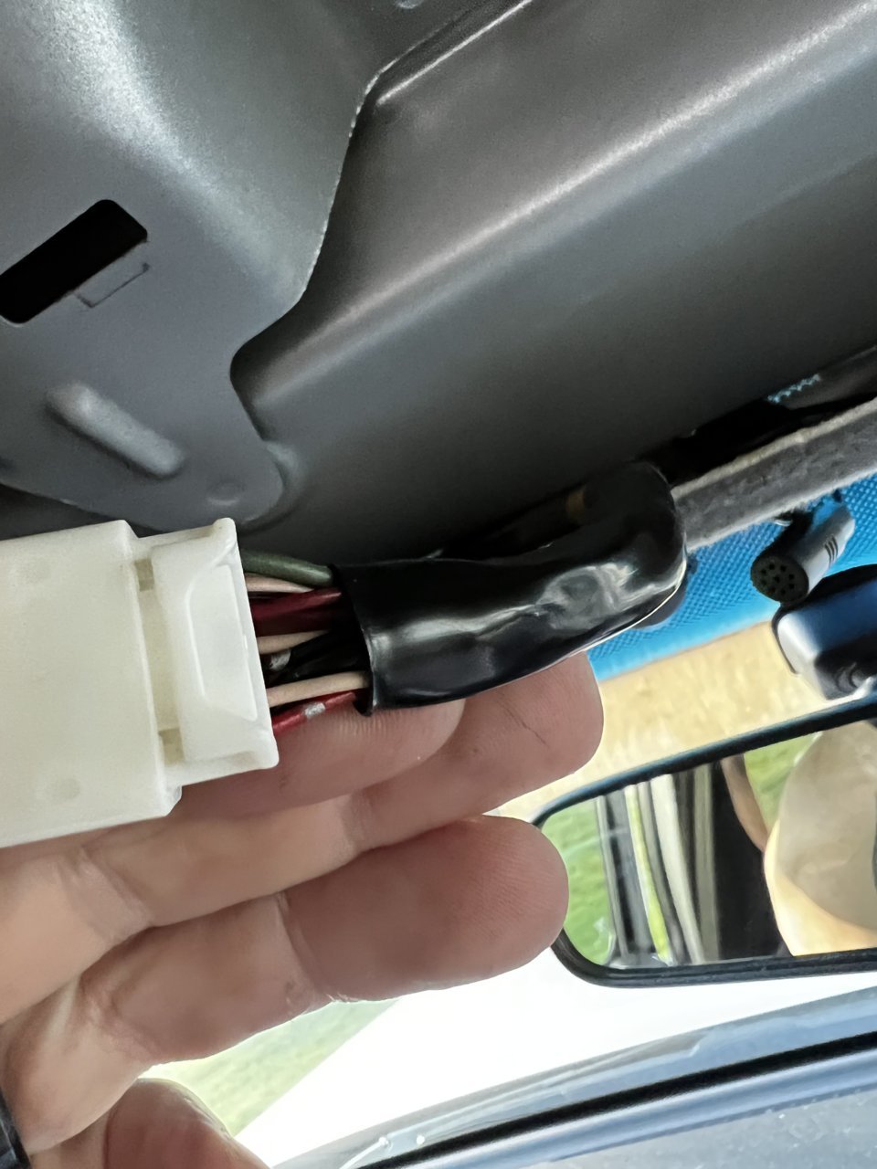

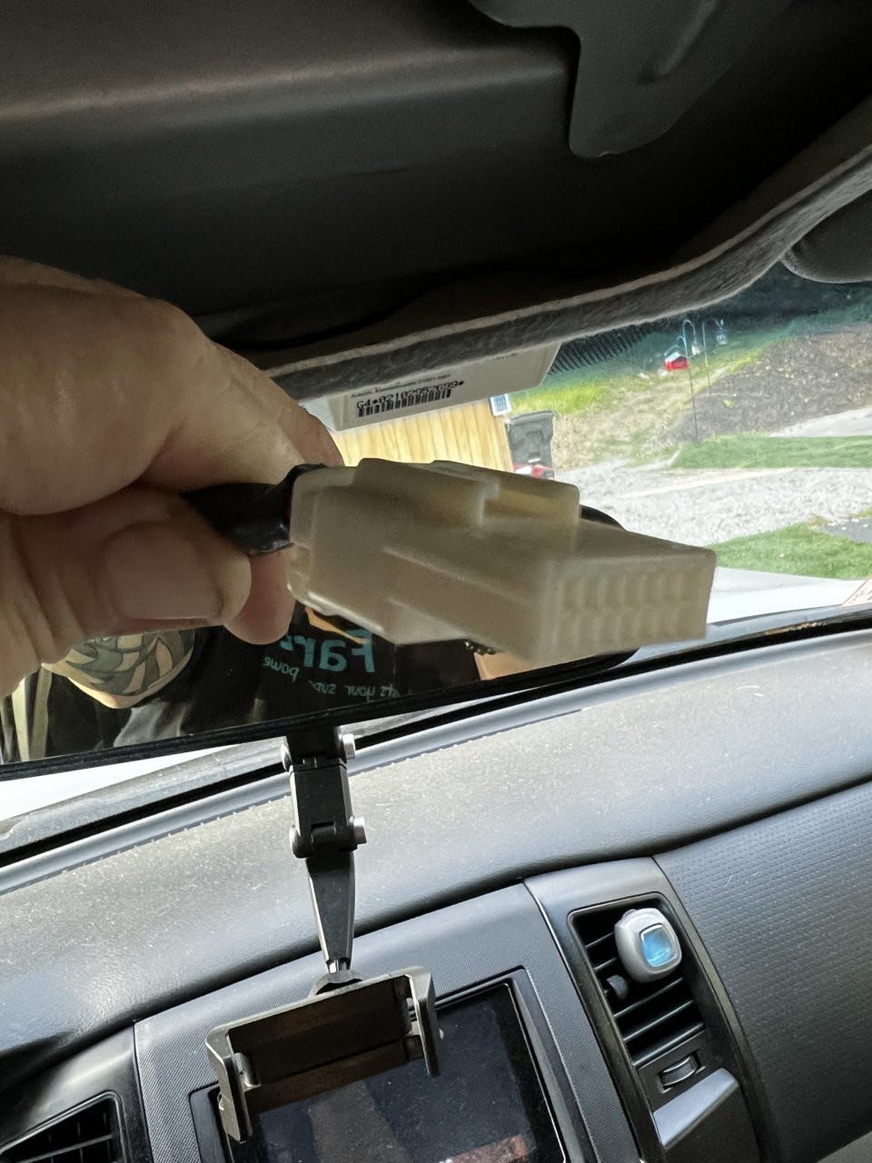

    Hey all,
    So yes we all know we have two plugs in upper roof console for lights and digital display “if you have it”
    And I found this one, have not seen this in any of my 2nd gens
    any Toyota grads out there. Lol

    looks like rear camera mirror plug

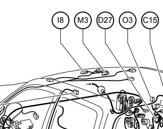

    Looks like going to I8:
