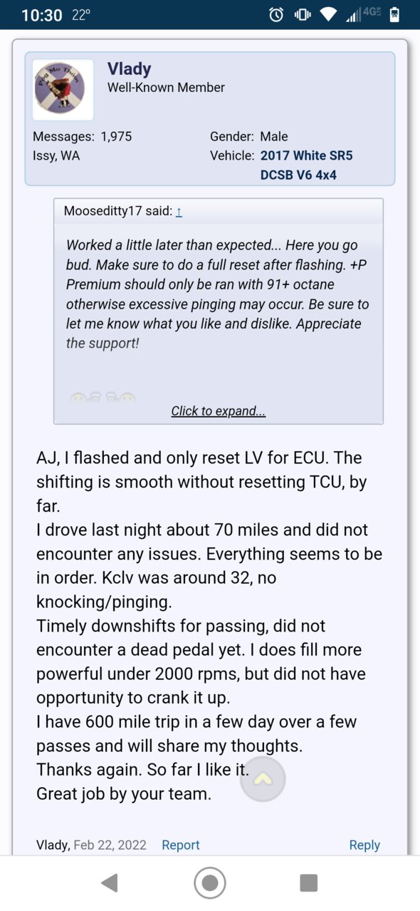

    I spent a lot of money on your guys "tune".
    Amateurs..

    I'm sorry you feel that way, but your log file only samples, on average, once every 3 seconds.
    Compared to vF, which is about 7 samples per second, you gave us about 1/21th of the data. Then you respond with a "yep" and call us "amateurs" because you expect us to fill in the blanks?
    Would you like assistance on how to reconfigure fusion to sample faster? I'd be glad to lend you a hand, as I have done so myself and helped others in the past. Otherwise, if you already know how then I won't waste your time, but we would appreciate for you to make those changes and provide those logs as well.
    Also, the edits contained within this tune work best by resetting/clearing ECU and TCU. I don't believe you did that for the TCU which could contribute to issues you were having. I've seen issues where slip lock (or other TC changes) don't take effect, higher TC temps, higher transmission temps, etc from people not performing the resets. And I'm sure you have too. I know it sucks having to perform the learning process over again, but it's a necessary evil. Please do that before providing further logs as well.
    Have a great weekend Vlad, and stay in touch.

    What about other issues that came up on my trip? Are you planning to fix them?
    Dead pedal is small inconvenience compare to other 2 I observed.

    Yes, I will comb through your logs.
    If you have not performed a full ECU & TCU I highly encourage you to do so now. It is required for this tune.

    What do you want addressed? Nothing is wrong with the file. You're "seeing a high amount of Misfires". I've already explained that what you are seeing is WELL within Toyota's specified range. Not to mention, I have yet to see anyone repeat what you're seeing. The TC temperature in the low 200s is again 100% acceptable. Transmission temp needs to stay at or below 200* not Torque Converter. If you would like to pay more for a custom tune that can be accommodated.
