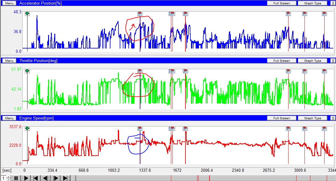

    Did you save as csv, and send the log to anyone?

    Alrighty, yep I see it. If you could shoot this over to us in .csv format like @ktbell444 mentioned we'll be on it like flannel on a Midwesterner.

    My truck is over GVWR as it sits. During testing I was the guinea pig and gauge for how the overall transmission responds in an unlocked state, on a weighted truck, during "spirited" driving, and through moderate terrain. We managed to find that having it lock more, and at the appropriate times is ideal for the health of the transmission. Keeping the TC close to or below 210⁰ proved to keep the primary transmission cooler. Pinning the solenoid will result in even lower temps, as expected. I did this during testing for affect. Certainly helps in warmer ambient temps, but also causes transmission to be a little slow to rise to nominal. I highly doubt anyone has put as much love into the TC function as @Mooseditty17. That's his baby.
