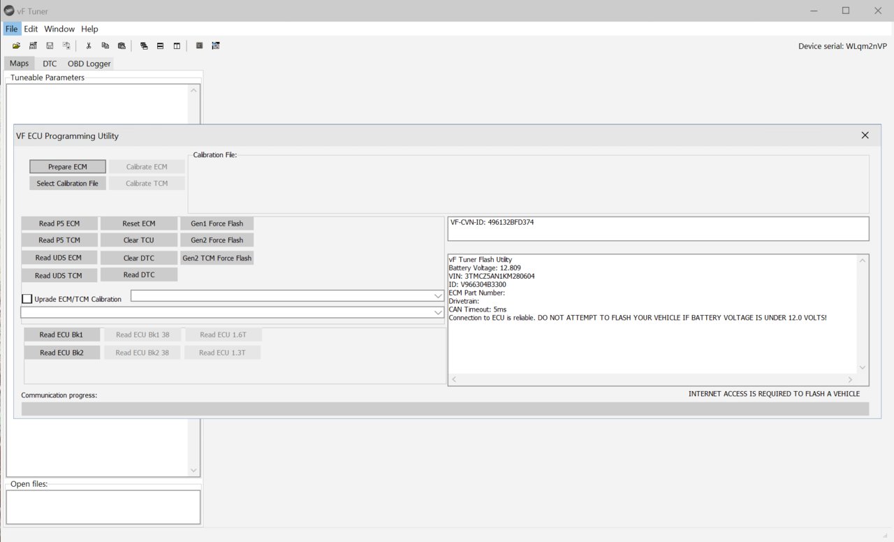

    Offhand, sounds like you're trying to open the file in VFTuner itself, instead of the flash utility launched from within VFTuner (made that mistake once before when I hadn't flashed my truck in a while and forgot).

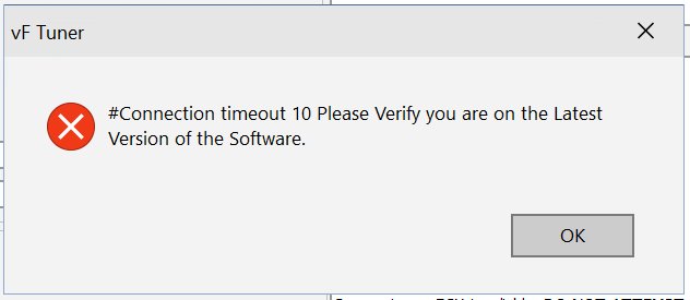

    It has been awhile and I'm a bit rusty here... What version of VFTuner are you running? I'm wondering if I need to update.
    This is where I perform the flash correct? The 'prepare ecm' looks like it works, but then after a few seconds I get this message saying it timed out and to be on the latest version of the software.

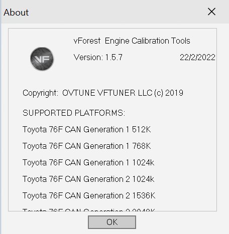

    Are you on VERSION 1.6.5.61122?

    This is what I'm on. I'll try and update it.

    Yup that’s the problem

    Thanks man! I think that may have done the trick. Gonna try the flash here in a few min
