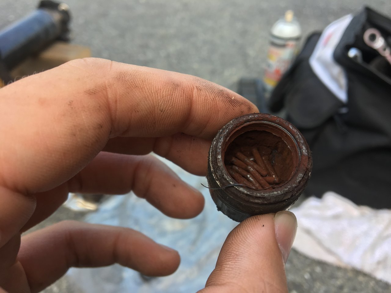

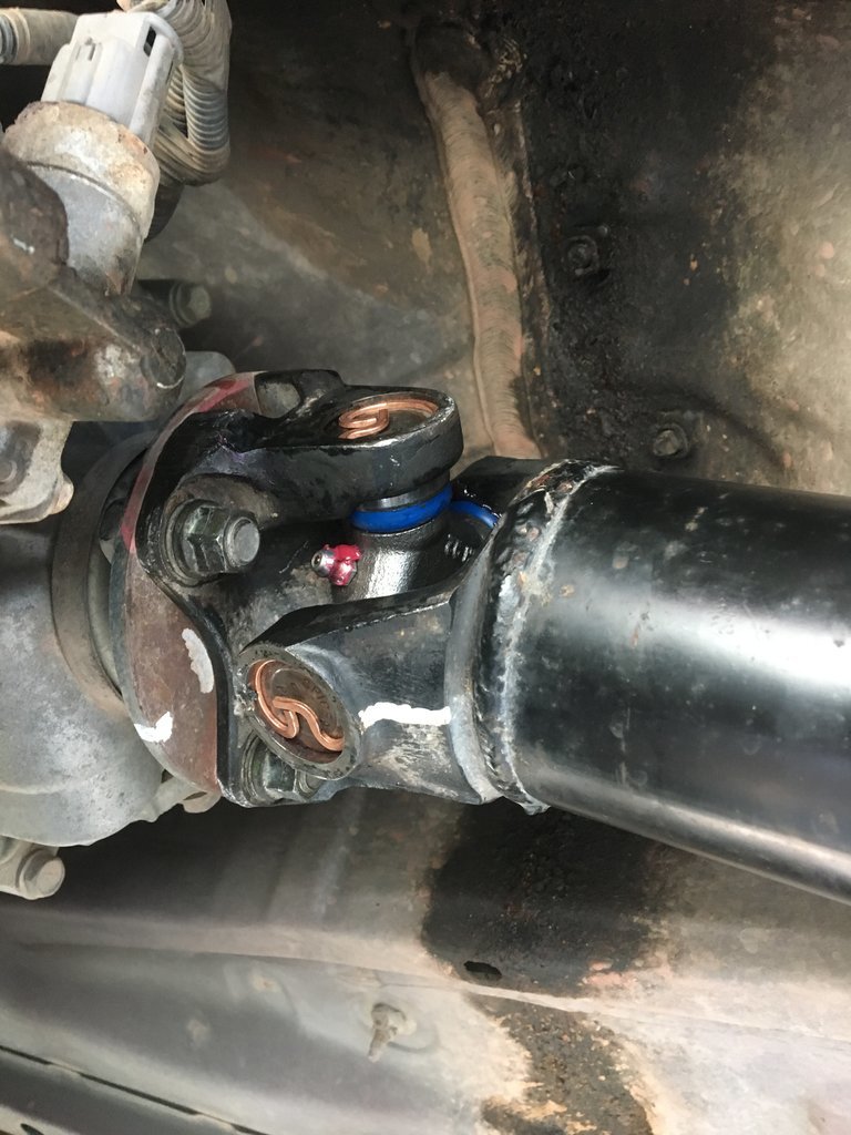

    Thanks to @MY50cal and @loosnut i have a squeak free driveline with new spicer U joints and IDELS carrier bearing! Still playing with angles to get ride of the new vibe, but not too worried!
    Best part is a learned a lot while replacing these!
    Some pics of today
    Toasted
    New goodness

    Haha I might be a noob mechanic level one day! Honestly I just appreciate all the help, and every time I get to learn something new!
    Also I flipped the CB and have 2" spacers and the vibes are almost gone :)

    Small Updates:
    Almost got my drive lines perfect with the IEDLS carrier bearing - https://www.tacomaworld.com/threads...uy-iedls-polyurethane-carrier-bearing.421410/
    Set it up similar to @HolyHandGrenade's post - https://www.tacomaworld.com/threads...-carrier-bearing.421410/page-51#post-12642990
    Combination of 1" square tubing and the OME drop kit and 3 washers
    Today I ordered new OME 90021 shocks, since I needed new ones (didn't feel like replacing the bushing) and the trim packer.
    Lastly, have new brake shoes for the rear, and once the shocks arrive i'm just getting my local shop to install / replace everything so that I can have it worked on while at work and be done with it haha.
