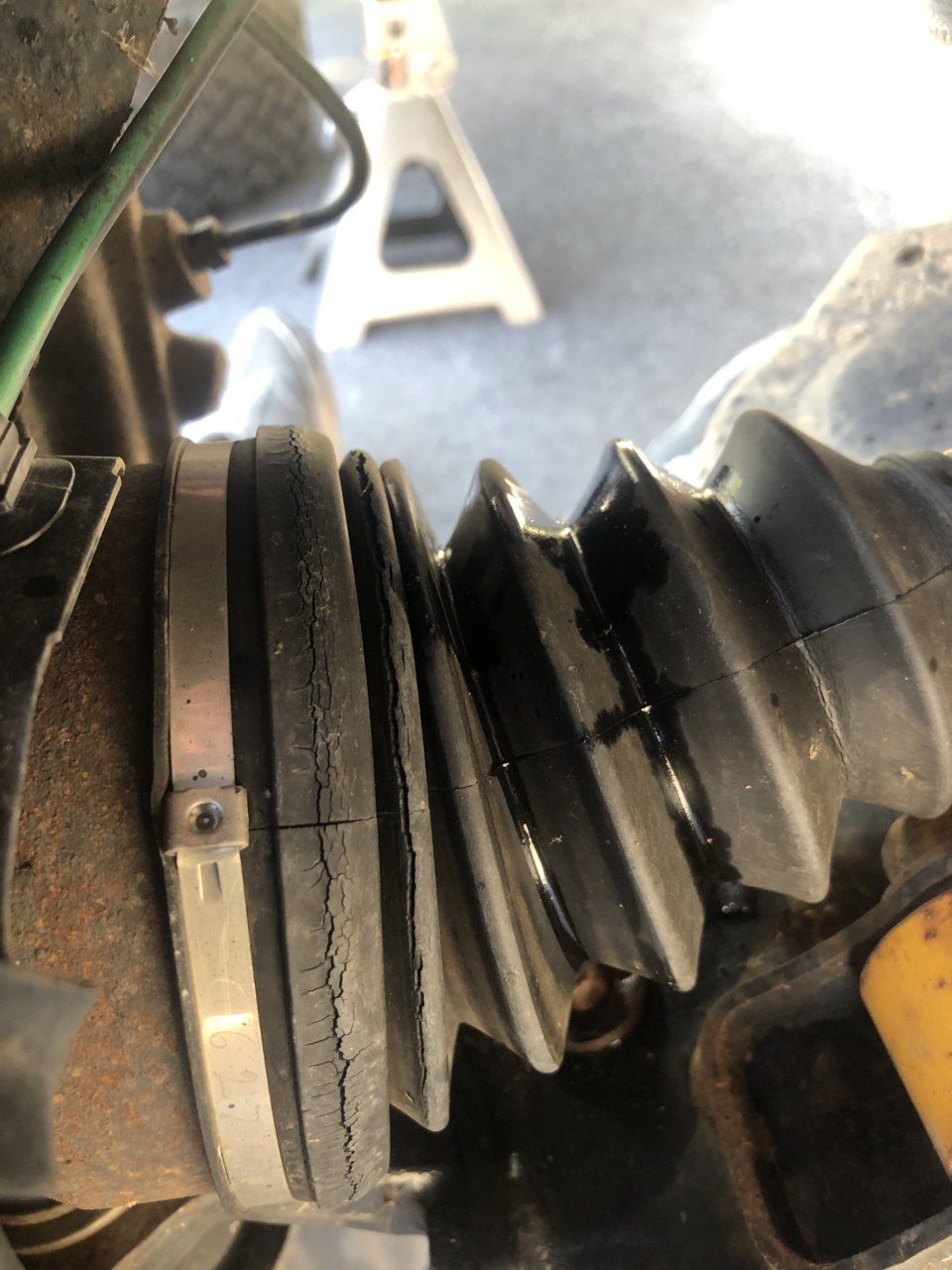

    Also, this is my passenger side CVJ axle.
    Less than 2 years old lol, stay away from neoprene boots my other one is already torn. I don’t even know how they were ever an option haha (the liquid is water from wiping down the UCA)

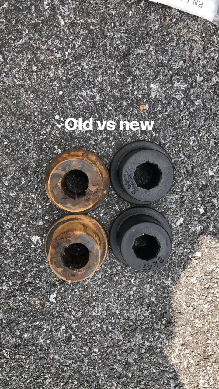

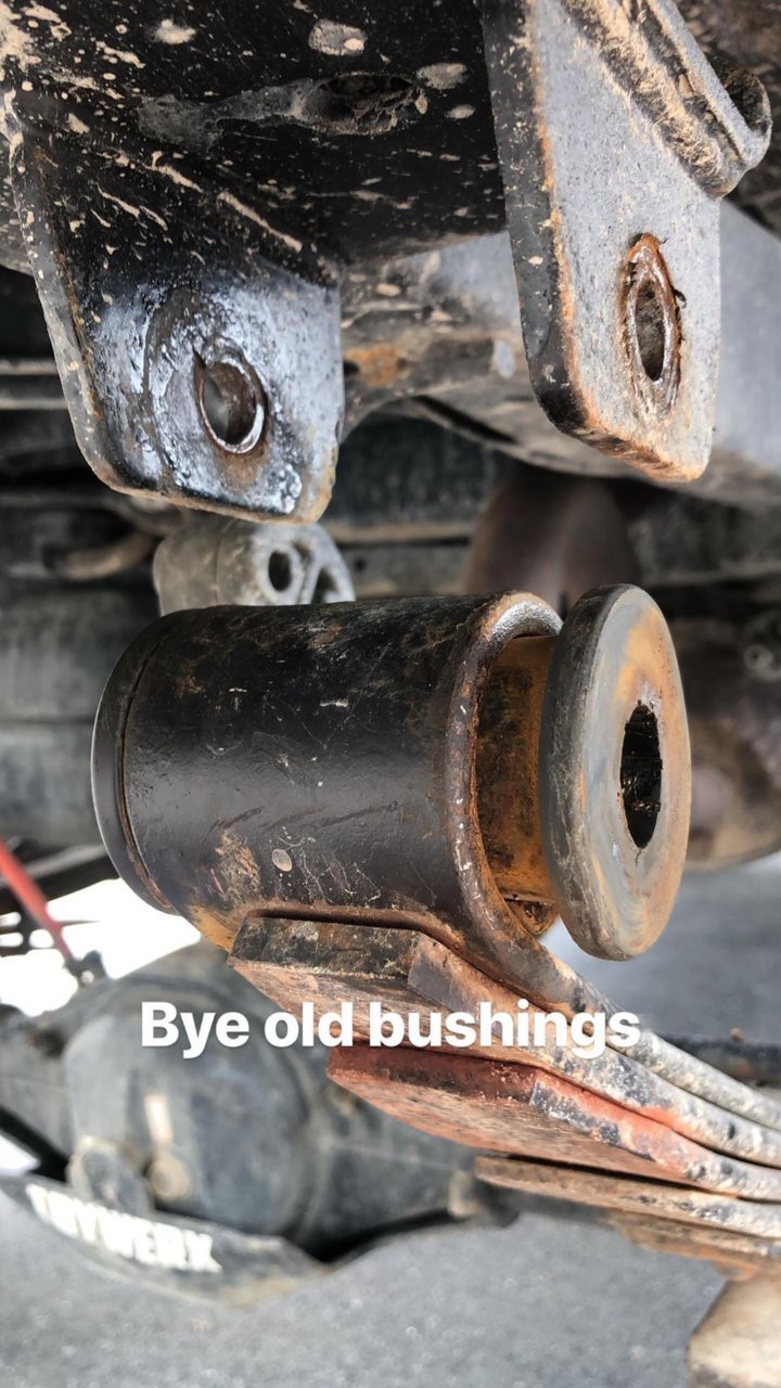

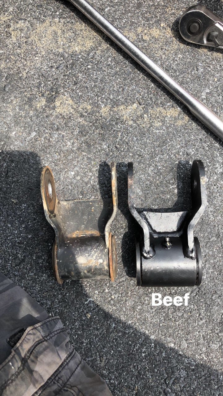

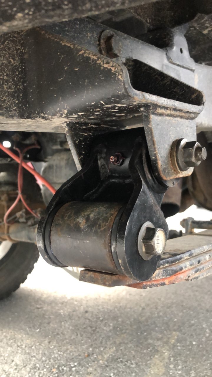

    More little mods/ maintenance done today!
    4X HD shackles and new rear bushings in the dakars
    After a little drive the rear squeaks less, and judging by my jacked bushings, this was overdue
    Driver’s side
    Stock shackle vs HD shackle
    Finished with all the weight back on!

    What bushings did you end up using the spring end?

    These! I bought them brand new from a dude on here @SummitBound I think

    Glad they are working out man! My squeak was between the leafs, so I ended up just putting in leaf liners to quiet them. I’ll do the bushings in a few years though
    Enjoy!

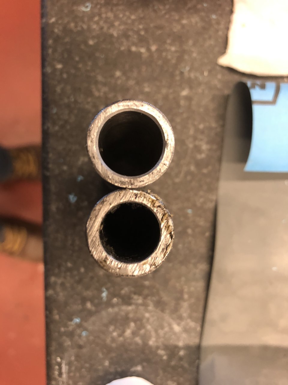

    Forgot to mention how I got the bushings from the 4x HD shackle to fit.
    I had my friend ream the sleeve out a few thou to allow the stock hardware to clearance.
    I finally got a reply email yesterday from Adam at 4X saying their kits ship with grade 8 hardware.
    Oh well, i prefer to use stock hardware for this application anyways. And I have spare wheelers bushings I can insert if I need to.

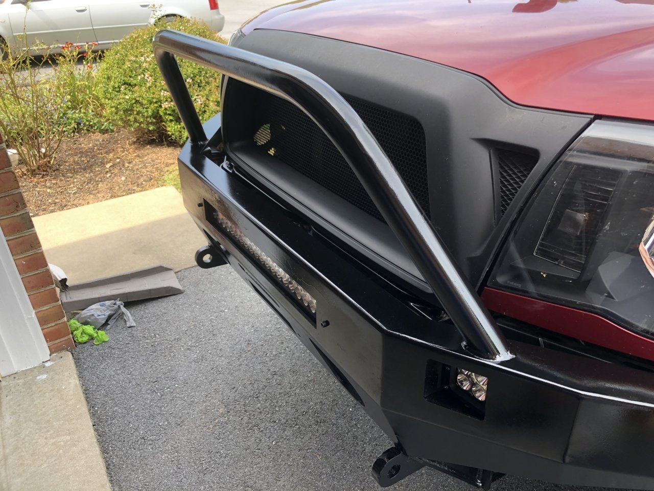

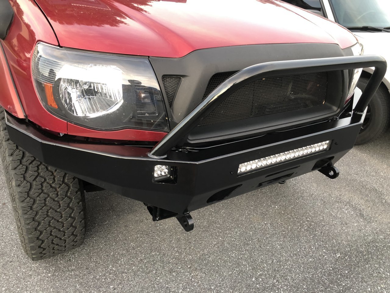

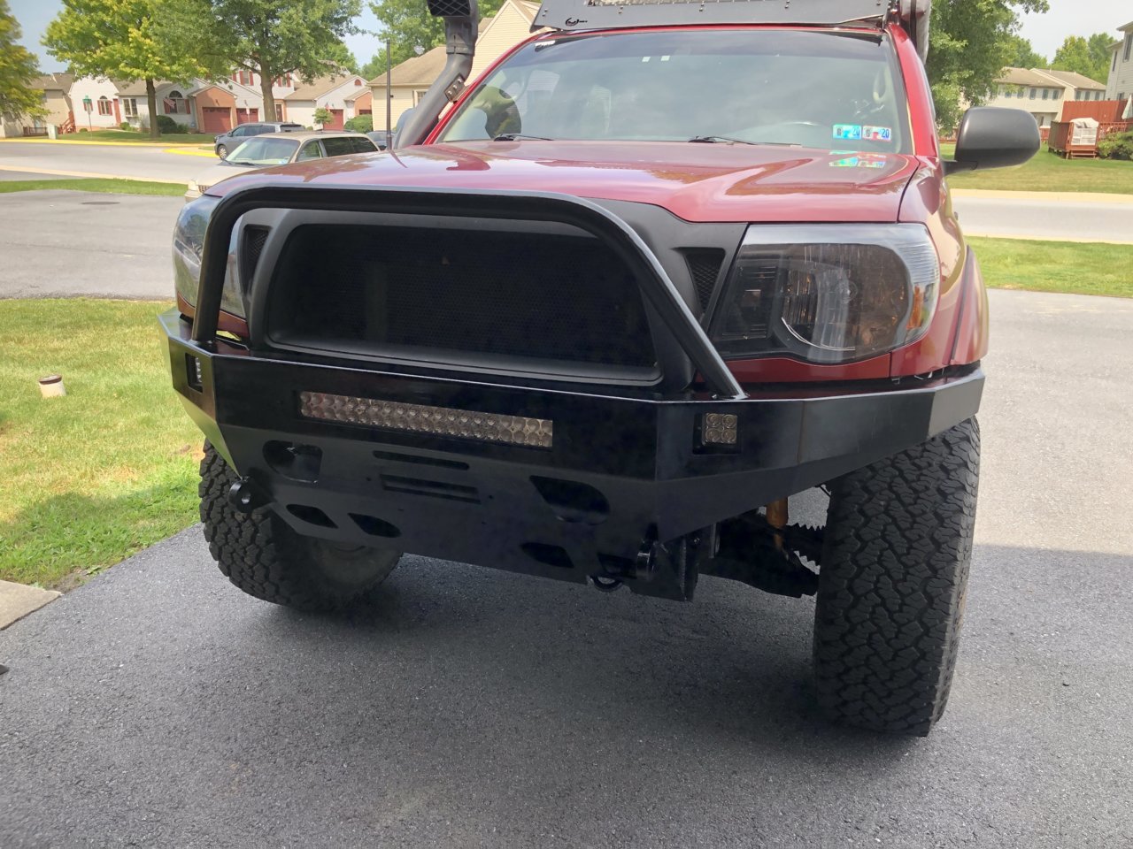

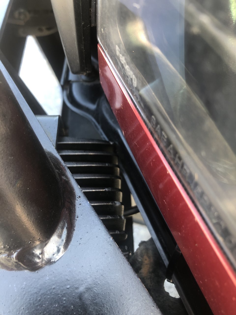

    Went ahead and adjusted my front bumper and repainted it as well.
    It somehow moved to the point that the fog lights were hitting the core supports under the headlights!
    There are a few washers spacing out the bottom to angle the bumper so it doesn’t hit my fenders, but it wasn’t this angled when I left @Mobtown Offroad
    Adjusted and painted!

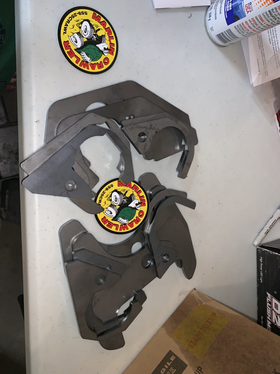

    List of stuff to do on truck:
    • Drop all skids and flatten/ paint
    • get a nut welded in where cross member nut broke
    • Modify T Case Skid to be flat
    • Re-Route exhaust
    • ECGS Needle Bearing Bushing Replacement
    • CVJ Axles (went to buy, but their website was down)
    • Get latest purchased parts installed :)
    Couldn't get my caster higher than around 2.2 because the tabs were bending (according to tech)
    So I FINALLY bought these:
    geekhouse23 likes this.
