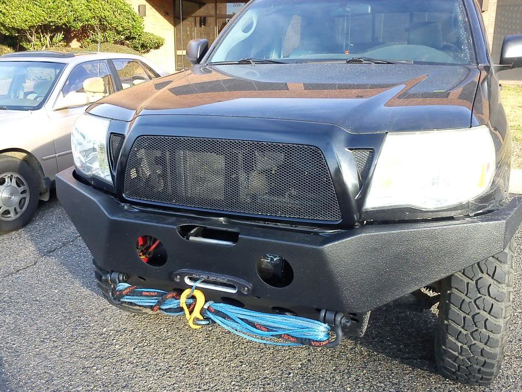

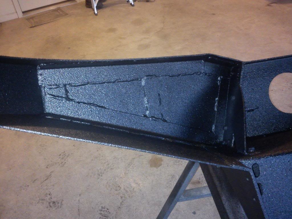

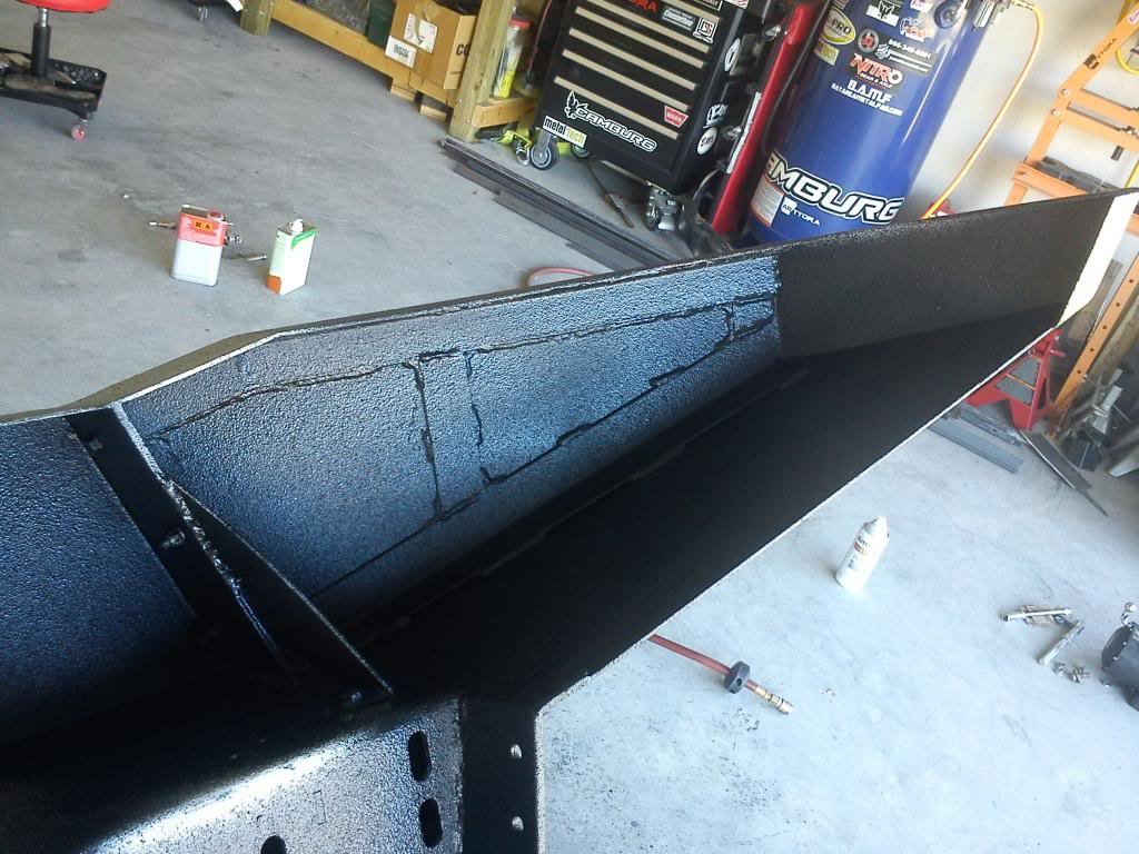

    So, I got the All Pro bumper welded up and sprayed with Raptor. It turned out pretty good I think. I forgot to take pics while I was welding it, but you get the idea. Hopefully this will add a little extra strength.

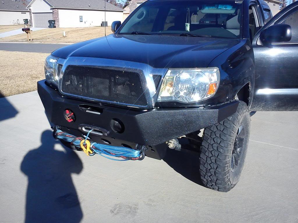

    Finally got around to color matching the chrome around my grille. Been meaning to do this for a couple years now lol. It's not perfect, but it turned out better than I expected, as I don't have much patience with tedious painting and what not.

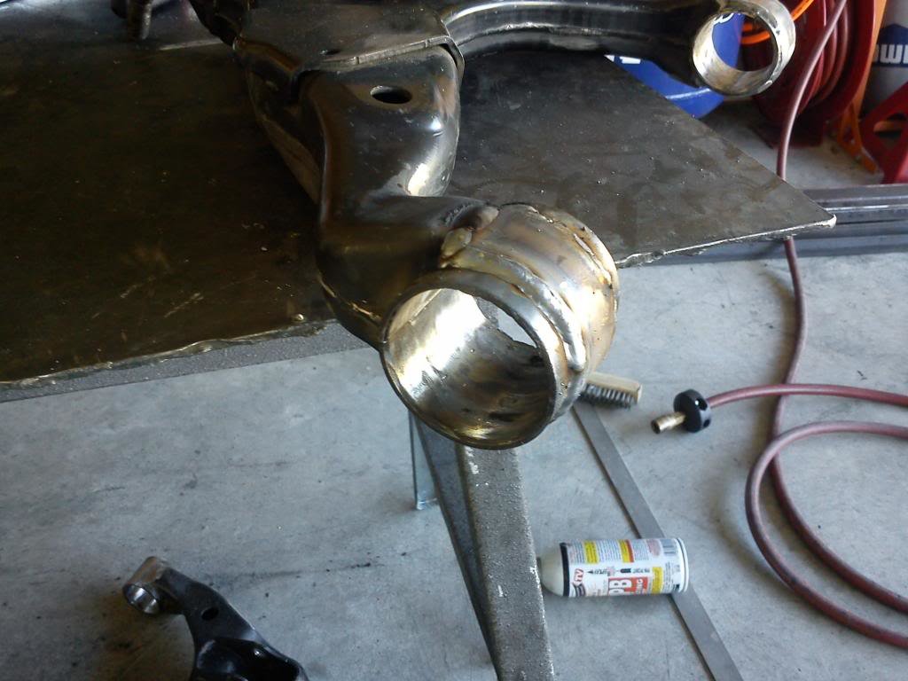

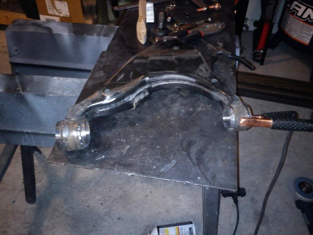

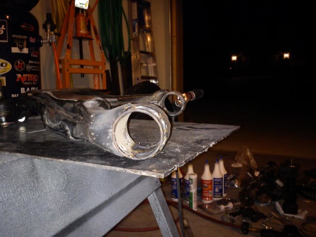

    Got a little work done this weekend. Picked up an extra set of LCAs a while back and wrapped the bushing mounts with some 1/8" plate this weekend. Not the prettiest welds in the world, but it turned out okay.

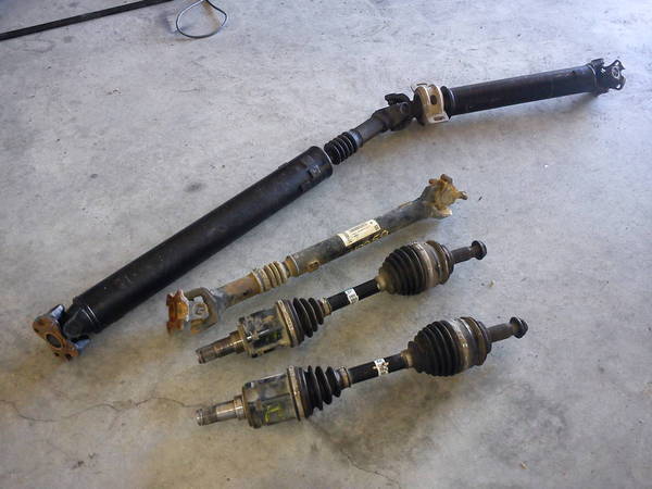

    Picked up a few more spares last weekend from a friend that runs a salvage yard.

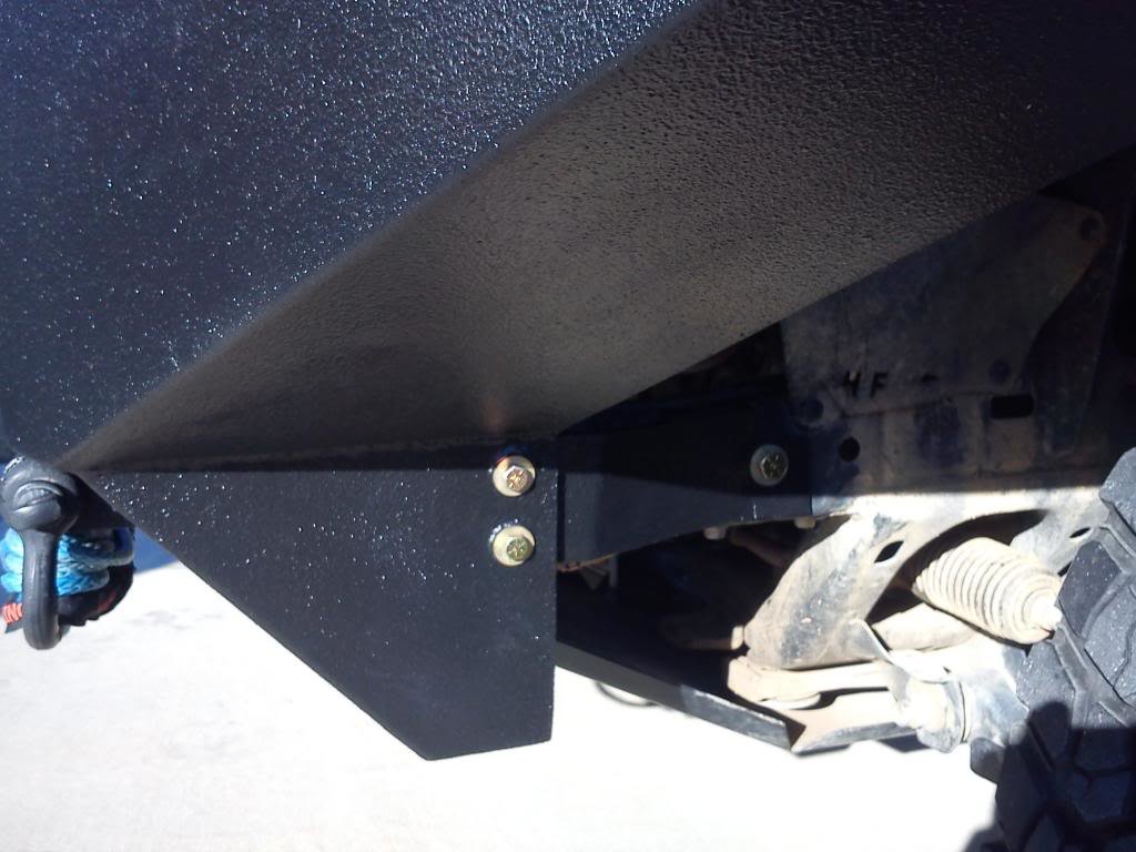

    Front or rear bumper? I love my rear bumper, and I like the front now since I've welded and reinforced it. But, if I had it to do over again I would probably go a different route. The bolt together design is just not strong enough, and the wings being 1/8" makes it worse. Of course, that all depends on what you are using it for I guess.

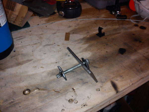

    It actually isn't on the truck yet. It's in my 4.56 open diff which won't be installed for another two or three weeks. I don't anticipate any issues though. It doesn't appear that anyone is having any issues. Also, a friend of mine that I would consider a bit of an expert in the field tells me that a bronze impregnated bushing should last the life of the vehicle no problem.
    I can say though, don't waste your money on the tool. I made my own from some scrap, and it worked just fine.
    I just used a 5/16" bolt (1/2" head) about 3" or so long. Used a piece of 1/4" plate with a hole drilled in it and a washer on top. Then I cut and grinded a piece of 1/8" plate until it fit (if i did this again, I would go with a little bigger plate as the 1/8" bent a little). I just placed it on the outside of the bushing and kept cutting/grinding until the plate was slightly smaller and rounded off on the edges to match the bushing. Then I drilled a hole in the center of it and welded a wing nut to it (you could possibly use a lock washer or JB weld or something if you don't have a welder). I am not knocking ECGS, as they are a great company to deal with, and the bushing is a top knotch product, but their tool being precision machined and all that jazz is just not necessary.

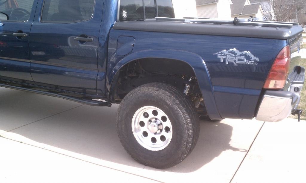

    Here's some inspiration for cutting the fenders :)
    I still need to do the front.
