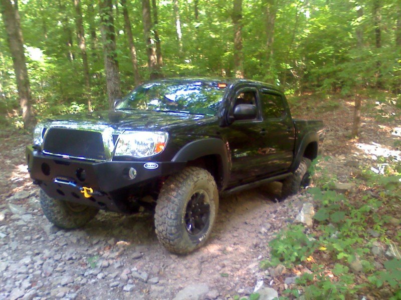

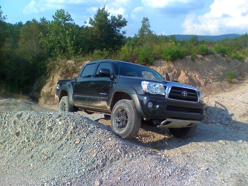

    So I'm finally getting around to doing one of these. I recently lost most of my pictures, so I'm going to post what I've got and attempt to remember what I've done to it..
    Here's pretty much how it sits now:
    Truck
    2008 Tacoma 4dr TRD Rugged Trail Package
    4.0L v6- Auto trans
    Armor
    All Pro IFS skid
    All Pro Trans skid
    All Pro Transfer Case skid (with the pan for the exhaust cut out and welded flat)
    Shrockworks Sliders
    All Pro 4-piece Front bumper (fully welded and reinforced with angle, frame tie-ins, sprayed with Raptor)
    CBI High clearance rear bumper
    BAMF Rear diff skid
    BAMF LCA Skids
    Front Suspension/drivetrain
    Radflo C/Os w/ 700lb coils
    Camburg 1.25" uniball UCAs
    Cab mount chop
    Wrapped LCA bushing mounts & Moog greasable ball joints
    Total Chaos cam tab gussets- welded & installed
    Wheelers super bumps
    Total Chaos Spindle Gussets
    Solo Motorsports UCA double shear gussets
    Stainless brakelines
    Brembo blanks
    Hawk LTS pads
    Extended studs
    ARB Air Locker
    4.56 Nitro Gears
    Rear Suspension/drivetrain
    All Pro 3" Lift springs
    All Pro U-bolt flip
    ATO Shackle Flip
    ATO HD Shackles
    Timbren bumpstops
    BAMF Shock Towers
    Radflo 12" 2.0s
    AC Delco shoes
    Extended studs
    4.56 gears w/ e-locker
    Frame boxed, gusseted, and seems fully welded
    Wheels/Tires
    SCS Stealth 6 17"x8.5" wheels w/ 305/70/17 MTR Kevlars(current)
    BORA 1" wheel spacers
    stock Rugged Trail black wheels w/ 255/85/16 KM2s (old)
    Recovery Gear
    Smitty XRC8 w/ Viking Synthetic
    Hi-Lift mounted in bed
    ARB snatch block
    Viking 50' line extension
    Bulldog 10' tree strap & 30' extension strap
    Several other cheap tow straps
    OBA w/ Puma compressor, Viair tank.
    Random Crap
    Grillcraft grille (with surround color matched)
    Diff Lock anytime mod
    ABS off switch
    Exhaust re-routed
    Midland 75-822 Handheld CB hooked up to 3' Firestik
    Clearanced fenders/flares (2.5" cut out)
    Salex glovebox & console organizers
    Relentless tailgate reinforcement
    Custom bed rack
    Tire rack 2.0 (Swing up for easier bed access)
    BAMF light bar with Iron Man 6" LEDs
    Spares
    CV shafts- OEM (3)
    CV inner joints (2)
    Tie Rods (2)
    Outer tie rod ends (2)
    U-joints (3)
    Front hub with bearing pressed in ("tool" for pressing bearing off)
    Front driveshaft
    Rear driveshaft
    Both rear axles
    Both spindles
    Both LCAs w/ full set of cams/bolts
    Wheel studs/lug nuts
    T-case Actuator
    Steering Rack
    Wish List for Later
    Add tubing to front bumper
    Add kickouts to sliders
    Add tube protection on rear bumper

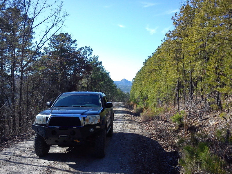

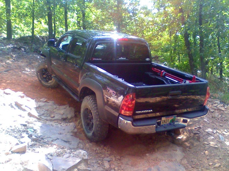

    A few more recent pics:

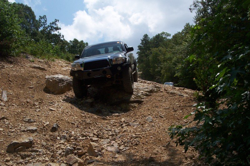

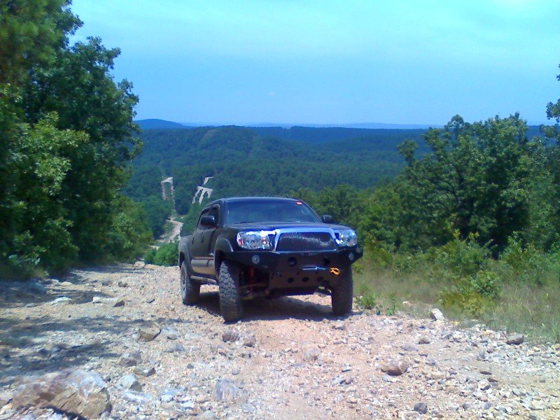

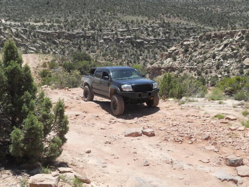

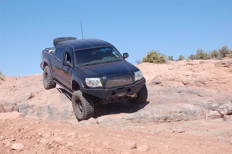

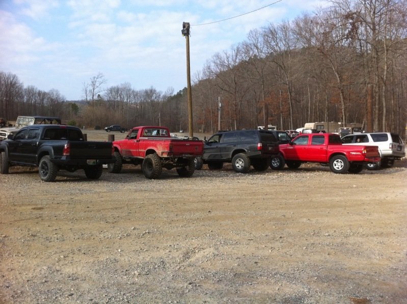

    Found some pics from TTORA Takeover '09.
  4. Nov 5, 2012 at 4:22 PM
    RockyMtnTRD
    RockyMtnTRD Wanderlust.
    May 4, 2011
    #56088
    6,557
    Noah
    Colorado
    '11 TRD OR
    hack job
    Looking good man!! Looks like you are hung up bad in that last pic?

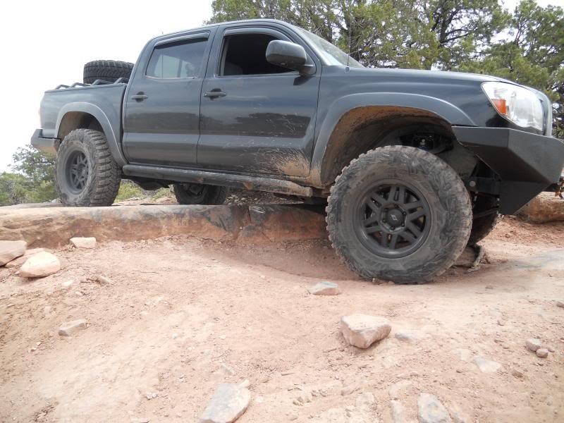

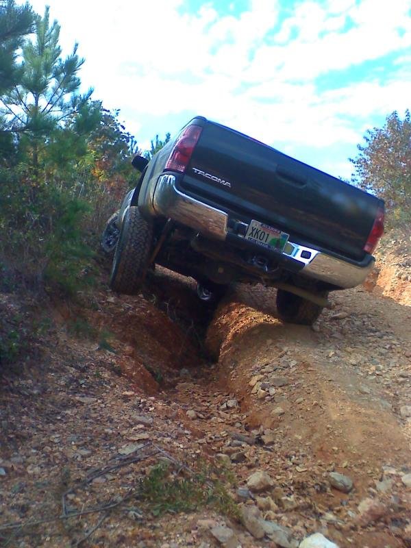

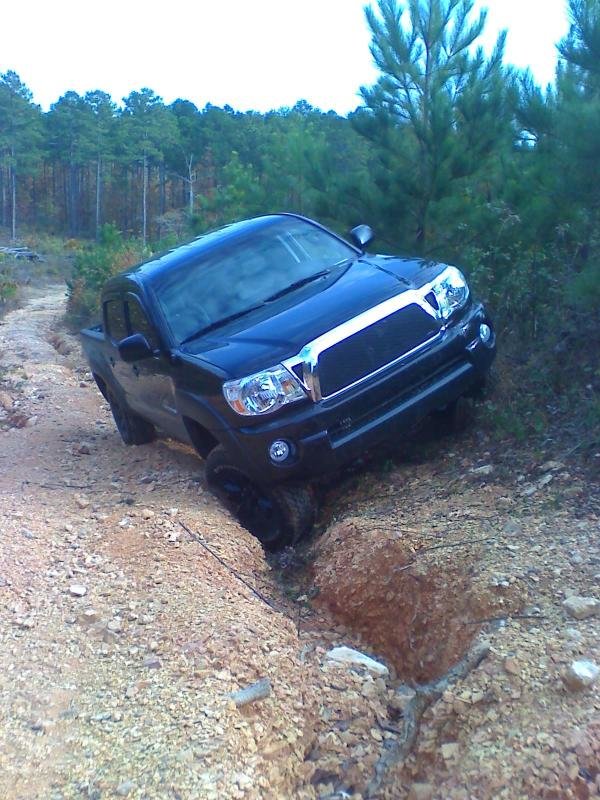

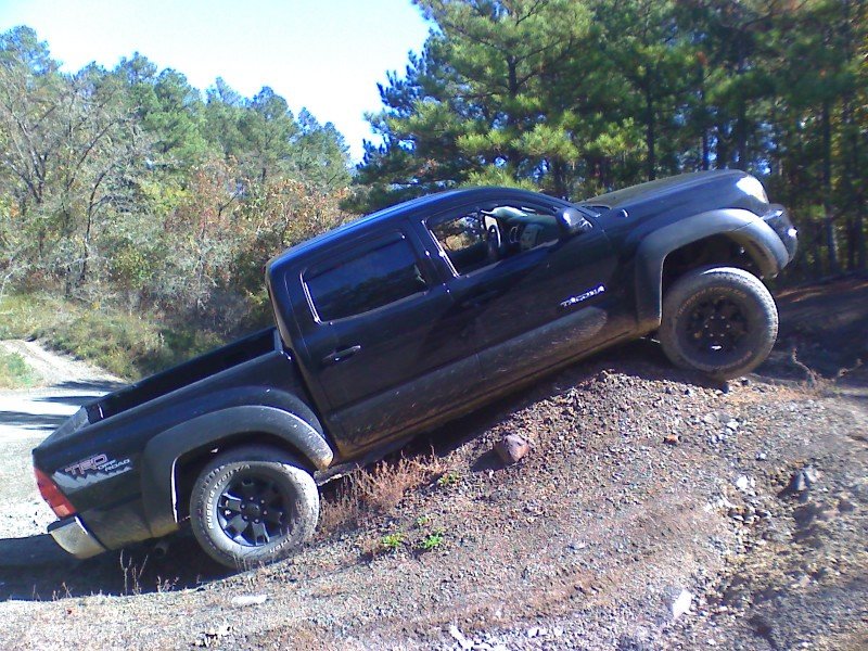

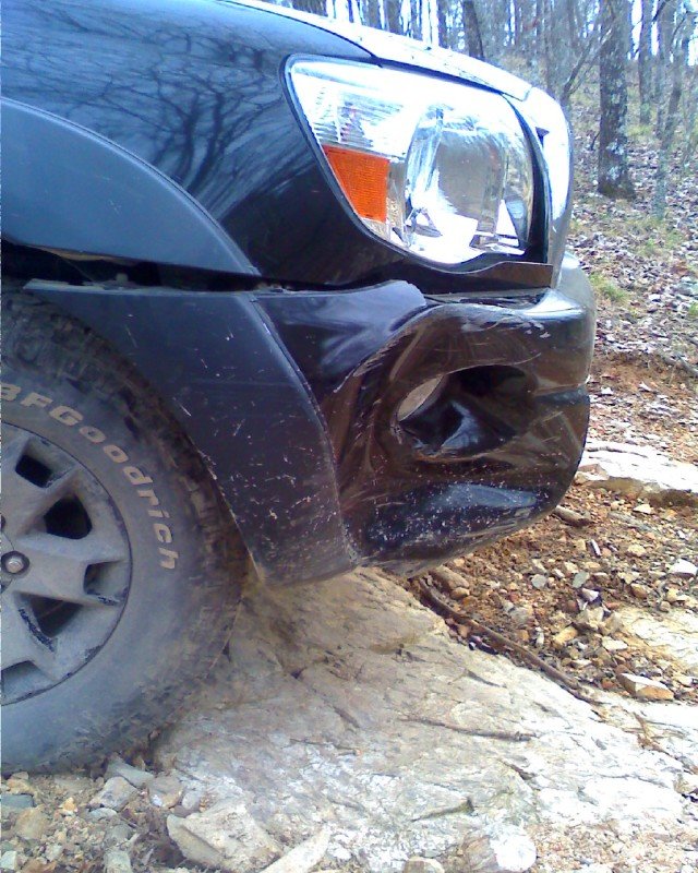

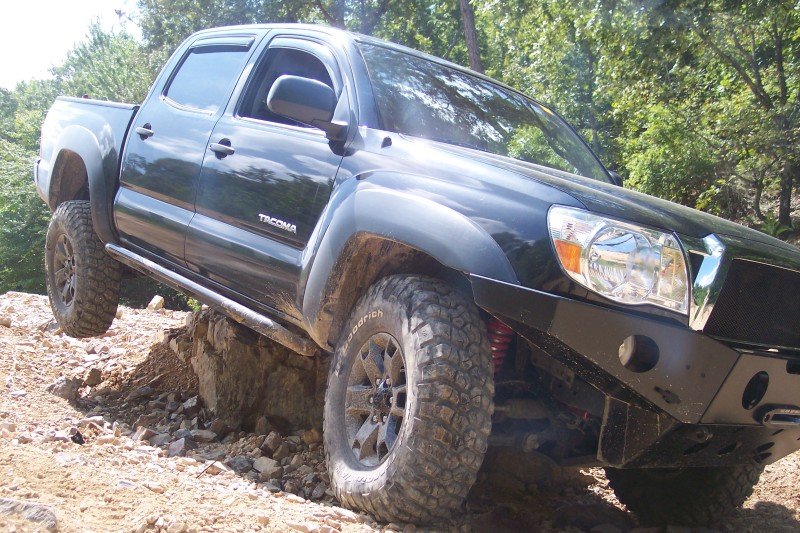

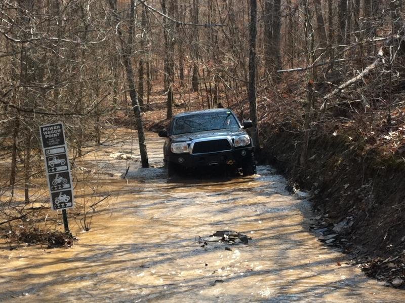

    Some random wheeling/posing pics.

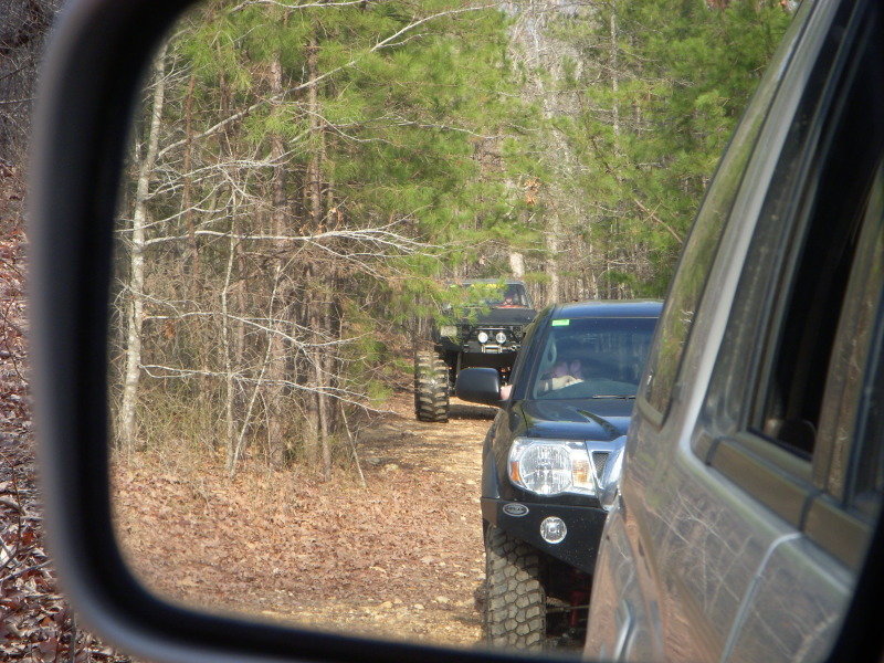

    From the base of Forked Mountain (one of my favorite places)
    Just a man, his machine, and the woods
    From a couple weekends ago.

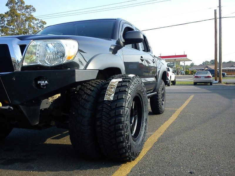

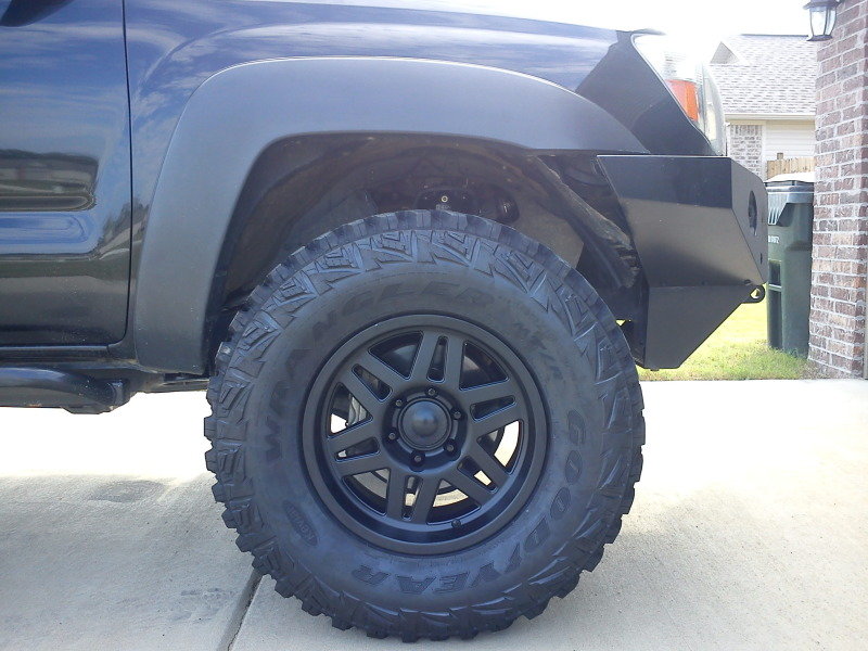

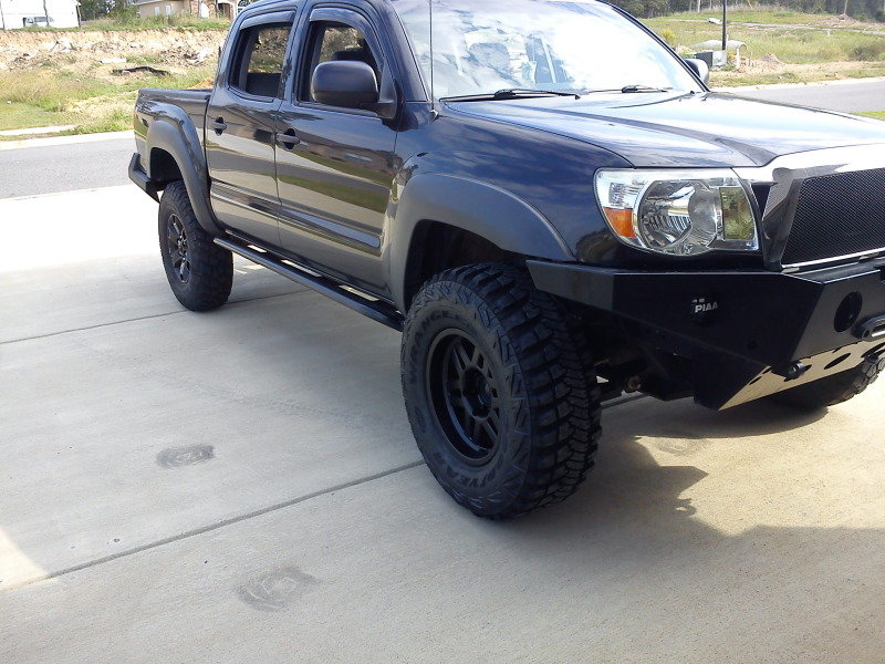

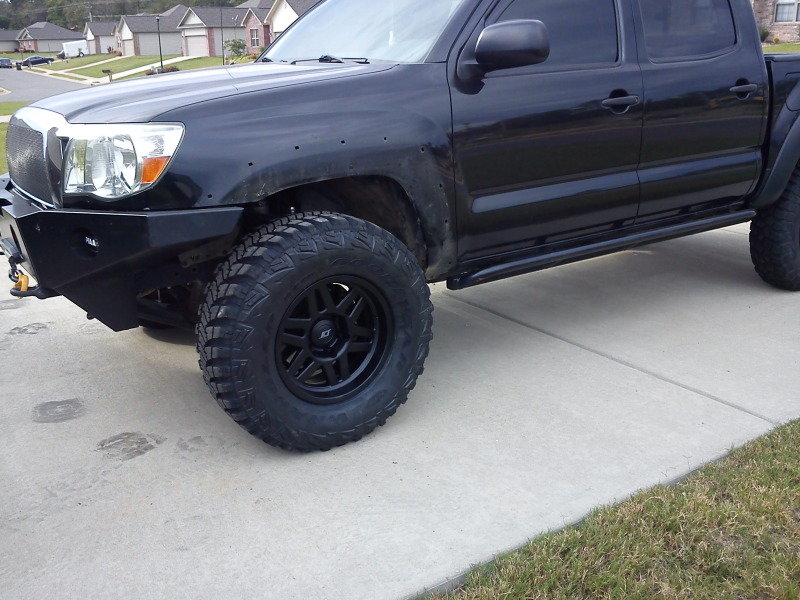

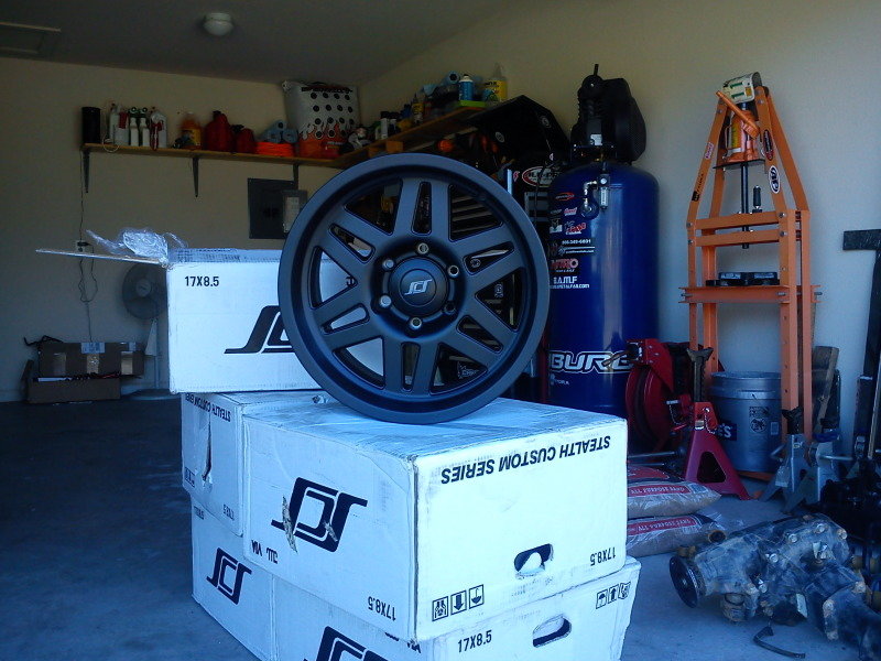

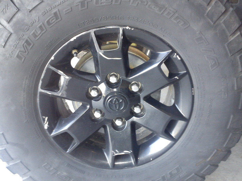

    I ordered a set of 5 SCS wheels during the group buy.
    I'm hoping that since the center design of the wheel is set back a little that I can keep from gouging them up as bad as my stock wheels.
    So I got one of them wrapped in a 305/70/17 MTR (34.2 x 12.2) for fitment purposes. Plus, I can only afford to buy one at a time lol. Maybe within a couple years I'll have a full set.

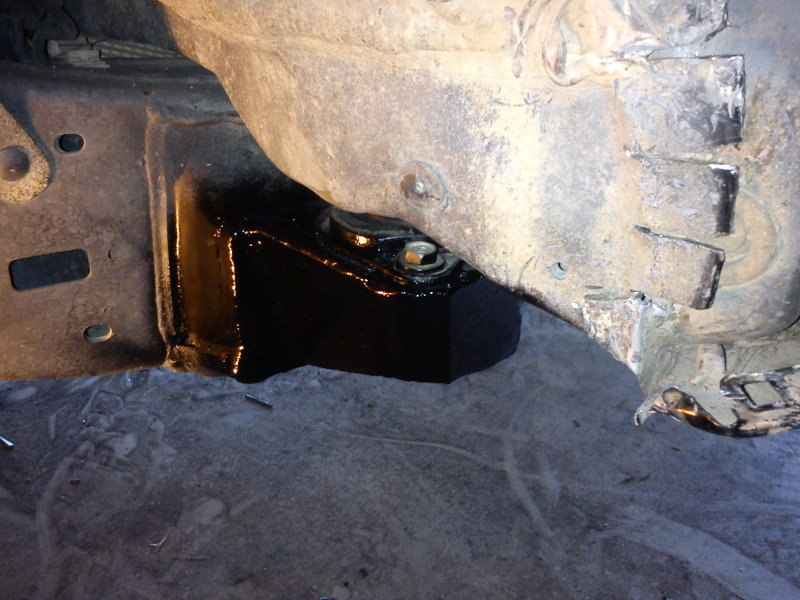

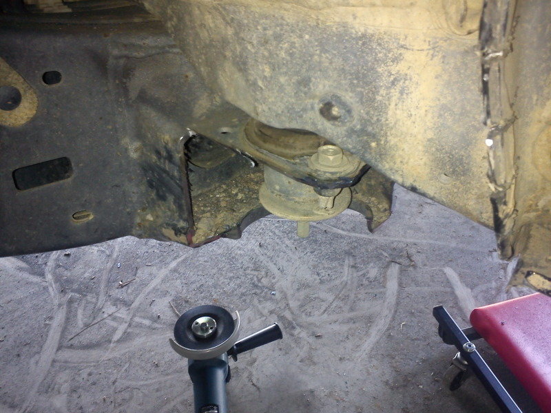

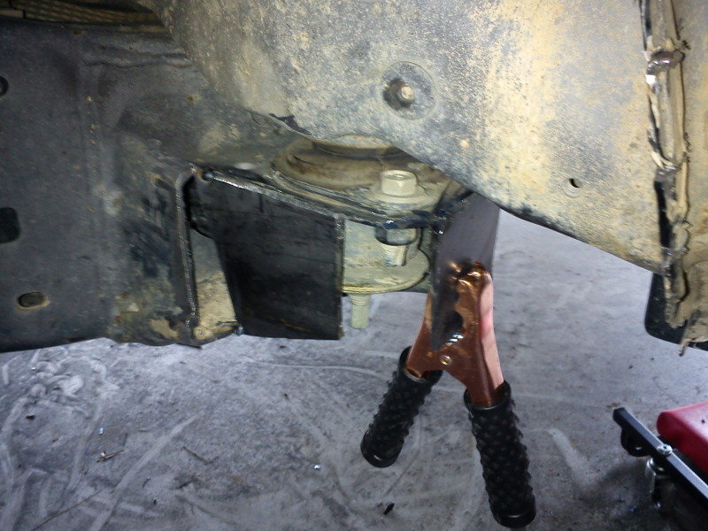

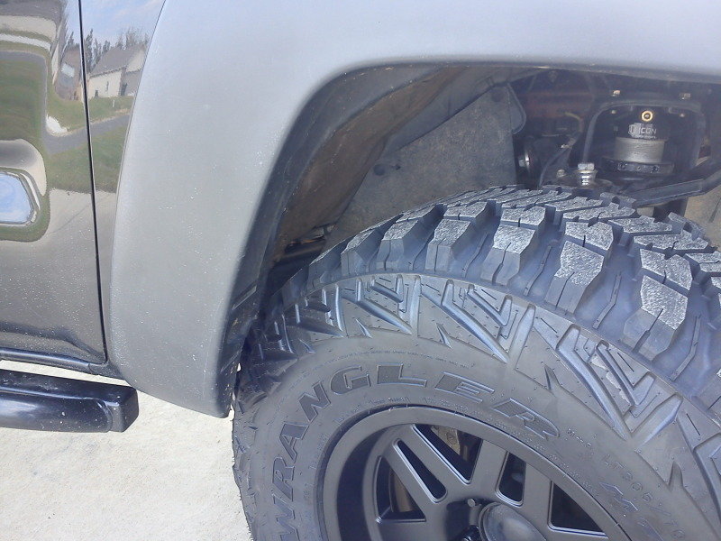

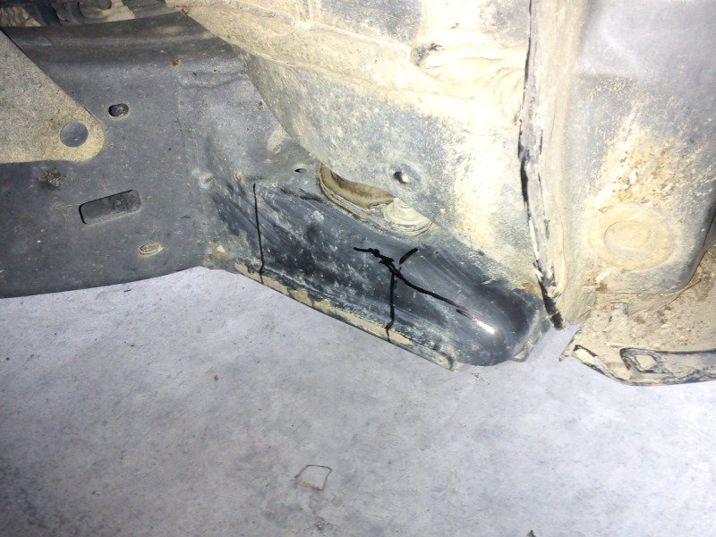

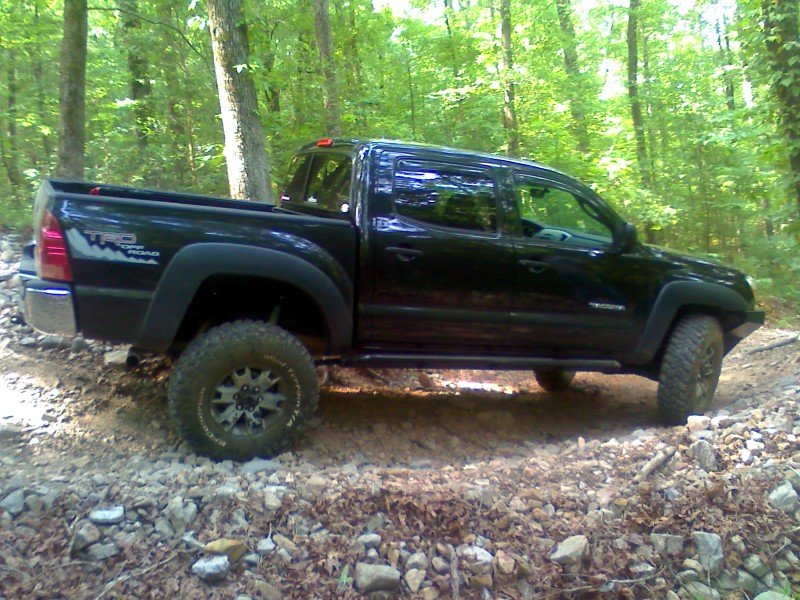

    So the first thing to do to make the 305s fit is the cab chop. Don't be making fun of my booger welds lol. They'll ride..
    And, testing to make sure the cab mounts clear after.

    Actually the rear tire was up on the rock, so I drove right off it. You can see it a little better in the pic below. It really wasn't that bad, just made for a pretty cool wheel stand pic lol.

    Yep, definitely gonna have to cut the fender. As a few others on here have done, I plan to cut 2" out of the fenders and flares, and put the flares back together. Right now I'm planning on using Max's method. Here is the glue and the gun.

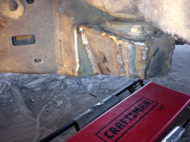

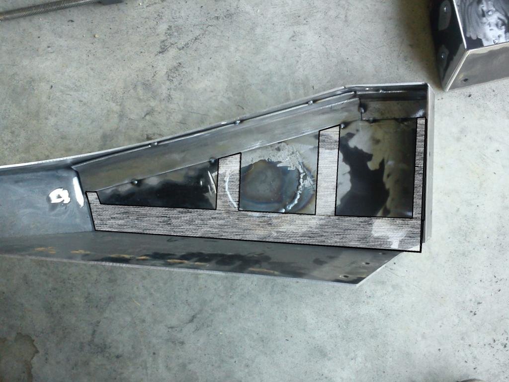

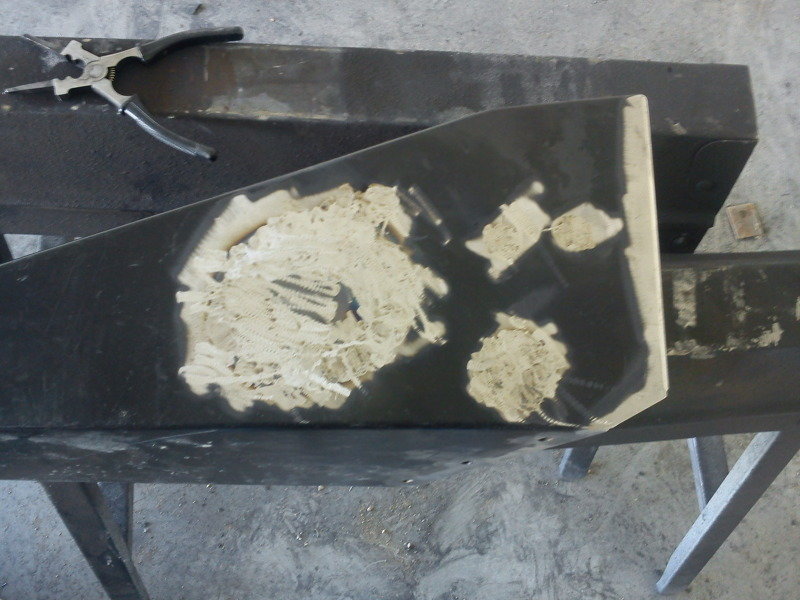

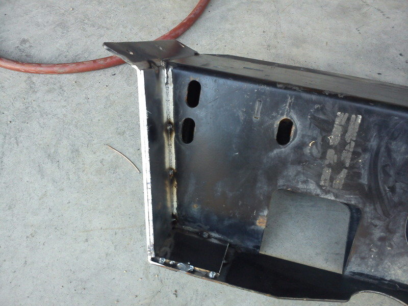

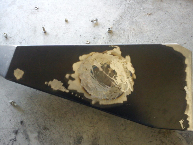

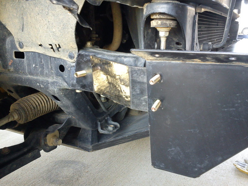

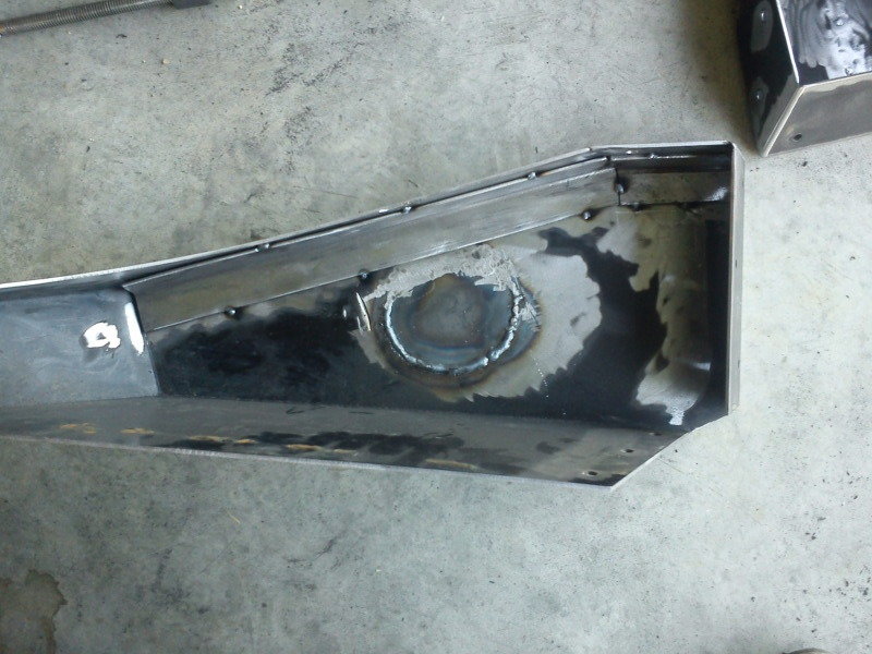

    So I'm on vacation all week and decided I would do a little work on my All Pro front bumper. I've been thinking about this a lot lately. I would like to get a more solid bumper, but I can't justify it. So, I decided I would *attempt to beef the AP up a little.
    Up first, remove the lights and fill in the holes for a few reasons:
    1. I never use the lights.
    2. I can sell them and buy other parts.:D
    3. The holes just make a place for mud, sticks, etc. to get.
    4. They were in the way of adding some bracing to the bumper which should add some strength.
    I also filled in the other holes on the bumper from the AP badge and winch plug. Anyway, on to the pics!
    Then I decided that I needed some way to tie the bumper into the frame a little farther back to avoid the issue of the bumper pulling away while winching. I tried and tried to come up with a way to weld some brackets to the bumper, but I could not come up with a way to do it and still be able to install/remove the bumper. So, I added some 1/8" plate to the lower part of the bumper (see pic) for a solid mounting point. This should make it 1/4" in effect, which I think should be sufficient.
    Then I came up with a bracket to do what I want it to. It ties into the bumper with 2-3/8" bolts and ties into the frame with 1-1/2" bolt.
    I also decided that I needed to add some bracing to the wings. After consulting with a couple of friends, I decided to add some angle on the inside of the bumper. I'm still thinking this one through, but the pic below is where I'm at so far. I'm also thinking I may add some angle on the bottom and then put 2 or 3 braces between. Not sure yet..
    Oh, and everything is just tacked in place right now. It will all get completely welded before I'm done. The bumper will also be completely welded together and sprayed with Raptor Liner.

    So this is kinda what I'm thinking as far as the additional bracing on the wings...
