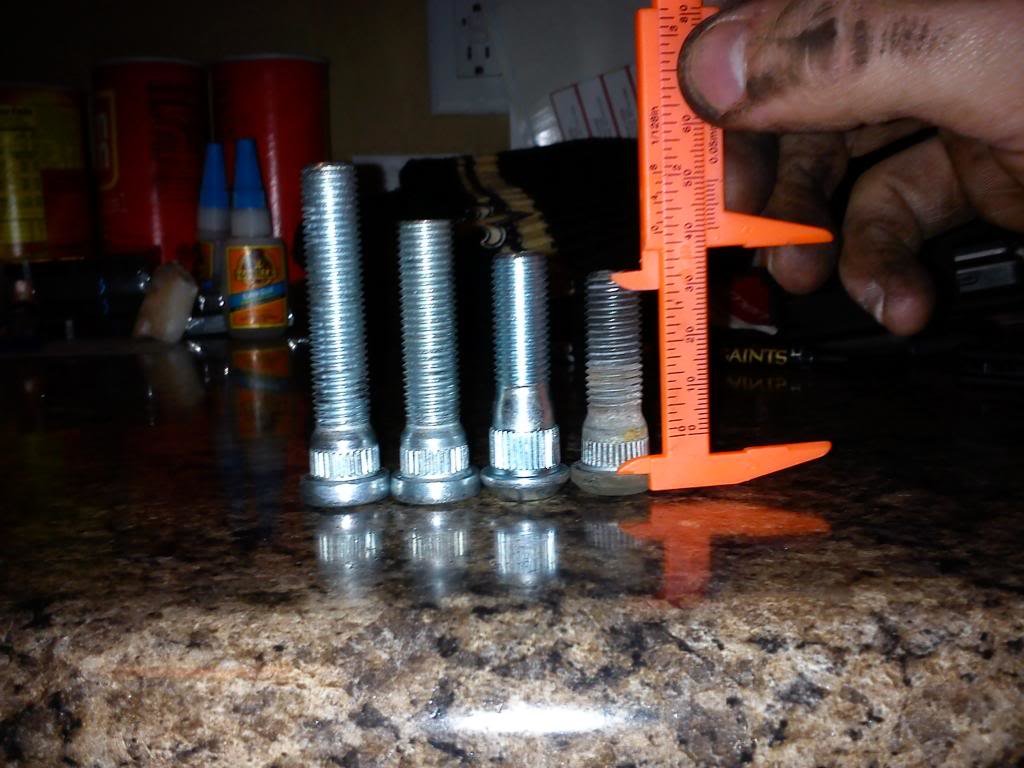

    Also found a pic of my wheel studs. From right to left:
    1. Stockers on all four corners of the 2nd gens- 40mm
    2. Rear studs on 1st gen tacos- 44mm
    3. Shortened wheeladapter.com studs- 52mm
    4. Full length wheeladapter.com studs- 65mm
    I also bought one of the Matrix studs while I was testing. They measure 55mm and would almost be perfect, but it appeared that the stock lug nuts could possibly contact the longer knurl, because the stock lugs go nearly to the brake rotors/drums. I'm not sure that I'll ever run stock wheels again, but I wanted the option.
