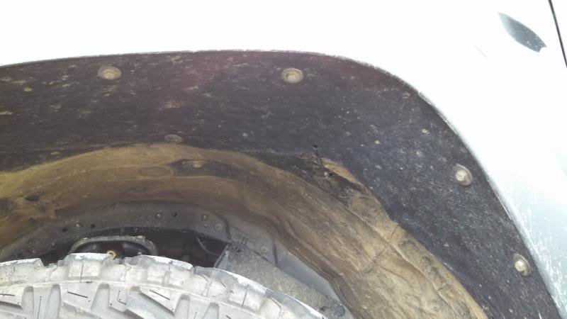

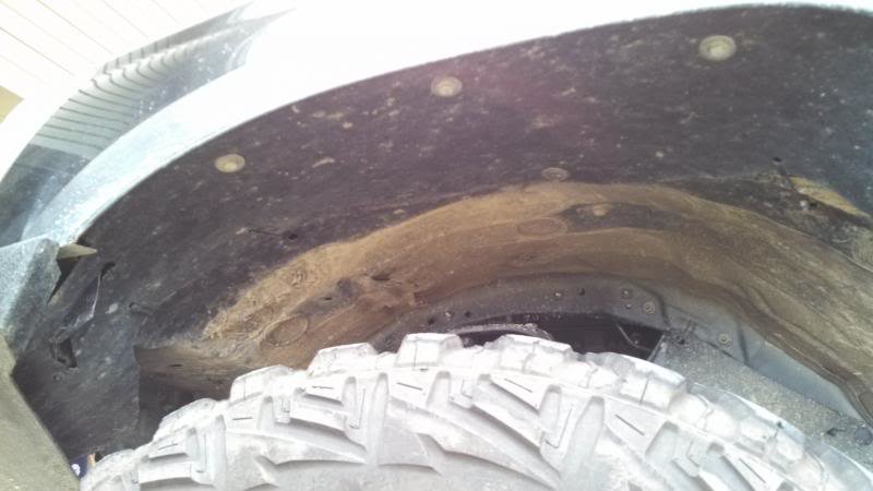

    Time for a long overdue update. I'll try to pick up where I left off...

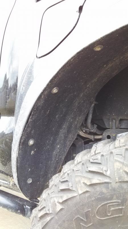

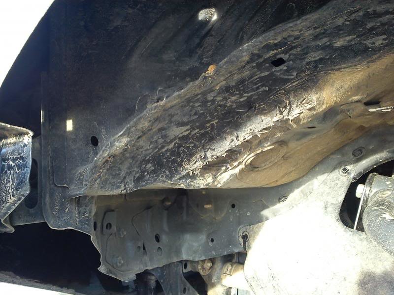

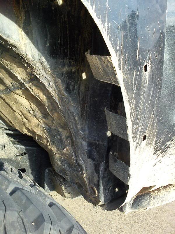

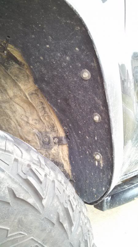

    So, I think I covered pretty much everything I did last spring except the fenders/flares/liners..

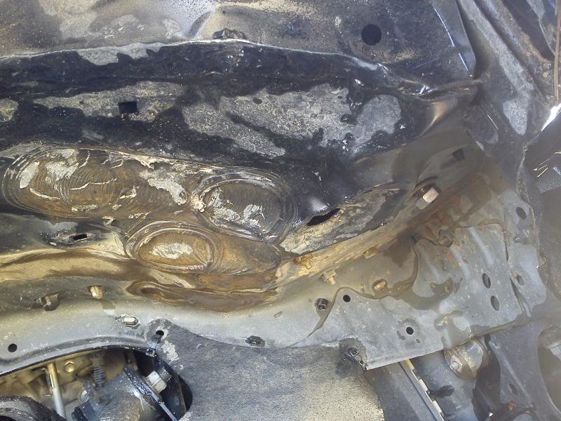

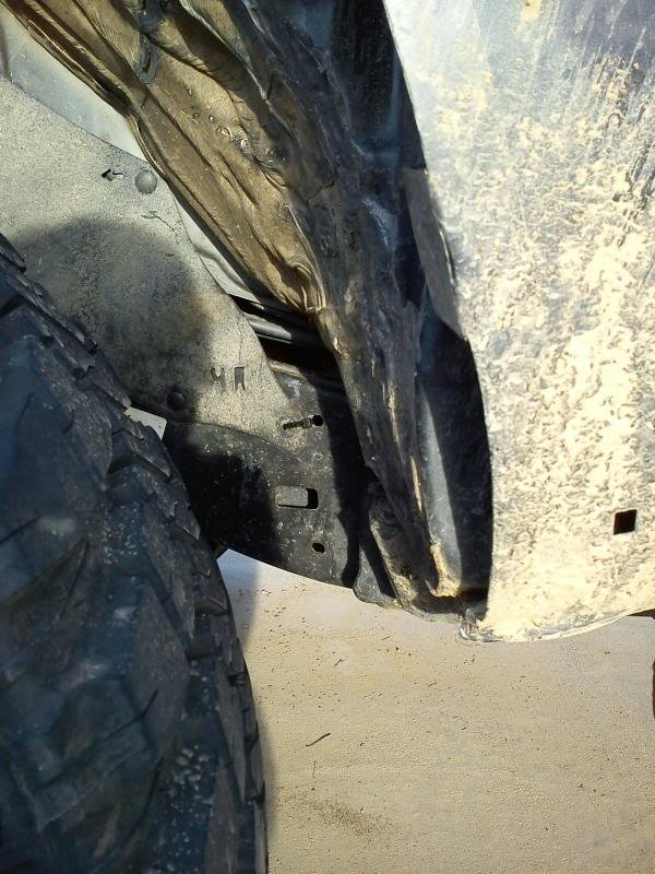

    I ended up cutting 2.5" out of the fenders and every so often folding the tabs back for mounting points like this:
    Then I drilled holes in those tabs and welded some nuts and washers to the tabs.
    [future picture]
    The rear cleared fine with no more cutting, but the front required a great deal of cutting and BFH work to completely clear the tires. I cut the pinch weld completely off, then beat the sheet metal back, welded it back together about every half inch, and then sealed it with some RTV.

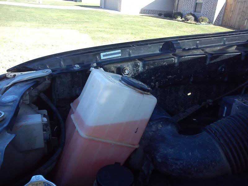

    The front of the front fenderwells had to be massaged as well. I beat these in probably about 2". I had to relocate some wiring and the washer fluid reservoir. The bolt you see to the right in the first pic actually goes up to the bottom of the washer reservoir.
    I then cut the flares 2.5" as well and just put some of the cheap stick on "edge trim" over the edges.

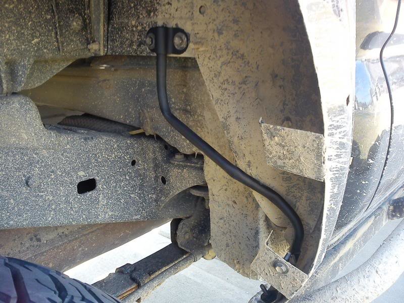

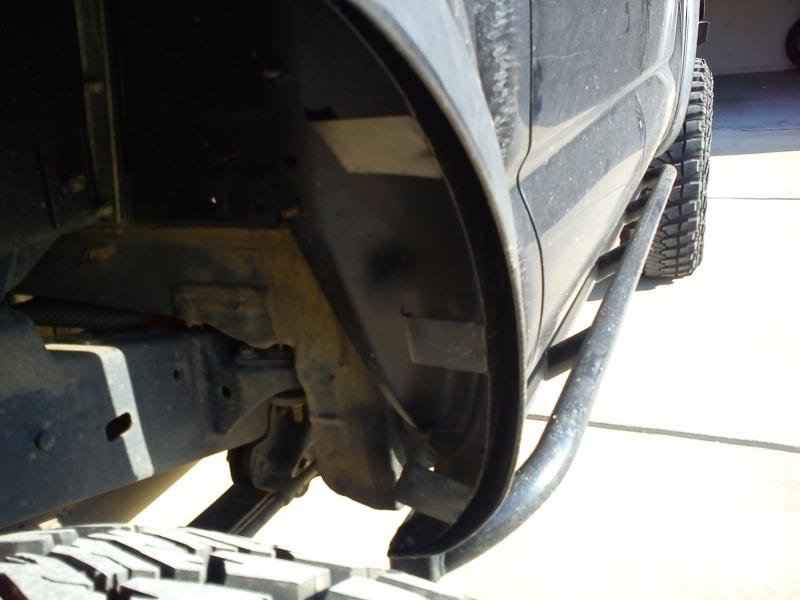

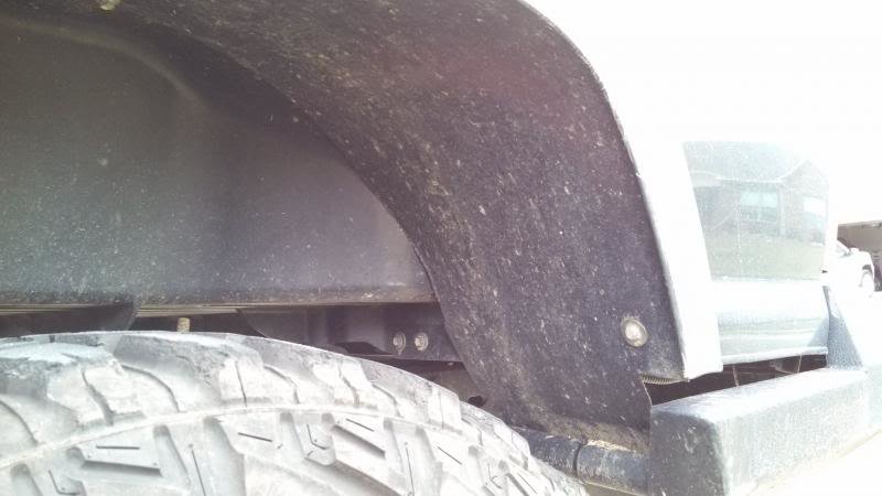

    Then I picked up some thin ABS plastic sheeting and cut fender liners for all four corners, drilled holes at fender tab locations, and bolted those dudes in. I cut the liners so that they would overhang the gap between the flare and fender and slightly push against the flare for some added stability.
    I also added a few zip ties in some strategic locations, and had to make some brackets for the front to mount.
    The fender supports on the rear were modified to work as well. I think I bent these things in about 20 different spots before I got them right lol. I welded all of the bend locations when I got done..
    And, now I have zero rub.:D

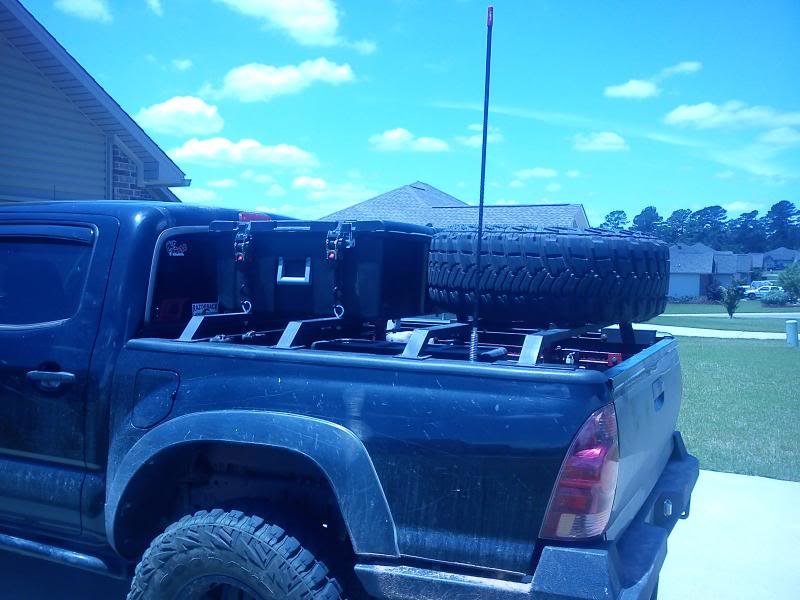

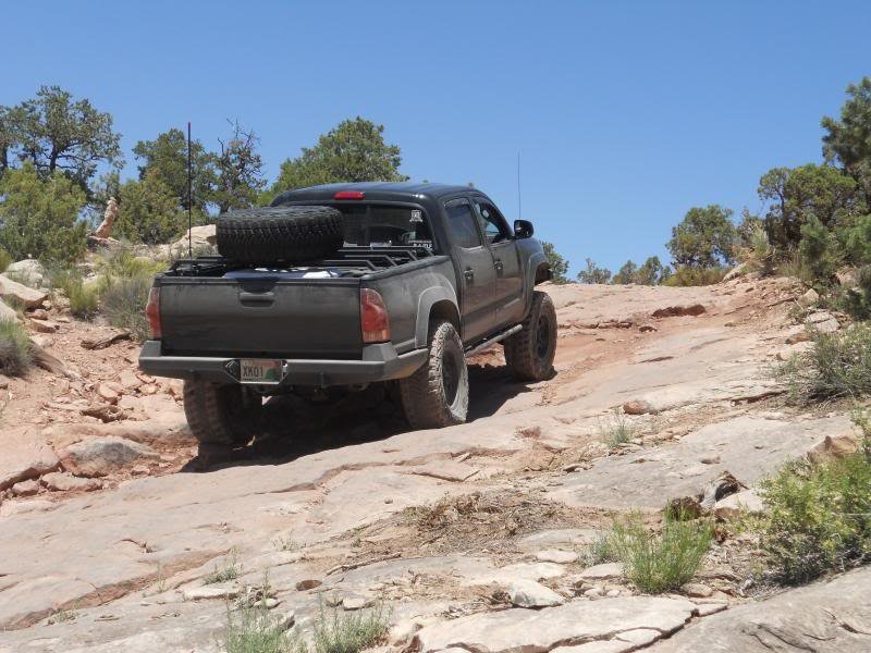

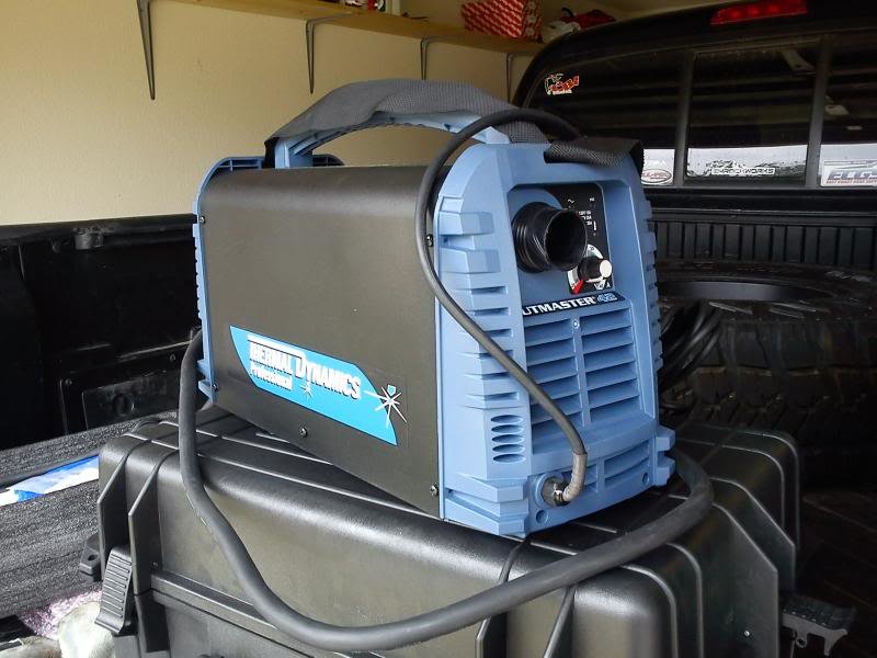

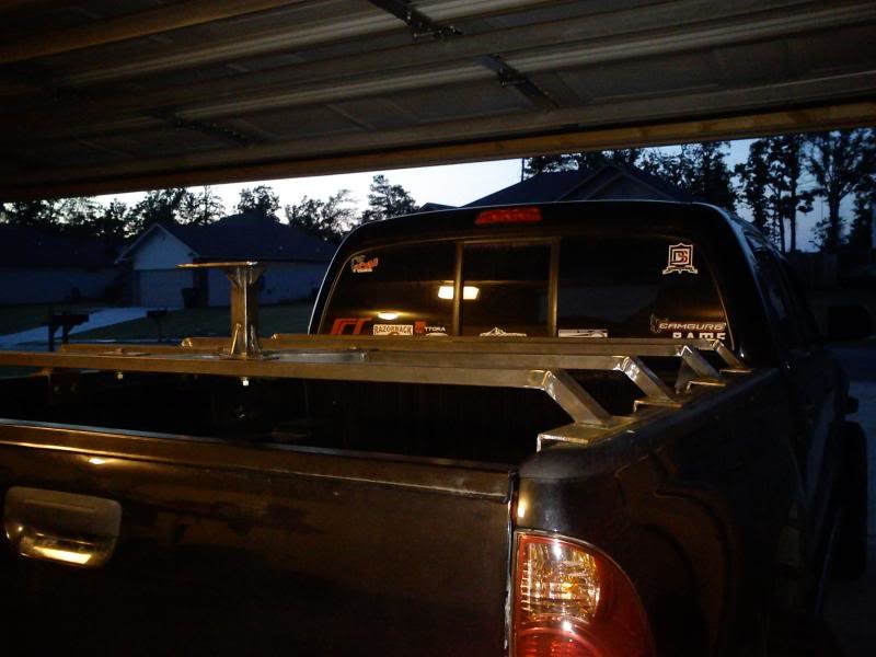

    Then I picked this up:D
    And built my bed rack 2 days before Moab.

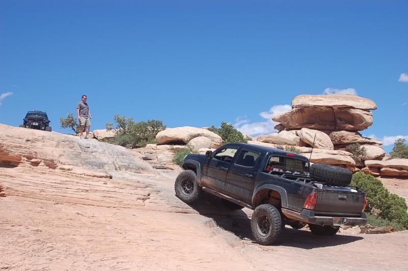

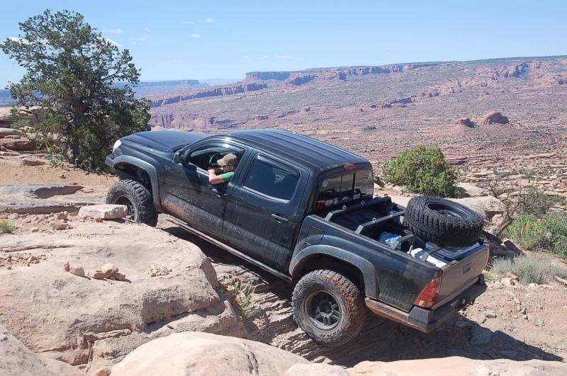

    Then, Moab! Here's a few from Lauren's album. I have apparently misplaced the flash drive that had our pics on it:(
    I believe all of these are from Gold Bar Rim and Golden Spike.
