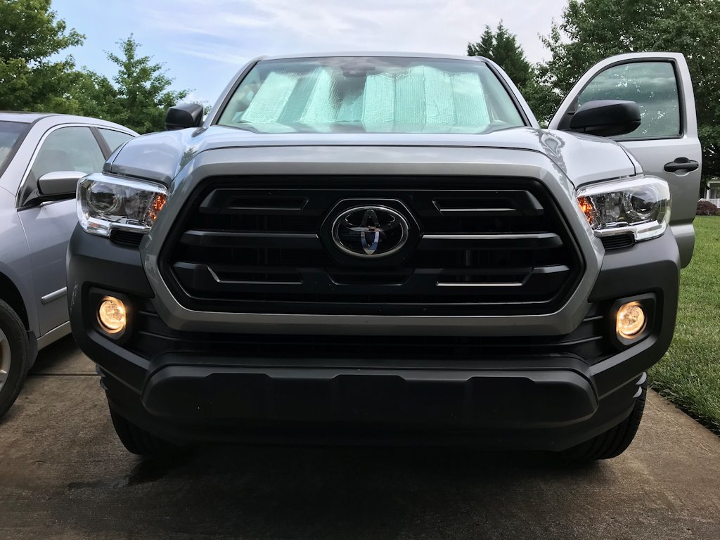

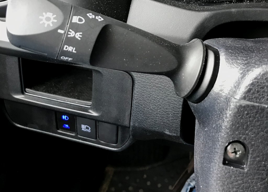

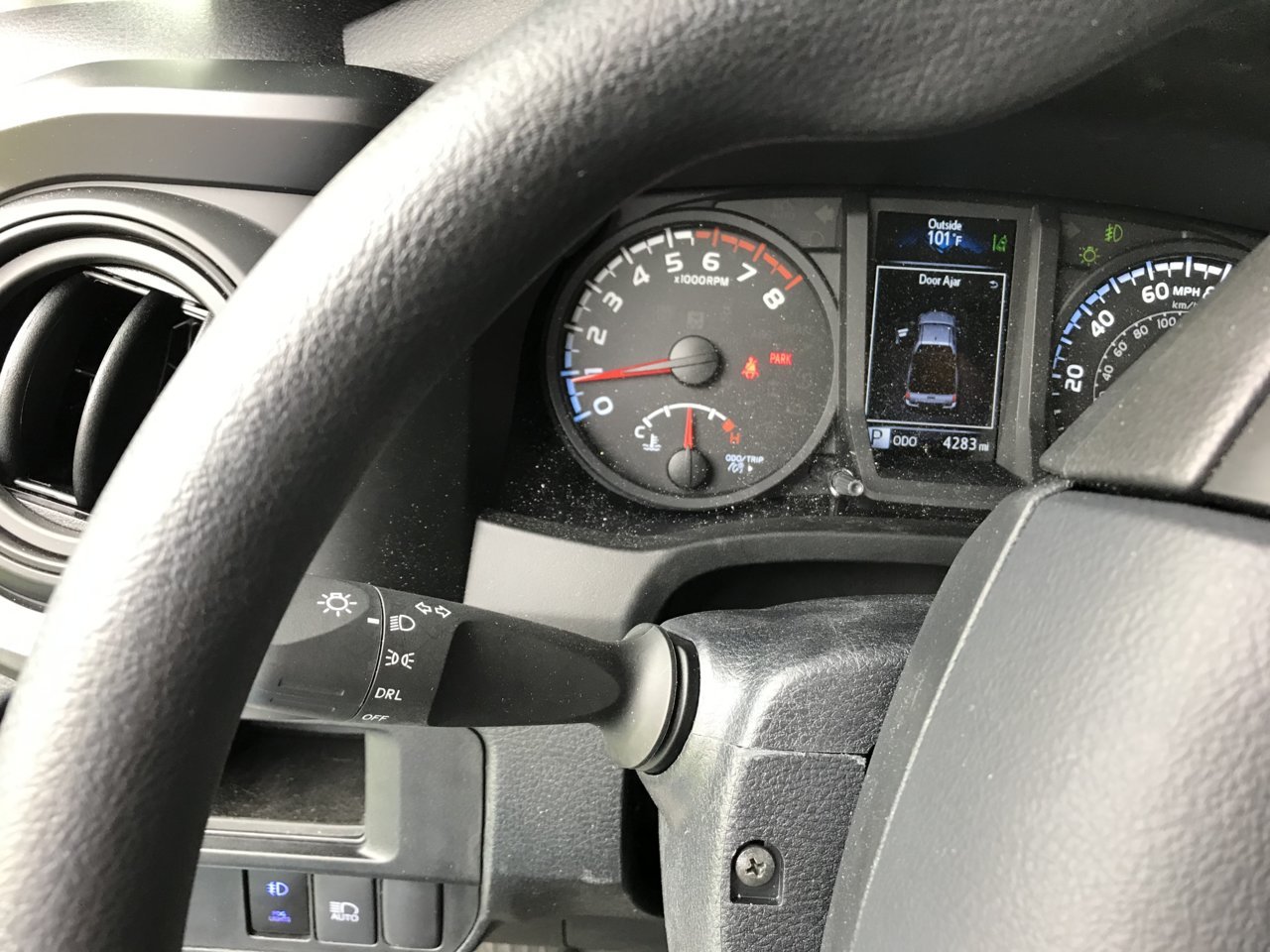

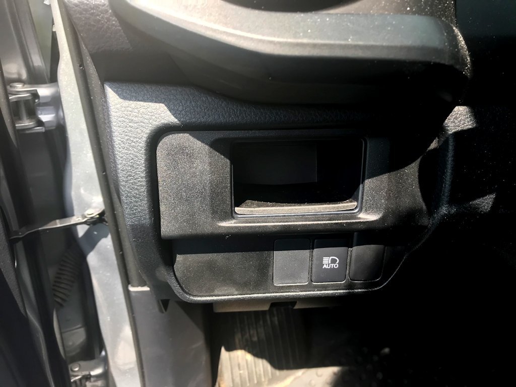

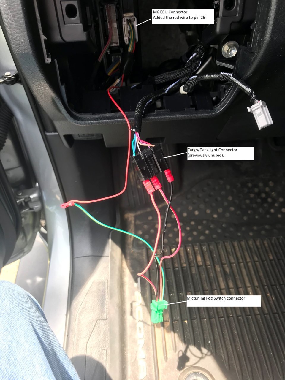

    OEM fog light mod done on my SR access cab utility long bed, used a modified version of Nitori’s SR OEM fog light mod. Thanks to Nitori and a lot of others posting in this thread, it helped a lot.
    I was able to access everything needed for the separate switch OEM mod interior wiring simply by removing the left switch panel, no need to take off lower dash panel or kick panel. Used the cargo/deck light connector white/black stripe wire for ground, since it already goes to ground, made it easier. Used cargo/deck light green wire socket for LED illum +, tan wire socket for LED illum -. Everything works as designed for OEM style, fog light symbol on dashboard lights up when fog light button is pressed with low beams on, fog lights turn off when high beams are on. Also modified the Mictuning Fog Light switch circuit board (has a DPDT switch) so that the upper bulb symbol will illuminate when the button is pushed to turn on the fogs (lower "Fog Light" text comes on whenever the dash lights are on).
    Mictuning switch Used:
    https://www.amazon.com/gp/product/B01G1QZ6MS?ie=UTF8
    How I wired Mictuning switch connector:
    Green: – M6 Main Body ECU connector pin 26 (see Nitori's write-up on page 1 for how to add the repair wire pin 26 to the connector)
    Red (1) w/yellow stripe closest to green wire: Ground, I connected to cargo/deck connector white with black stripe wire, which already goes to ground
    Red (2) w/yellow stripe closest to black wire:cargo/deck connector Green wire (Illum+, for LED power)
    Black Wire: cargo/deck connector Tan wire (Illum-, for LED power)
    **Update: I have now replaced the switch with a larger form factor CH4X4 fog light switch, it’s wired the same as above. See this post:
    https://www.tacomaworld.com/threads/nitoris-oem-sr-foglight-mod.451495/page-21#post-23754835 **
    You can use Posi Taps or T-taps for connecting to the cargo/deck connector wires if your cargo/deck connector is being used. Since my cargo/deck connector was not being used, I had positaps on hand, but decided to use 2.8 mm male spade lugs (which I had to compress the width to make narrower with needle nosed pliers to get them to plug into the female connector sockets):
    https://www.amazon.com/gp/product/B01MYTWTE2?ie=UTF8
    Note: Even without modifying the Mictuning switch circuit board, it will still work fine as wired above, only the switch top bulb symbol will not illuminate when button is pressed because the OEM method takes pin 26 to ground when the button is pushed so you get 0V to your top LED since it’s connected to the output of the same switch. Your fog lights will come on and your dash fog indicator symbol will illuminate and that's all that really matters.
    Took a lot of pics of the install, here are a few.
