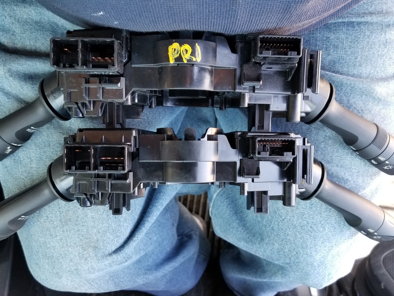

    4. I got confused on how to remove the clockspring / module. The tabs aren’t quite so easy to identified. They are at 12, 8, and 4 o’clock... a bit more recessed in towards the dash. I also then wasn’t sure how to remove the switches. It goes out away from the spindle at 12 and 6 towards the seat... then there’s one thick tab that has to bend towards you for the wiper switch to then be a able to slide out. (I read about removing screws, I got lost in that and little tabs... don’t do that.

    It’s all in and working. The clock spring sets dead center and I from factory that little wheel thing in the window of the clock spring is yellow.

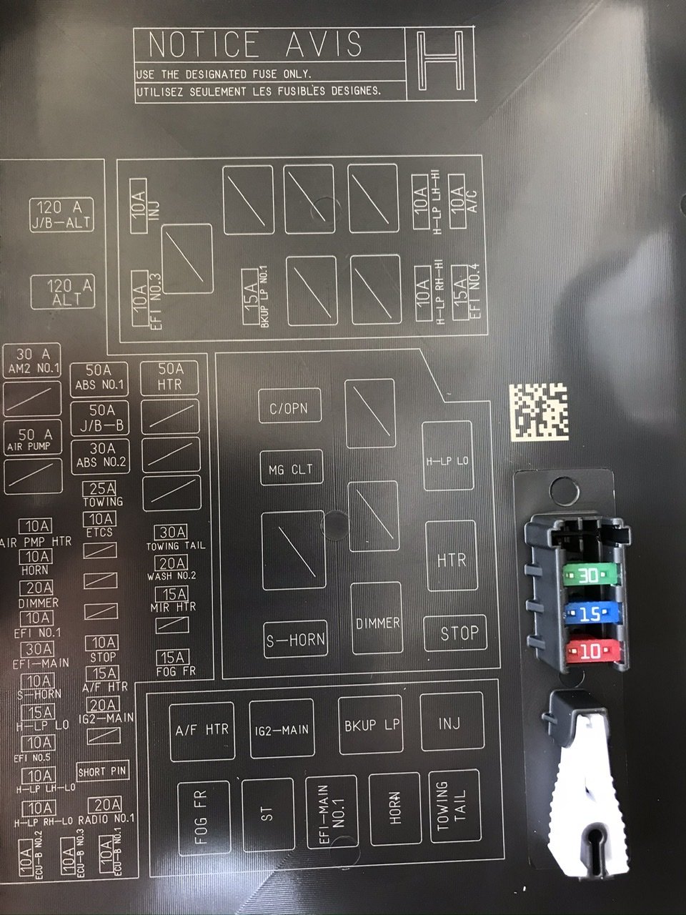

    Update for this post... Just did this install on my 2021 SR with V6 and SX package, which was prewired....Only thing of note is when I went to installed the relay under the HOOD (not dash) I found Toyota had already supplied one for me....Now I have a spare....

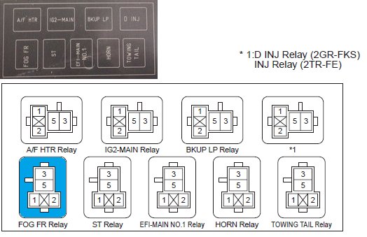

    What relay under the dash? My 2019 SR fog light relay is in the engine compartment fuse box (fog light fuse was already there but had to install the Relay). Is the 2021 different?
    pinktaco808 likes this.

    Pic of engine bay fuse box cover for my 2019 Tacoma SR, FOG FR relay is shown at the bottom of the pic.
    pinktaco808[QUOTED] likes this.

    Where pin 26
