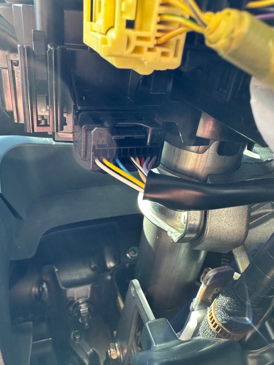

    I was installing some bed lights and a new factory switch today in my new 2023 SR V6 4 x 4 and I knew eventually I was going to do this fog light mod. I took my steering wheel panels off just to see if I was prewired or not and I was surprised I was not according to the pictures in the first post. This is what my connector looked like as it didn't have those two wires on the upper section of the connector. I was surprised as I was fully expecting it to be being a V6 model and all.

    You can add the missing terminals and the headlight stalk with the integrated fog switch or the terminal to the M6 connector on the Main Body ECU and external switch. Or an intercept harness to the C11 (connector to the headlight stalk) and add a switch. Or even tap into the TAIL circuit at the C11 with an added wire (blue) and terminal from M6, having fog ON with the TAIL circuit. (might not pass inspection depending on State Inspection requirements.)

    MIne was the same way..2023 SR V6 4x4, no wire in the stalk. So I did the terminal wire method in the ECU plug and external switch.

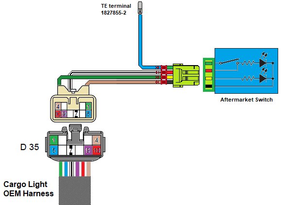

    PM @daveeasa or @kmorgan3 or @Puppypunter

    Thanks for the diagram. So it was basically be all plug and play if I can get one of those T harnesses? When I look up the one that @kmorgan3 sells I notice it has two loose wires coming from it. I'm assuming one of the loose wires goes to 26 on the M6 connector and the other one to ground?

    The harnesses make it plug/play for switch illumination, you would still have to wire one leg to the missing terminal (if you’re going to hardwire it) and the other wire to ground.

    Incorrect, just need to follow the terminal insertion into M6 (following procedure of first page of this thread, ground is part of the connector to the Bed Lamp connector)

    Yes thats what I was thinking as well,at least I would not have to splice into the cargo switch harness. I know they sell those harnesses on Tacoma Beast and Caliraised but according to another post I seen the ones that Caliraised are not the official ones by Redside Electric, not sure if the ones that Tacoma Beast are or not?

    Thanks for clarifying that, so the other loose wire on that harness goes to nothing, just cap it off?
