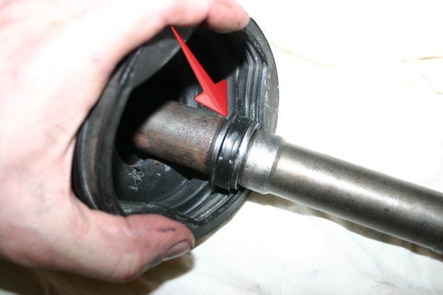

    Jimmy - aside from the high angle boots, what else do I need to get to refurbish my pair of CV's?

    ^ this almost. You leave a C clip in to hold the boot, not a clamp.
    4faec303-dc02-42d7-94e4-00a364b7929d_zps_2a28532e61f77b7cebf2d6ba3ddc20fa02672d04.jpg
    To add to it I put some RTV on the spot the boot will sit on since it wont sit in the "groove" anymore and clamped it from there. This is a first gen thread about it but I assume you can do similar for second gen cv's.
    https://www.tacomaworld.com/threads/boot-slide-mod-no-more-blowing-cv-boots.146070/page-9
    Problem is it's messy.

    Does it come with inner and outer clamps? My SDHQ boots only came with outers.

    My boots came with both clamps. They are not CVJ

    A box to send your cores to CVJ :thumbsup:
    Mine came with both

    I have sdhq (not installed) as well and it's only got outers, where do you get those c clip things for the bootslide mod? @cynicalrider
