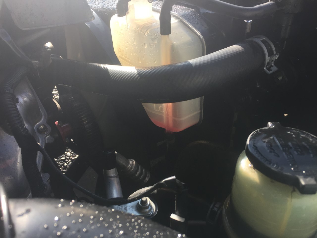

    I slipping out of gear and will not go back in. I was on the parkway yesterday morning on my way to work and I felt the trans slip one at 75 mph then it was fine. Then last night on my way home from work I was on the parkway I felt it slip again. I got off at my exit and stopped at the first light and as I was slowing down it felt like I was in the brakes. Once I came to a complete stop I had to give a lot of gas to get it to move. About a mile from my house the trans slipped totally out of gear. It went right into reverse when I backed it into my driveway. Last night after I put the kids to bed the truck sat for a couple hours I when out and hooked the scan gauge up to see if it was throwing any codes and nothing. So I decided to go for a quick run through the neighborhood to see what it would do and it seemed to be shifting fine. I thought I would try running down the main rd to see if I would shift through all the gears and it seemed to shift fine. Then it started making a loud winning noise then it slipped out of gear and it wouldn't go back in. I ended up gimping home on the shoulder of the road. I would have to shut the truck off and let it sit for a few minute then start it back up and it would go back into gear long enough to get it to coast a few hundred feat until I got home then I had to push it into the driveway. I haven't done much wheeling this year, North East Takeover was my only trip and the trans never showed any signs of slipping until yesterday. I'm going to run up to the local trans guy today and see if I can get it towed up. IMG_0687.jpg
    :rolleyes: Looks like I will be driving this for a while.

    I think I found the problem.

    Low coolant?

    Hope thats not a head gasket although if it were its probably be black in there...

    I wold put money on it's leaking coolent into the transmission from the trans cooler. I would be able to check that if the dam thing had a trans dip stick.
