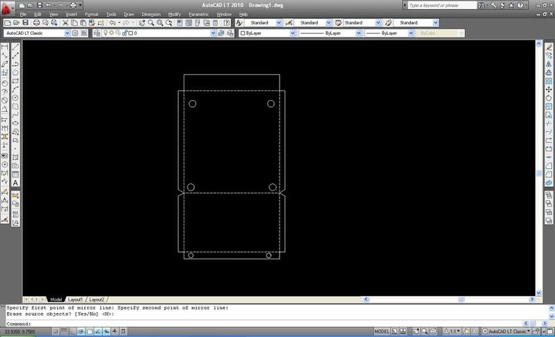

    I am in if you can get your hands on the blue prints for a nice front bumper.
  3. Feb 9, 2012 at 5:43 AM
    98tacoma27
    98tacoma27 is going full "SANDWICH" Moderator
    Dec 18, 2008
    #11714
    67,858
    Ben
    Not Beech Creek
    05 Tundra SR5 (+295k AND COUNTING), 2006 F350 King Ranch 6.0L
    Some stuff. Not a lot, just some.
    My eyes!!!
    You want that in CAD?

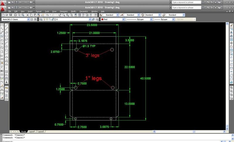

    How does it look? I have no idea what the 3" and 1" high comments mean? :confused:
  6. Feb 9, 2012 at 6:21 AM
    DdayIsNear
    DdayIsNear [OP] Well-Known Member
    Jun 14, 2009
    #18432
    6,489
    Crazy
    NW Jersey
    TRD Offroad
    All pro sliders
    Yeah, what is the 3" high measurement for the circle holes?
    No measurements on the cad drawing, wtf ?
    Edie, ur posting the answer

  8. Feb 9, 2012 at 6:34 AM
    DdayIsNear
    Jun 14, 2009
    #18432
    6,489
    Crazy
    NW Jersey
    TRD Offroad
    All pro sliders
    Much better, thanks, 1 down, 4 to go for skids. 2 bumpers needed.

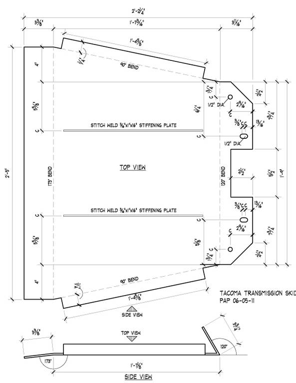

    That looks like the all pro ifs skid. My trans skid design mates right up to that.
  10. Feb 9, 2012 at 7:32 AM
    pAP
    pAP ==========
    Feb 15, 2011
    #51218
    1,575
    NJ
    24 Tacoma TH
    Just tint and ppl for now.
    Paps Trans skid
  11. Feb 9, 2012 at 7:47 AM
    pAP
    pAP ==========
    Feb 15, 2011
    #51218
    1,575
    NJ
    24 Tacoma TH
    Similar at a glance but different angle and protection from all three. All Pros goes straight from front to back and is the most narrow. ATOs is flared at the front (more protection) then straightens out and is wider than the all pro by about 2". Bud built is a diff animal with the lca protection in the front and has a sharper angle down to the front diff before it flattens off.

    That's my next project. I will be welding on those wings to my all pro ifs skid. :D
