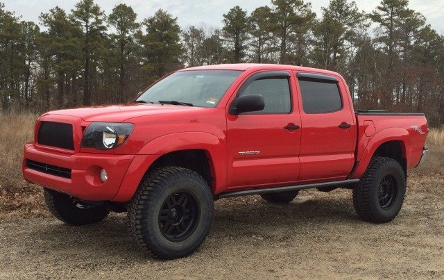

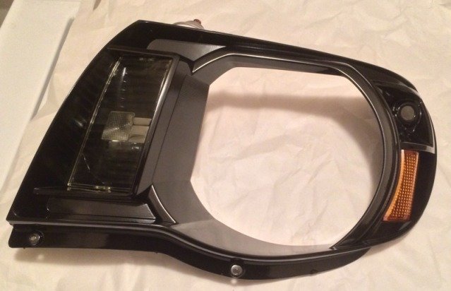

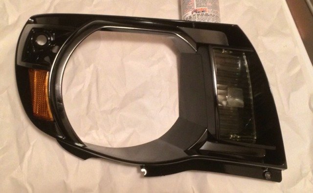

    first things first
    BHLM FTW
    One of my favorite aesthetic mods
    c975642f-61b1-4915-9e62-048612760419_zps_7af29f6ccab8d16468b744b629f3bea796c960c6.jpg

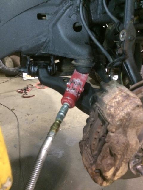

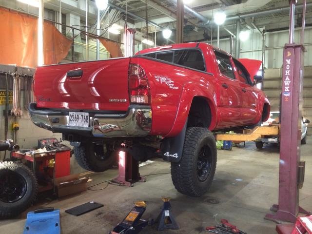

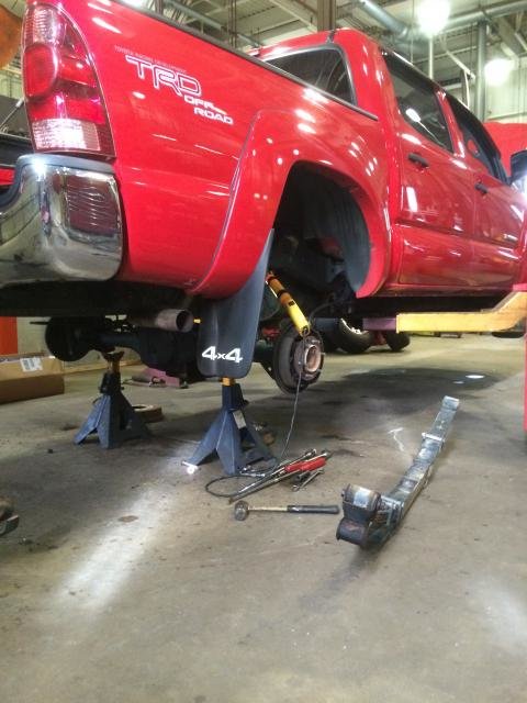

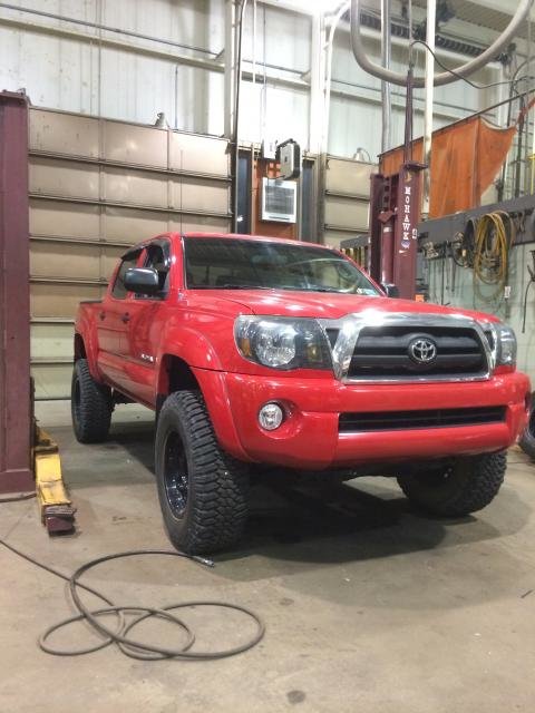

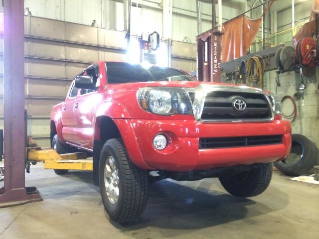

    time to install the suspension lift :D
    on the lift it goes
    Dakars & Bilstein 5100's going in
    temp tag still on :D
    porta power helped installing the OME 885's on OME shocks
    OME 885's & Dakars
    285/70/17 Tread Wright Guard Dawgs on Stealth Custom Series Stealth 6's

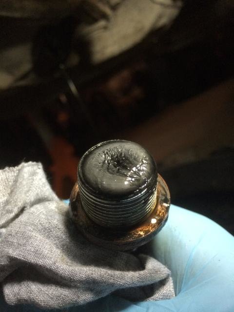

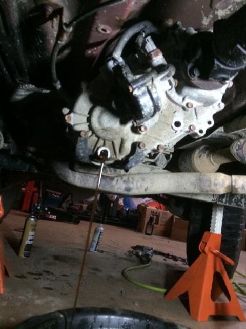

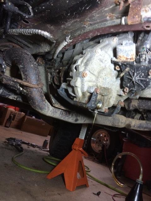

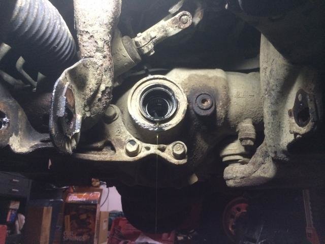

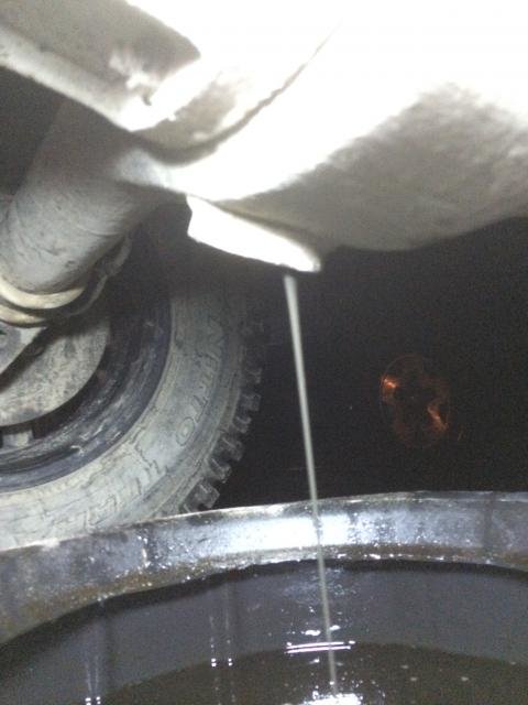

    I had maintenance records for the truck but I wanted to start fresh. I replaced the engine oil, both diff's & t-case gear oil, new air & cabin filter. I plan on replacing the spark plugs this spring.
    onto the fluid changes. front diff, t-case & rear diff got Lucas synthetic gear oil
    rear diff was diiirtaay
    t-case fluid looked pretty good
    that y-pipe :eek: future relocation noted

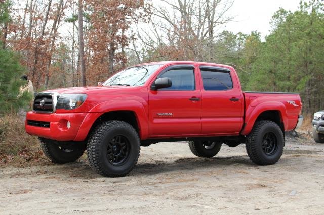

    first wheeling with some NJDB's
    NJ/PADB wheeling

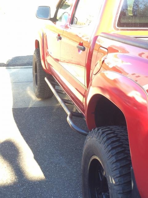

    picked up a set of 4x innovations bolt on sliders from paP's part out
    w00dy helped me install them :cool:
    we installed his AAL (what center pin :eek: )

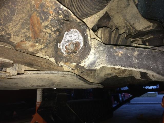

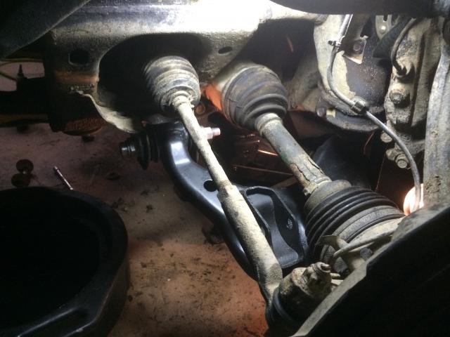

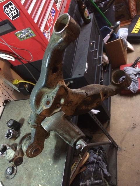

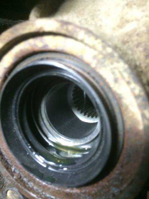

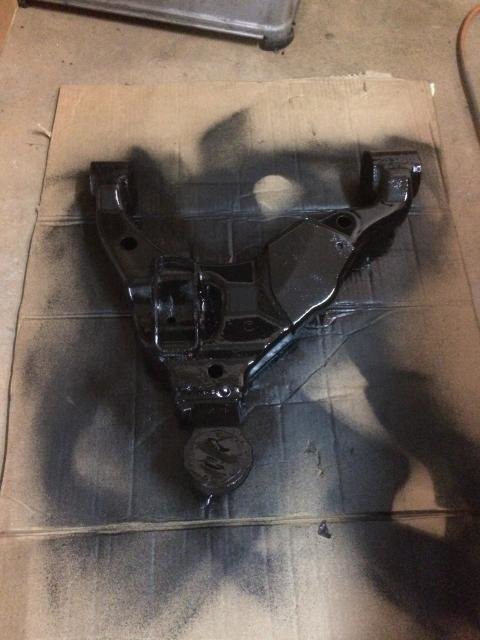

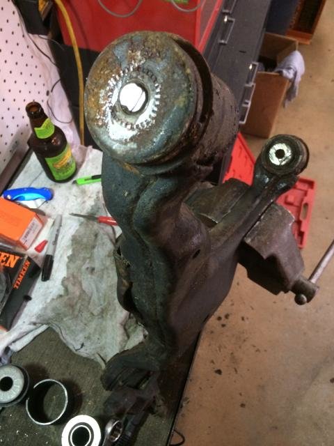

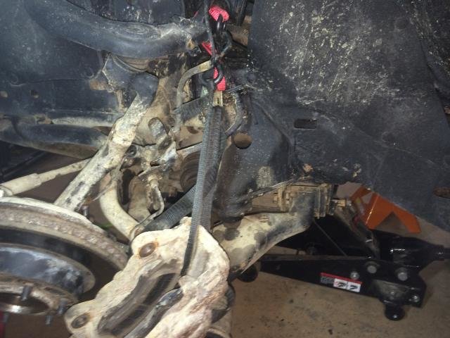

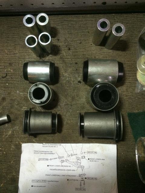

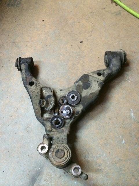

    onto the LCA bushing replacement

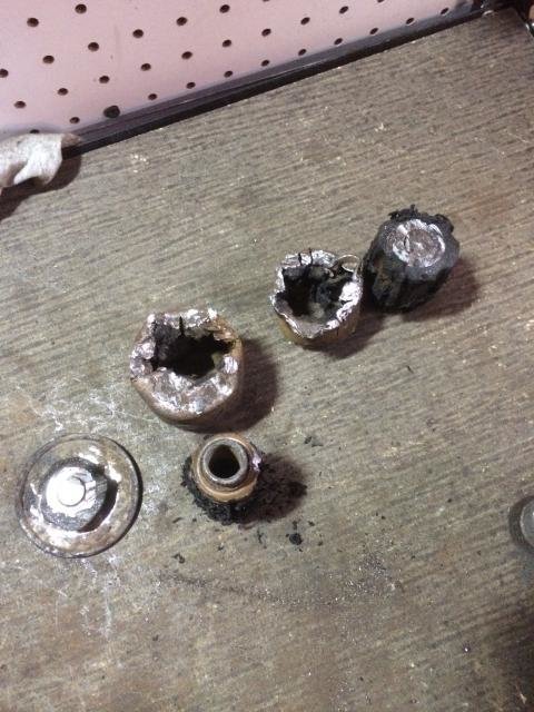

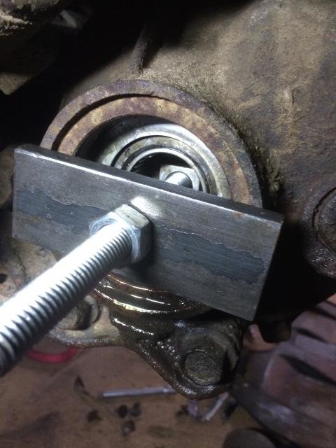

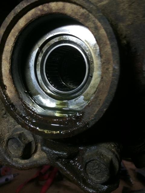

    this took a good amount of time. I decided while there I wanted to replace the lower ball joints, tie rod ends, hubs & install the ECGS bushing in the front diff
    since they were seized in the bushing, I cut the bolts with a sawzall to get the LCA out

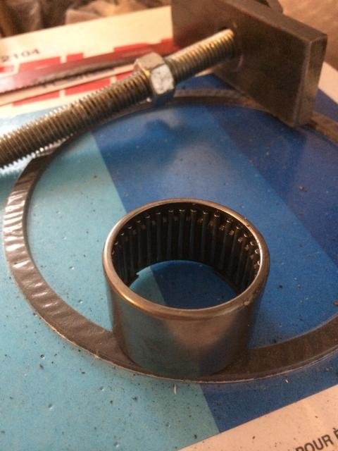

    CV shaft out, time to remove the needle bearing
    thanks to JLink for the removal tool :cool:
    needle bearing out :thumbsup:
    ECGS bushing installed
    onto replacing the LCA bushings, this was time consuming. I was able to press two of the four bushings out, the other two took alot of swearing, beer drinking, hammer swinging, & air chiseling.
    The Boyd method worked for the two that did not want to be pressed out.
    I wanted to try the Whiteline bushings, but the O.D. was about .050 too large. I had a set of Moog bushings so I installed them instead
    glass beaded the LCA's and painted them

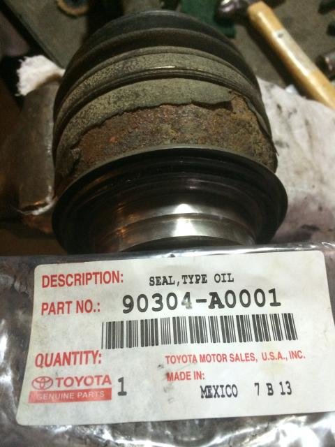

    this is the dust seal for the CV shaft (dealer only item)
    LCA in :woot: I used the Toyota bolts/cam's since the Moog's were only half correct

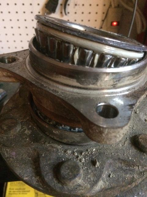

    Passenger side wheel bearing was smoked :eek:
    http://www.youtube.com/watch?v=1WhbdIADGKI
    Driver side wheel bearing was original & looked good when I took it apart. I replaced it anyway :cool:
    job complete! time for new UCA's :(

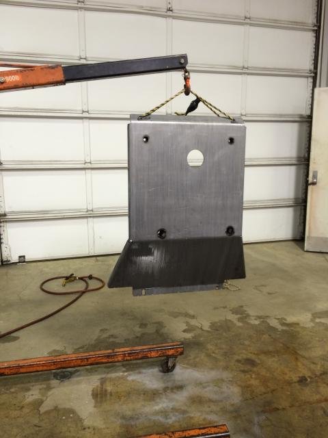

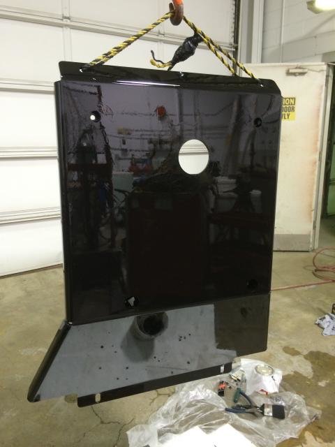

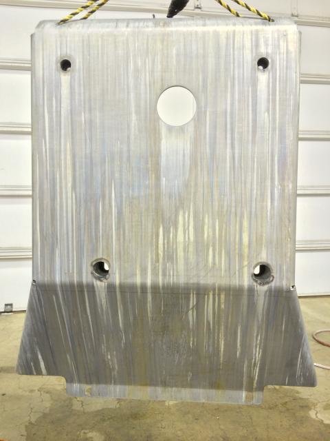

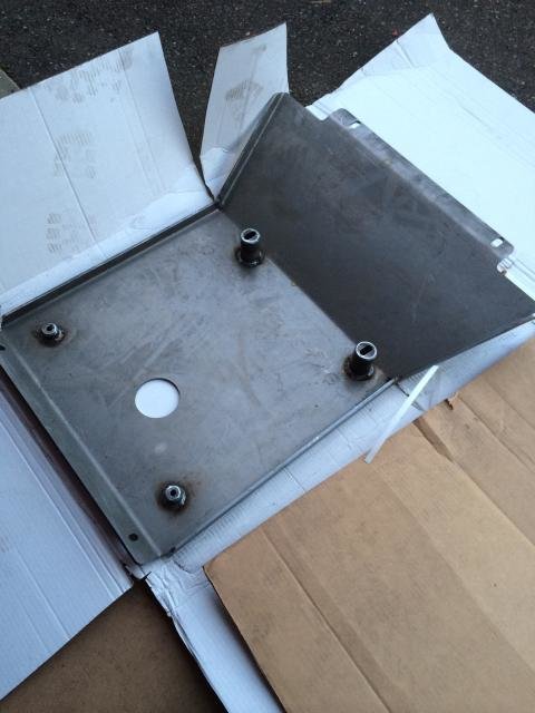

    took advantage of 4x innovations black Friday sale & ordered an IFS skid. very happy with their customer service, product quality & time to get it shipped :thumbsup:
    cleaned it with a degreaser
    soaked it in metal prep for 20 minutes
    a few light coats of Por-15 semi gloss (goes on glossy, dries semi gloss)

    Is that your shop you're working in? I love how your sliders look from the side, like they are barely even there.
