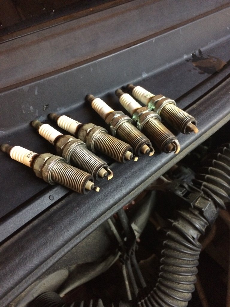

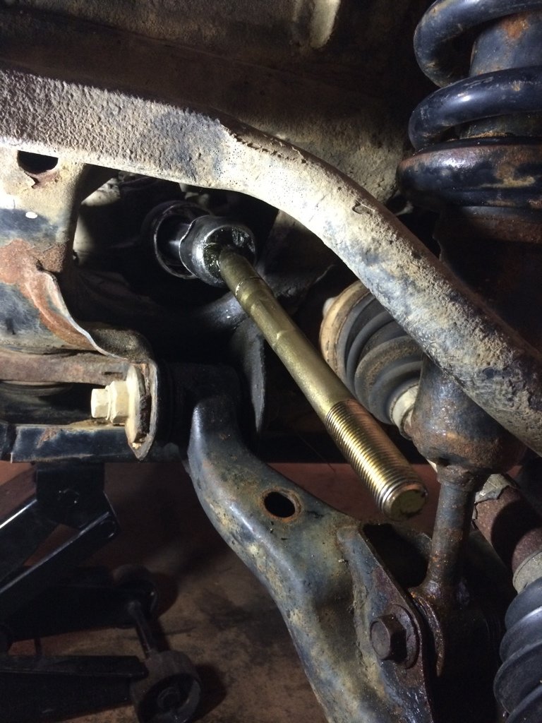

    90k maintenance today; oil change -- changed the spark plugs. All of them had at least .060 gap.
    Installed the NGK platinums - LFR6CGP (1483) @ .043 gap
    Also replaced the driver side inner tie rod -- it had slight play in it. I had one on the shelf so I swapped it out. The boot looked fine.

    changed plugs @ 92,800 miles
    most were around .060
    Crom likes this.

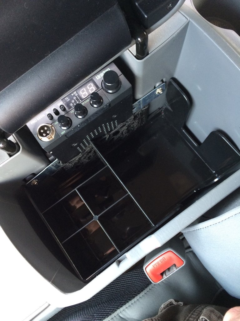

    center console organizer
