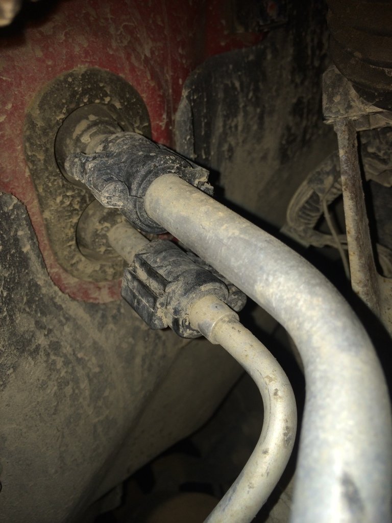

  5. Sep 21, 2015 at 12:21 PM
    #245
    Fed1633
    Fed1633 Member
    Sep 15, 2015
    #164328
    7
    2006 Toyota Tacoma
    Hey I have a small freon leak at the o ring connection at the firewall, there are plastic clips that hold the lines together. How do they un- clip or disconnect
  6. Sep 21, 2015 at 3:58 PM
    #246
    nj636
    nj636 [OP] Hub Master General
    Feb 14, 2012
    #72804
    5,389
    Kev
    Jersey
    OME lift 4x sliders 4x skids
    these two black clips ?
  7. Sep 21, 2015 at 5:06 PM
    #247
    Fed1633
    Fed1633 Member
    Sep 15, 2015
    #164328
    7
    2006 Toyota Tacoma
    Yes those are the ones

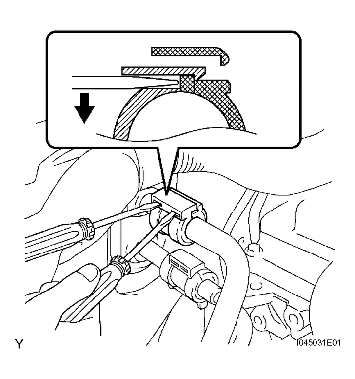

  8. Sep 21, 2015 at 5:36 PM
    #248
    nj636
    Feb 14, 2012
    #72804
    5,389
    Kev
    Jersey
    two screw drivers work well
  9. Sep 22, 2015 at 1:01 PM
    #249
    Fed1633
    Fed1633 Member
    Sep 15, 2015
    #164328
    7
    2006 Toyota Tacoma
    Thanks.... I have cold air again
    nj636[OP] likes this.
  10. Sep 22, 2015 at 5:04 PM
    #250
    nj636
    Feb 14, 2012
    #72804
    5,389
    Kev
    Jersey
    awesome! just had to replace o-rings and recharge?
  11. Sep 22, 2015 at 5:37 PM
    #251
    Fed1633
    Fed1633 Member
    Sep 15, 2015
    #164328
    7
    2006 Toyota Tacoma
    Yes. Changed o rings, pulled vacuum, and recharged.... Ice cold. Thx again!!!

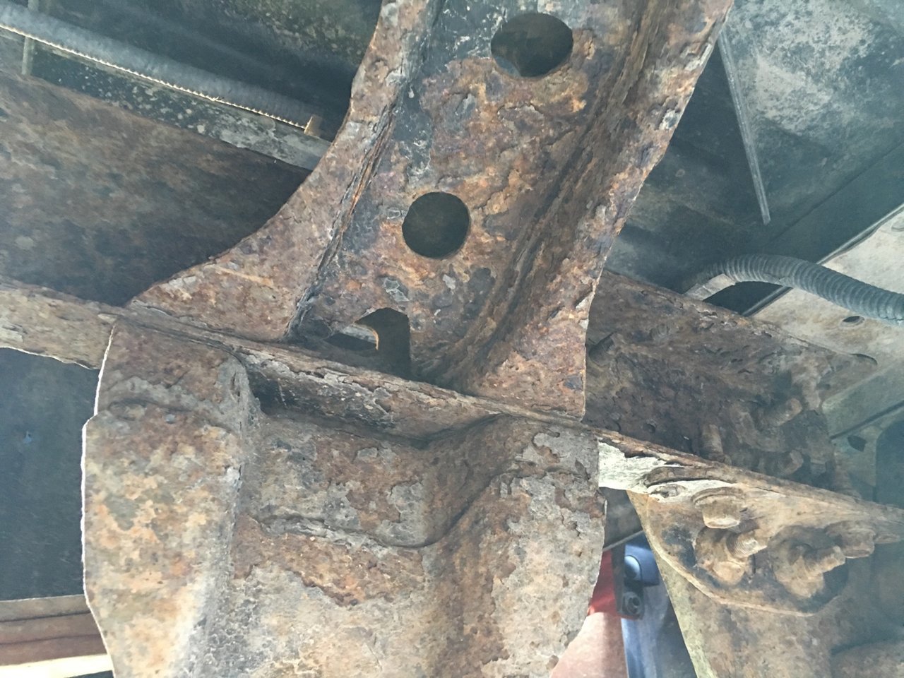

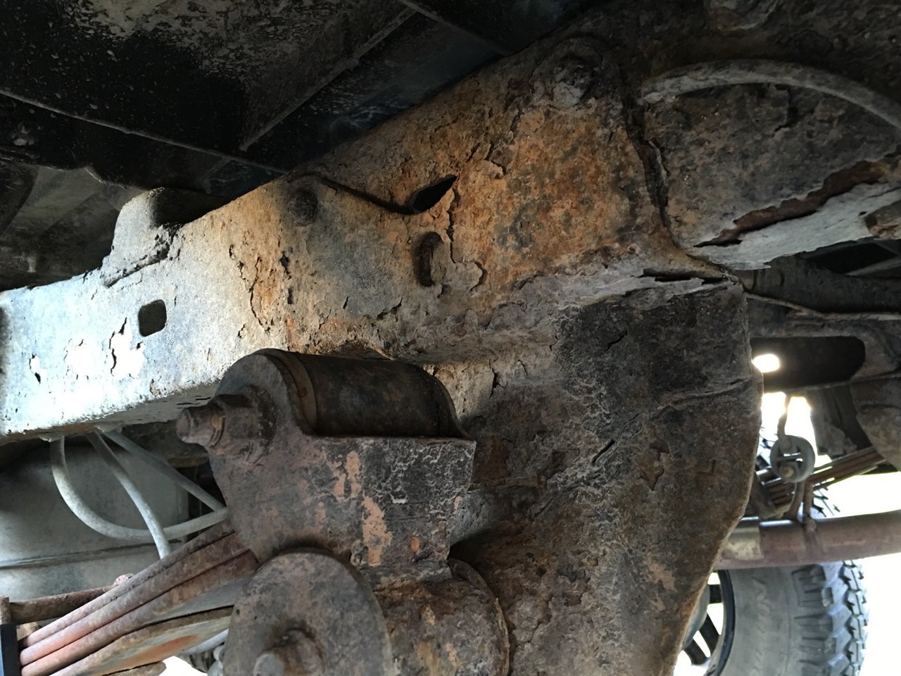

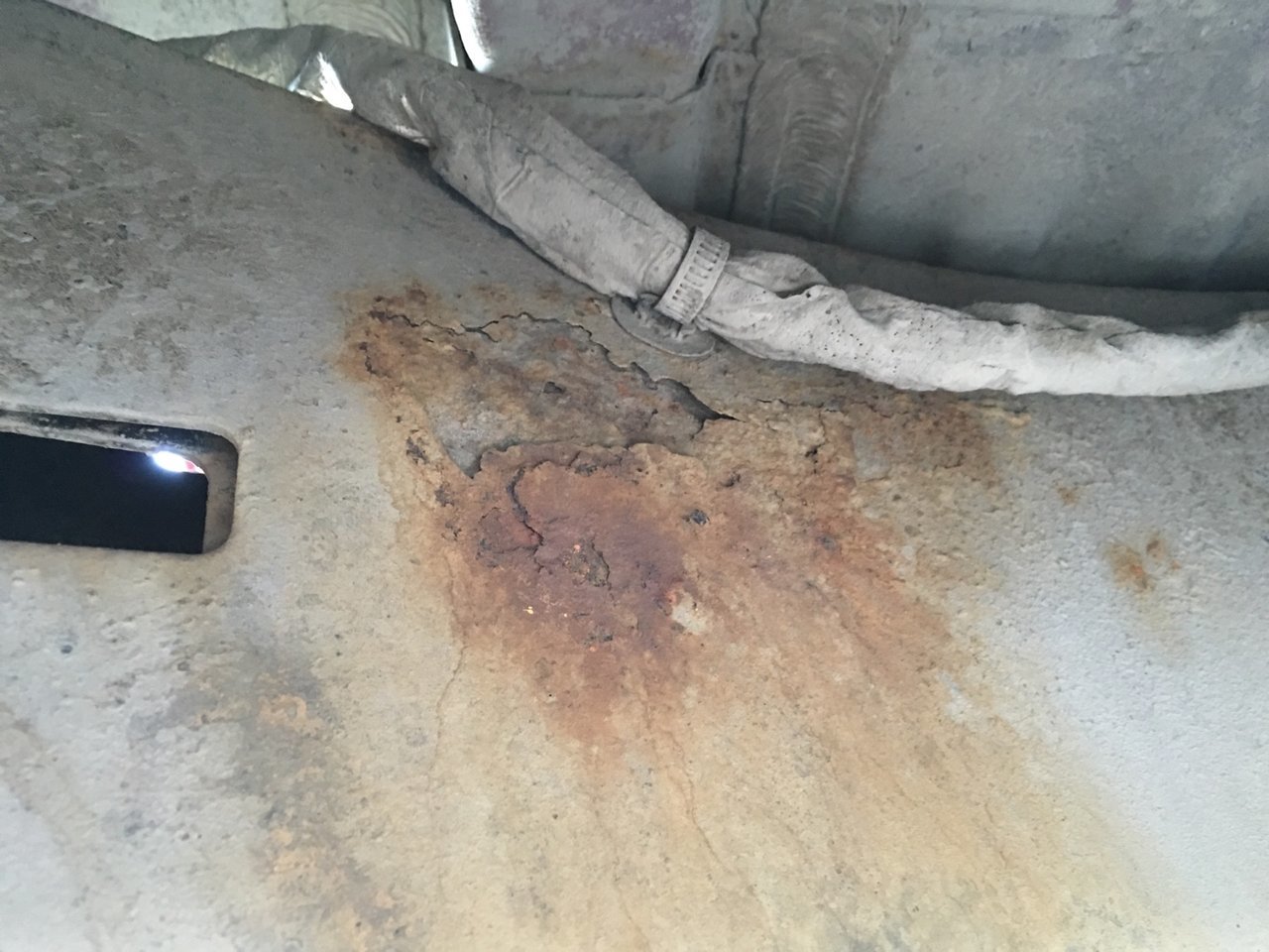

  14. Oct 20, 2015 at 8:02 PM
    #254
    nj636
    Feb 14, 2012
    #72804
    5,389
    Kev
    Jersey
    might be time to have the frame inspected.
    Crom likes this.

  16. Oct 20, 2015 at 8:06 PM
    #256
    PSU Taco85
    PSU Taco85 Señor Member
    Jun 21, 2014
    #132394
    2,011
    optional
    '10 TRD OR mostly stock
    Plasti dipped hootus
    A sheckle flip will get rid of most of that rust!

  17. Oct 20, 2015 at 11:20 PM
    #257
    06taco
    06taco Well-Known Member
    Jun 19, 2010
    #39173
    412
    Brendan
    South Jersey
    08 4x4 4-door TRD Sport
    *TRD Supercharger *3" OME lift kit *Dakar rear leaf springs *Total Chaos UCA *TJM T15 Plate Bumper *TJM Stealth 9000 winch
    Take it to Shore Toyota in Mays Landing. They are replacing my frame on my 2006 Tacoma on the 28th.
    I was talking to the service manager and he said they replace about 80% of the Tacoma's frames that come in and they inspect.
    Crom likes this.
