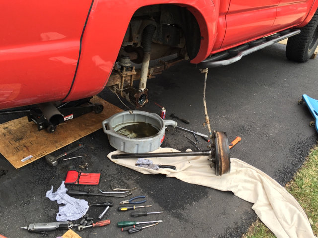

    103k
    axle seal, wheel bearing & brakes

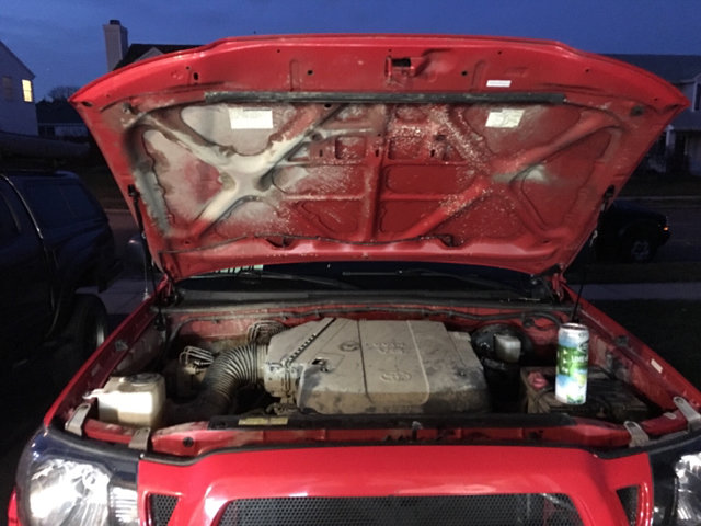

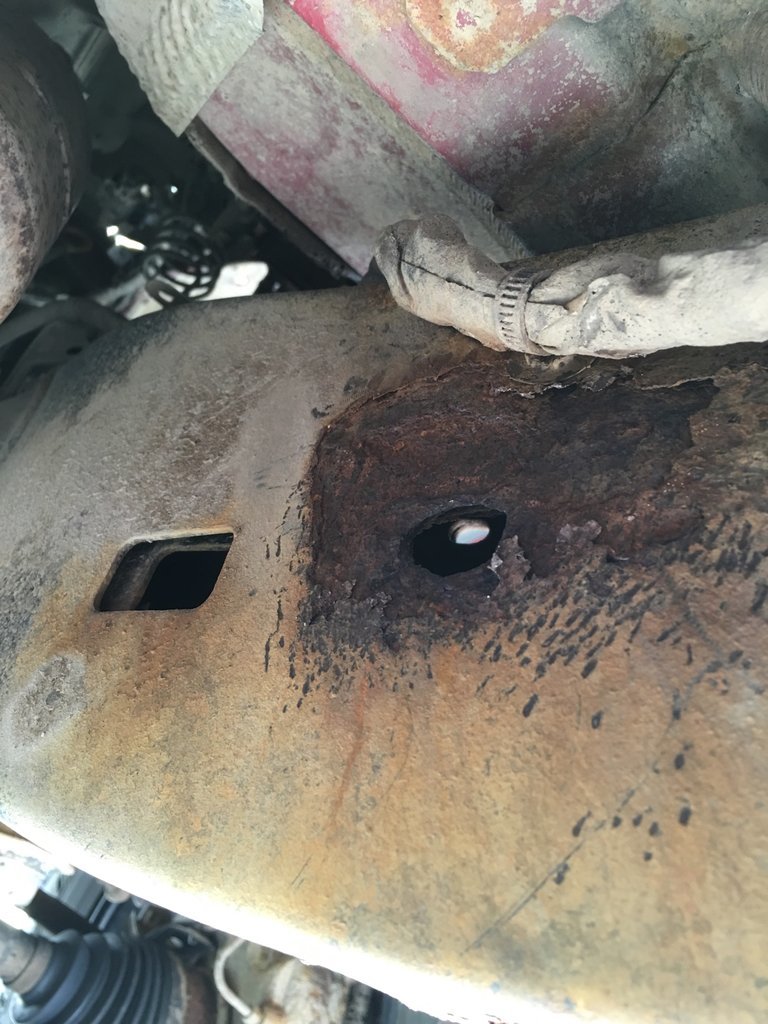

    have never been so happy to fail something 804aad59656e21788557e7a6600a1149_8bbc9e8fb3a65ebf3a165cd87b554035a48dec8c.jpg

    Crusty as fuck. Good to see you are joining the new frame crew though!

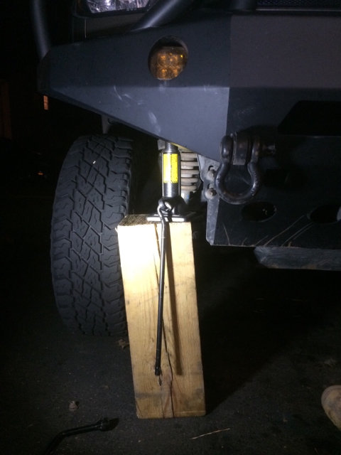

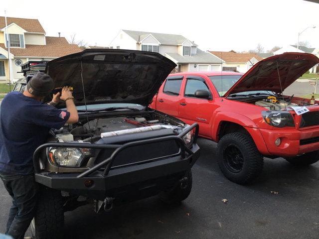

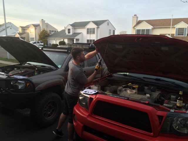

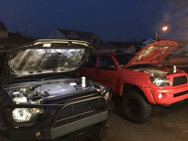

    @Chux stopped by Wednesday to do a Redline strut install --- We did both trucks, easy install.

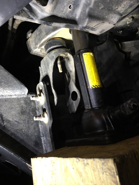

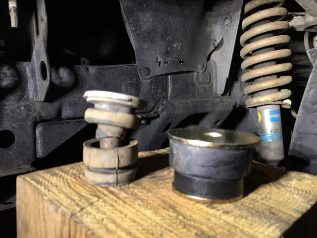

    We also installed Energy Suspension radiator support bushings on Jay's truck. Can't believe how worn out they were on his truck. Looked at my 06 and they were equally waffled. Immediately ordered them for my truck.
    @Chux radiator support bushing install
    We used the factory bottle Jack and a block of wood to raise the support enough to remove the bushing and install the new bushing.
    OEM vs Energy Suspension
    Crom, 99TacoDriver and Chux like this.

    Def check them out! The pic above of the stock bushings doesn't even do justice. They are fubar
