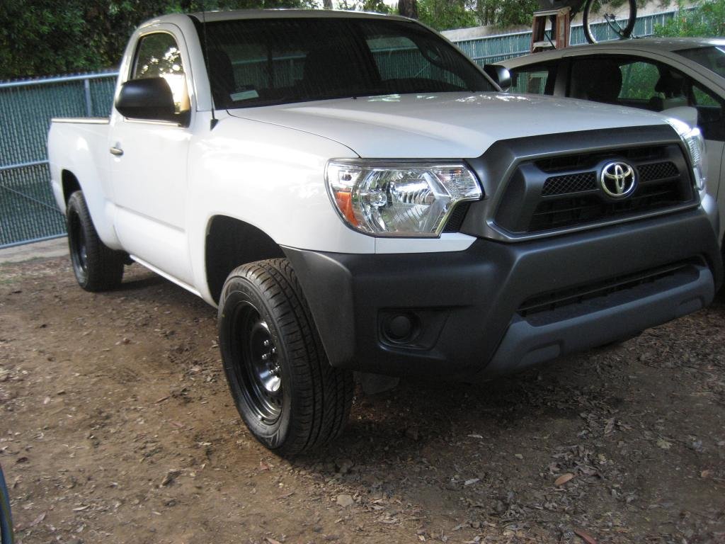

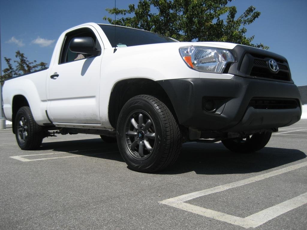

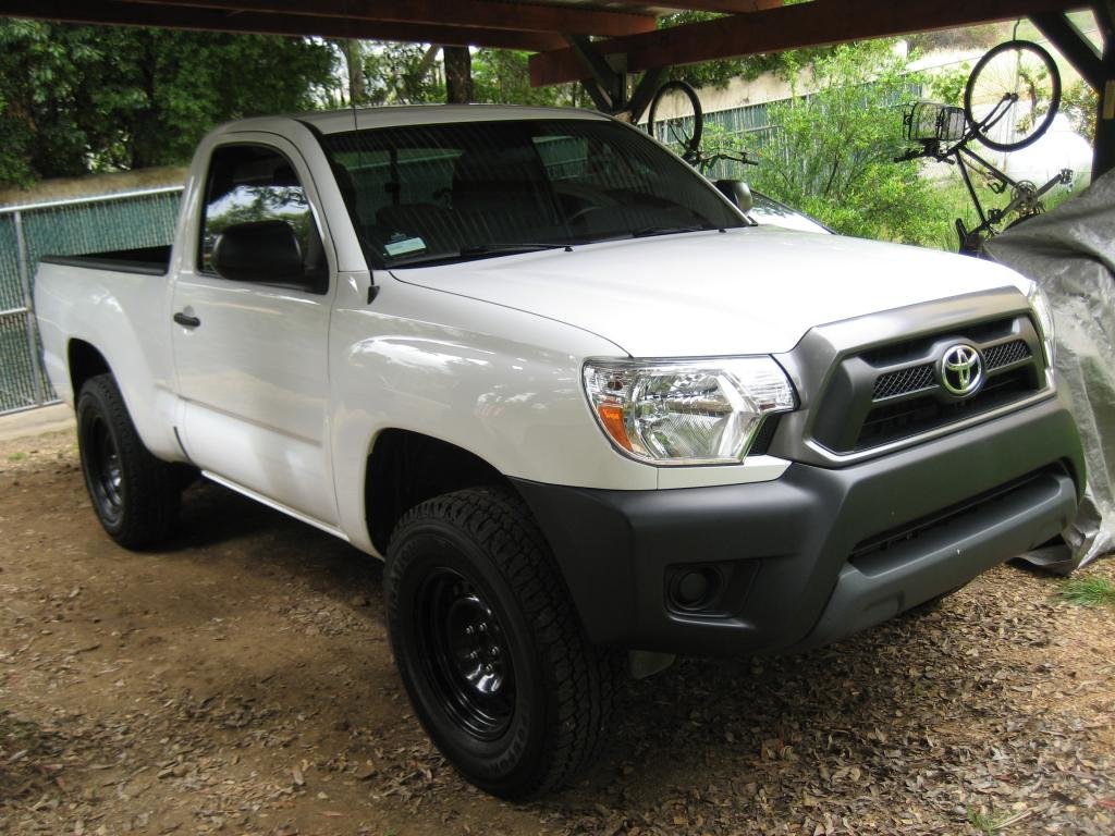

    These are only 1 1/4 inches thick and that's all they can lift because they're not spring spacers that compress the springs. Compare this pic...
    SOLD
    ...with the pic of the Fat Bob's and you can see that they are are thicker.
    They fit between the top of the whole strut assembly and the truck's body so the lift is only the thickness of the spacer.
    The first pic of my truck is with the ReadyLifts on, and the second one is with them removed. If you look closely, you can see the slight difference. What you see is all they can lift.
    SOLD
