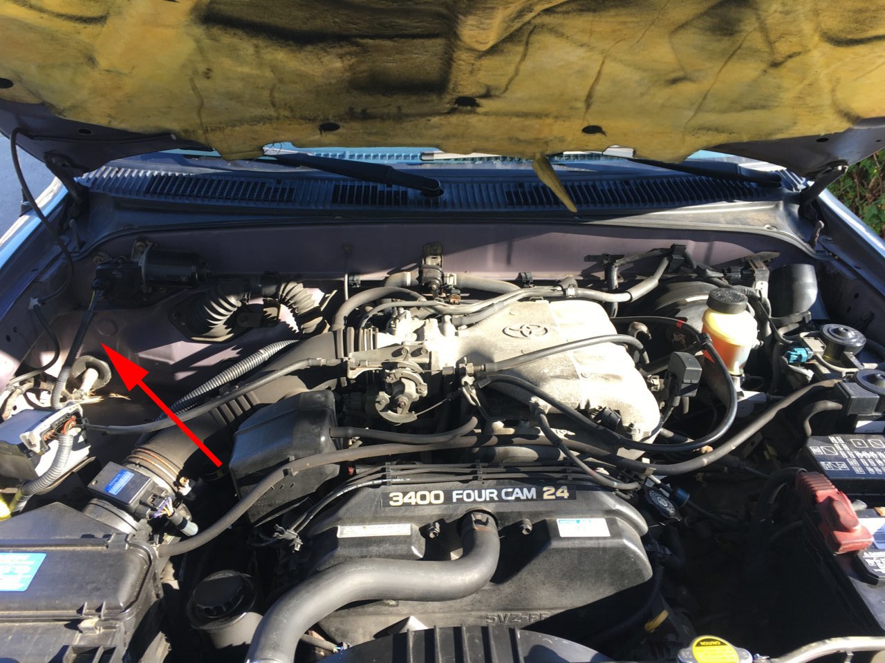

  17. Jan 3, 2022 at 2:56 PM

  18. Jan 3, 2022 at 4:57 PM
    #18
    MalinoisDad
    MalinoisDad Misanthropic dog person
    Jul 16, 2017
    #224205
    1,479
    Michael
    01 TRD PreRunner 5VZ
    5100s w/ 881s, JBA UCAs, J59s, other stuff and things
    The space where your ABS module should be is empty.

  20. Jan 3, 2022 at 7:56 PM
    #20
    Area51Runner
    Area51Runner Well-Known Member
    Jun 26, 2014
    #132748
    11,969
    Northern California, Bay Area
    02 3.4 DC TRD PreRunner 4WD SWAP
    If you had ABS, it would be here -
    and the module would look like or be similiar to this -
