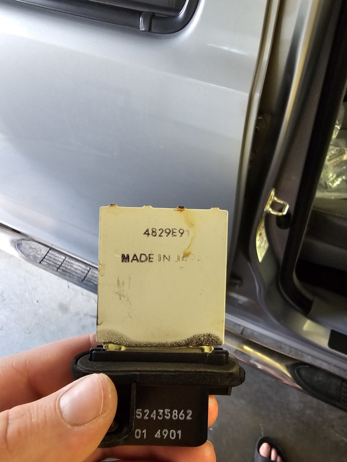

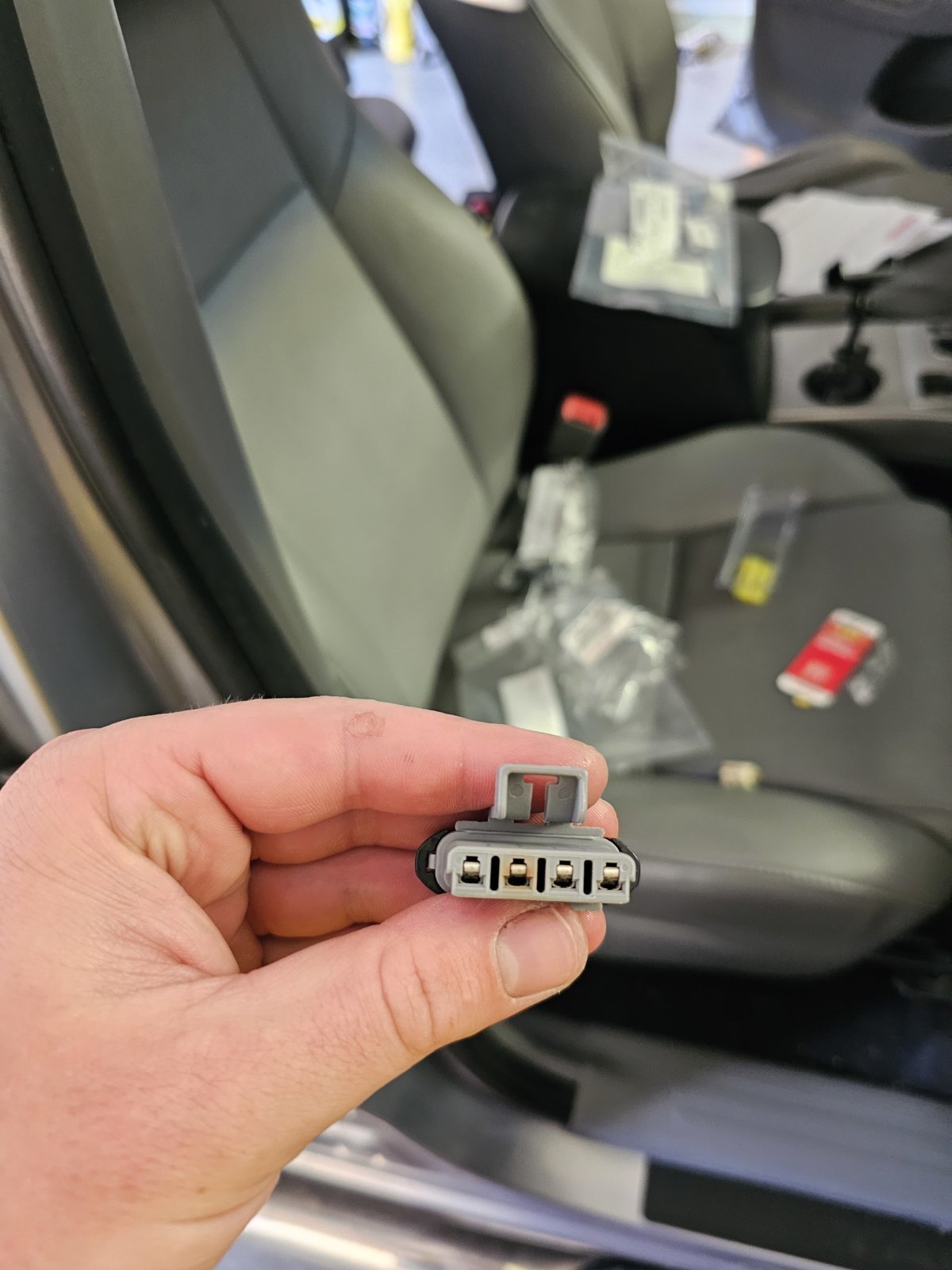

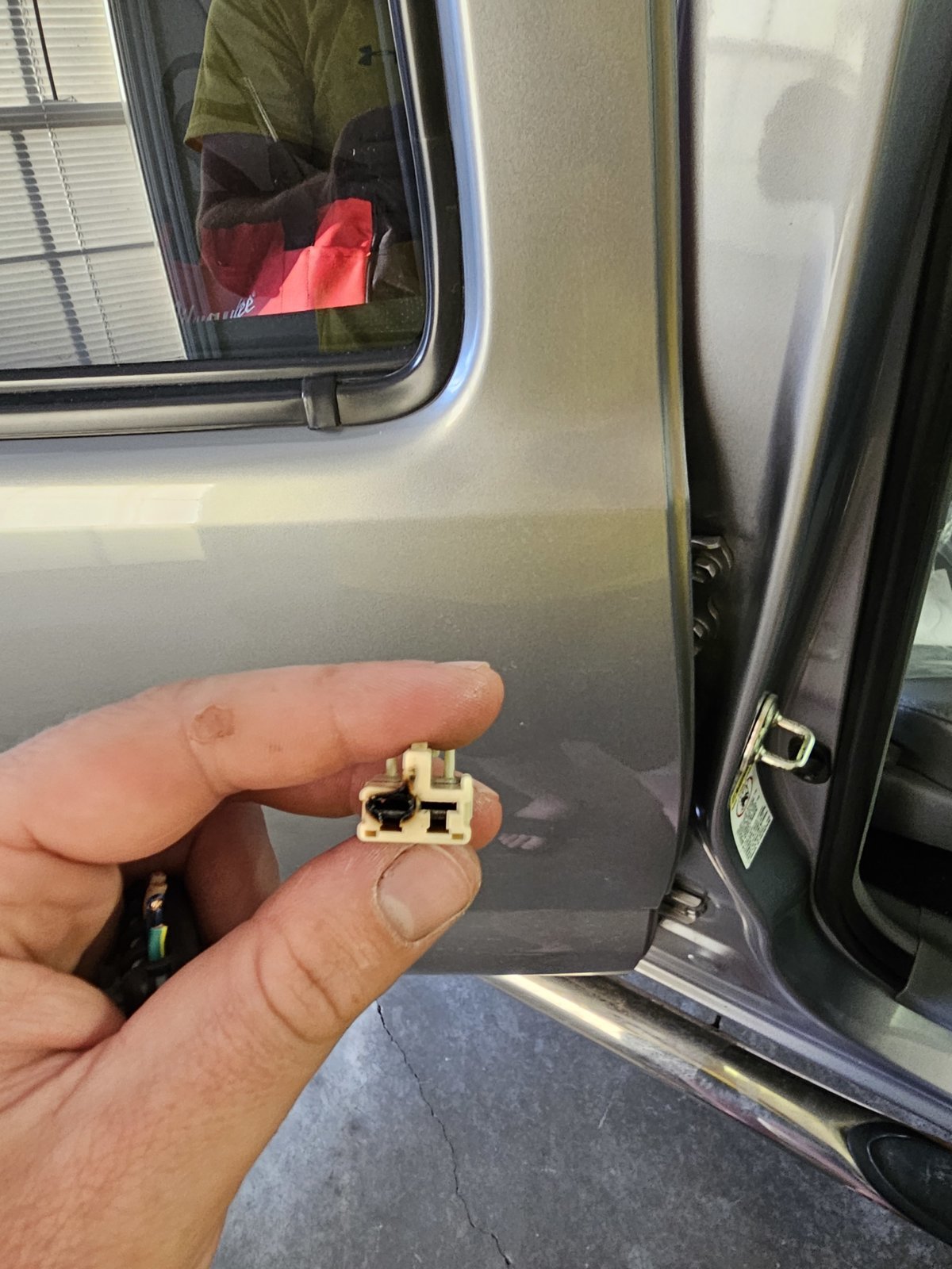

    Thanks, I'll fix it after work today. I'm lucky I'm the boss
  11. May 10, 2024 at 4:42 PM
    #31
    ToyotaMan2015
    ToyotaMan2015 [OP] Well-Known Member
    Sep 26, 2022
    #406713
    250
    Nathan
    Somerset KY
    2015 Tacoma Limited
    32in Tire
    My blower motor plug as I said is completely cooked. Just got that fixed. Now working on the resistor. Even it was starting to burn. Thanks dm93 for the guide. Didn't realize the colors on the updated harness are different. Having that in front of me is nice while doing this
    Dm93 likes this.

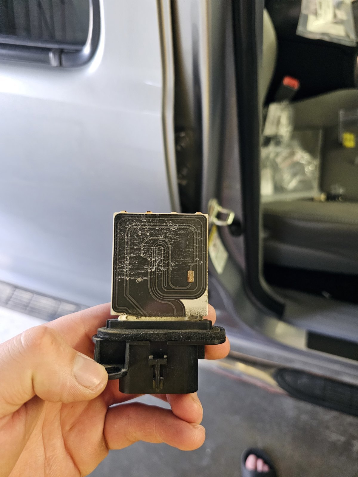

  12. May 10, 2024 at 4:47 PM
    #32
    ToyotaMan2015
    Sep 26, 2022
    #406713
    250
    Nathan
    Somerset KY
    2015 Tacoma Limited
    32in Tire
    You can even see were the resistor was getting hot.
    Dm93 likes this.
