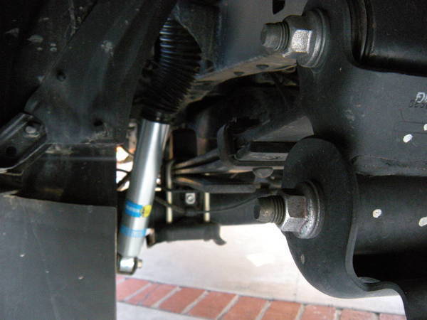

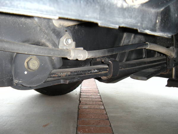

    my leafs are pretty shot. I was about to get the icon 3 pack, but now looking at the springs i dunno if i should just wait and save for the deaver 10 pack? what you guys think? Heres some pics

    Just score Toytec AALS for now & save for the others....mine were about that bad even tho I haven't been playing airplane with my truck, lol, and the AALs made it much better! Or suppose you could just get helper spring if no lift needed even cheaper.

    I did the Toytec AAL but now it seems to be losing it's arch. What's the advantage to the Deaver 10 pack? Does it give you lift like adding a leaf? Does it help with sagging in the rear when carrying a load? Will it hold it's shape over a longer period of time? Just wondering...
