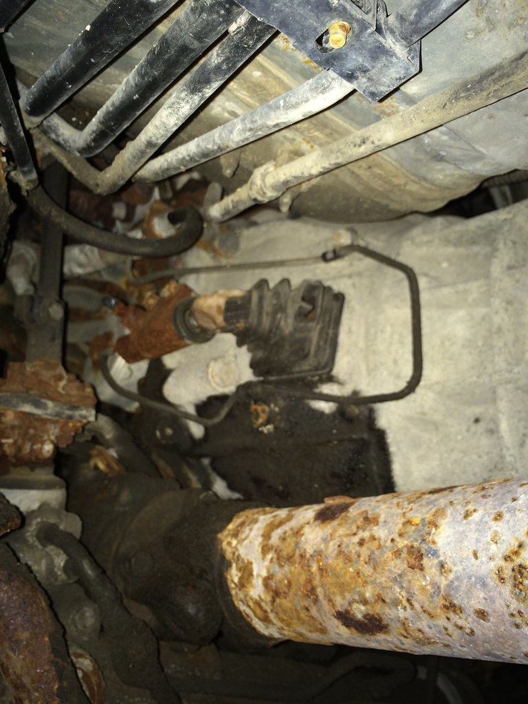

    I picked up a project truck and it needs some repair. It's a 03 4x4 v6 manual.
    First problem is there's zero clutch pressure. The p/o told me has had the slave replaced 60-80k ago but he believes that is the culprit again.
    Upon visual inspection there is a greasy area beneath the slave but the master is filled with some dirty looking fluid leading me to believe the slave may not be leaking and the grease may be from last failure. Are the slave and master the only possible culprits?
    Also the rubber boot on the arm the slave pushes on is not seated and I can see in the hole. Is this a concern?

    Can you have someone press the clutch while you observe the slave? You should see some movement, if not check for fluid pressure at the bleeder. That is a pretty good leak there.

    I will have to set up a camera tonight to see if the slave moves in response to the clutch.
    I'm picking up a new slave tonight and will likely slap it on. Is there any concern bleeding the dirty fluid through my new slave? Should I use a turkey bastor to get most of the dirty fluid out of the master before bleeding?

    I took the slave off and no fluid came out..
    There's still fluid in the master so I'm assuming it's pooched. Going to pick up a new one, fingers crossed.

    You should look real careful at the whole line from the master down to the slave.
    looking for it being crushed or kinked
    Because the fluid in the master reservoir should drain out once the line is removed from the slave cylinder

    While you are there , have a peek at the floor boards where the pushrod comes through the firewall . Thats another place well known for leaking .

    Replaced master and slave cylinders this morning and clutch is working well. Matching up threads from old push rod was key.
