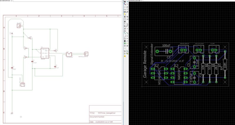

    For those that are interested... I have an issue (when it's hot and dry outside) where the range on my sunvisor clippy remote goes to crap. So I end up pushing it a few times as I get closer and closer to my garage until it works. Not a big deal, but annoying. So since I'm doing a mod for this truck, thought I'd make a little circuit to fix this problem. Basically this will sit between the custom mounted 'open' button (what everyone's showing as attached to the remote body itself) and the remote. When I press the open button this circuit will essentially latch it open for 5-7 seconds (haven't decided how long I want it open yet). causes a slight drain on the battery, but shouldn't be a big deal.
