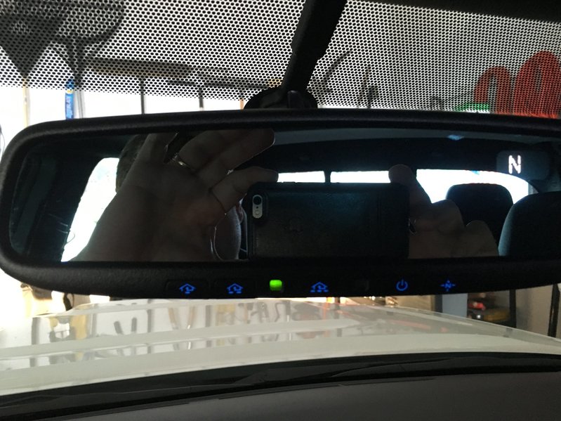

    Bought a plug and go with blue backlighting homelink, auto dimming and white compass, if you want the redundancy to the navigation. $155 delivered, looks great!

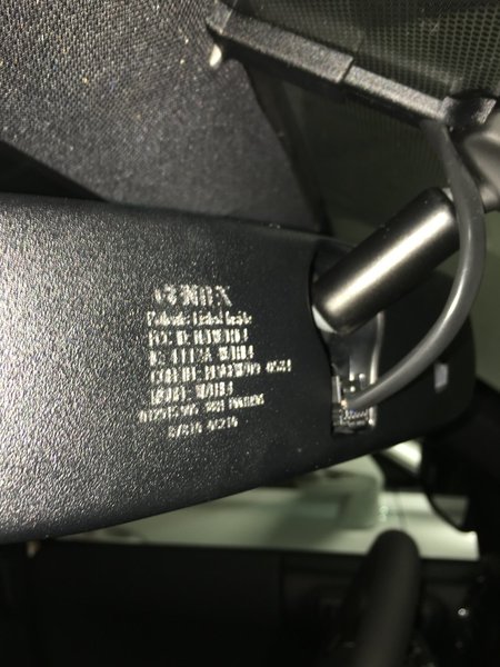

    Nice. Where'd you get it from?
  13. Nov 24, 2015 at 8:00 AM
    #93
    UAL777jet
    UAL777jet Well-Known Member
    Nov 2, 2015
    #168423
    298
    Bill
    Norwalk, IA
    2019 Tacoma TRD Pro Voodoo Blue
    TRD Performance Air Intake
    I got it from http://www.bobsmirrors.com
    Technically it was used, but it was just as good as the one I took out of my new truck yesterday. Same brand Gentex. Hopefully you can blow up pic to get model number. If it is 12 PIN it will work, but many options like green, blue or white on the compass. Also some models have back light like this one and some don't. Probably different color options on that also. Might be luck of the draw what he has available, he is also on eBay. Good luck!

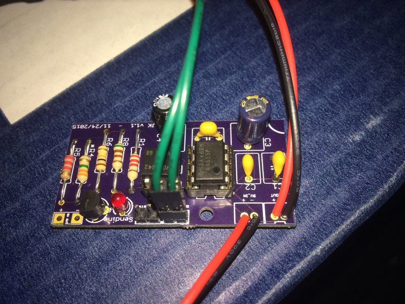

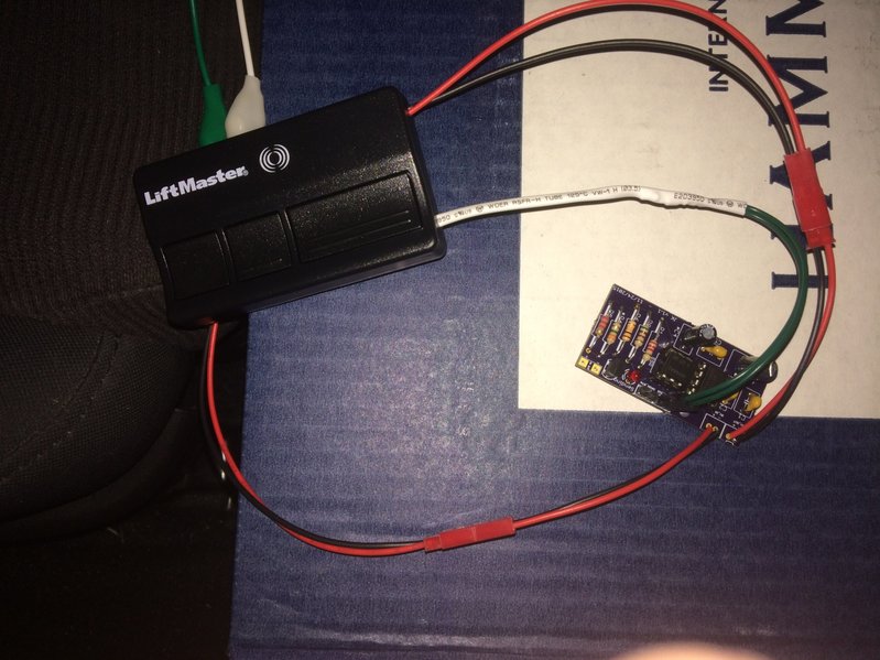

    Trial run of my little circuit was a success. Designed it to 'hold' the remote door button closed for about 8 seconds. Decided to add a regulated 3V out too so I can power the garage door opener remote (eg no more battery in the remote so no worries about draining it over time). Probably going to ditch the board and create a new one wrapping the garage door opener with other features (want to incorporate an Arduino or rpi into the truck at some point) but so far so good!

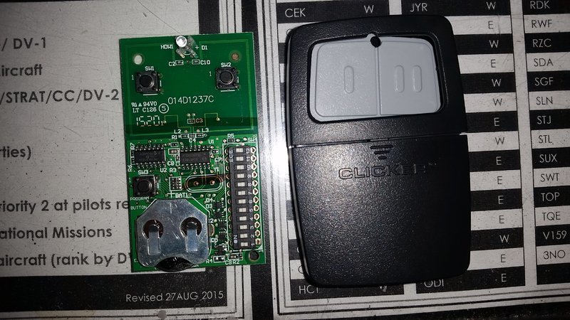

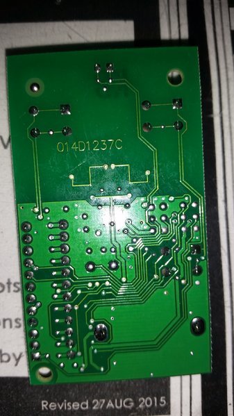

    So I'm doing this mod. Does anyone know which leads I need to connect to? I just flipped the board over for your reference if you can help. Thank you. 20160310_063945.jpg 20160310_064000.jpg

    I would recommend testing before you solder. Just stick the leads on and try until you find the right two. Probably diagonal from each other.

    Thanks! I did that and it worked great!
