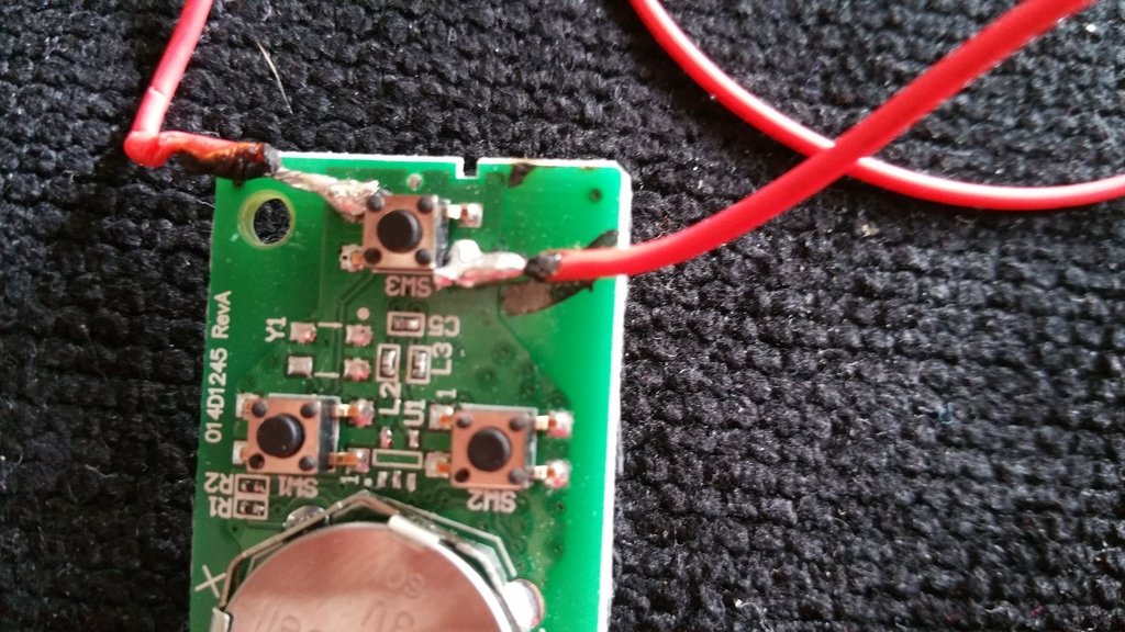

    This is a simple mod that I think is better than Homelink® as it opens the garage door without advertising you have homelink if you leave your truck out at night. I used this mod on my Bikes.
    See Smuglys version here later in the thread.
    https://www.tacomaworld.com/threads/no-homelink®-no-problem-first-mod.394920/page-2#post-11159336
    https://www.tacomaworld.com/threads/no-homelink®-no-problem-first-mod.394920/page-3#post-11167407
    Much cleaner but no direct access to battery

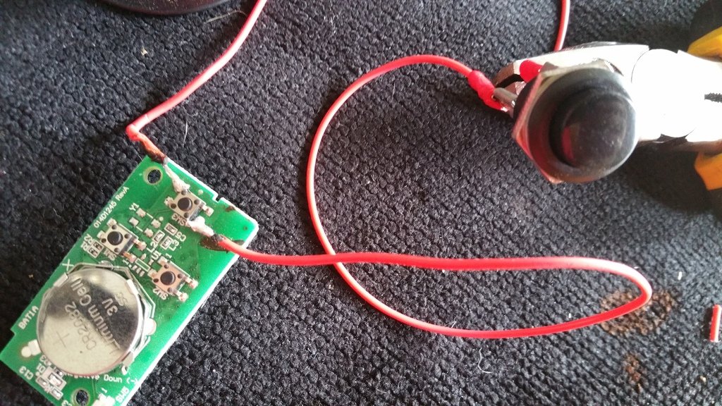

    I opened a small keychain Liftmaster® opener and soldered two wires to the momentary switch

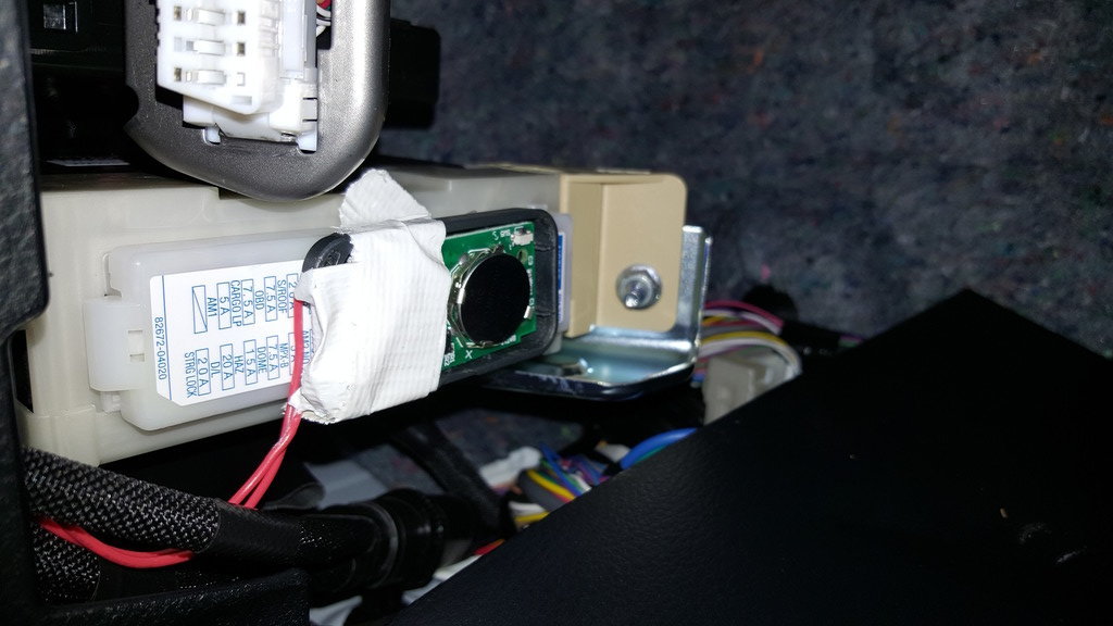

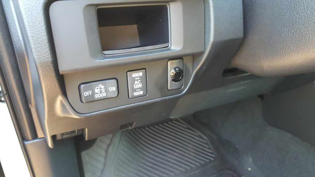

    Then I took out the blank to the lower left of the steering wheel (for those who have one there unused) And drilled a hole to fit a momentary switch. I slipped the opener in the blank hole and attached the wires to a couple of small phillips terminals on the switch. Put the blank back in and taped the opener under the dash with the battery exposed for easy changing.

    I did NOT use the switch in the following picture I used this one bought Amazon with the tiny terminal bolts to hold the wires,
    I did not need the rear bolt on the switch. I just pushed and screwed it into the blank and cut one side off to get at the terminals. Taped the opener under the dash on the fuse box with battery access. I may find a better place for it later/

    The hardest part was drilling the hole in the blank large enough. Had to use a dremel to finalize te size. If I had to do this again I might get a smaller momentary switch.
