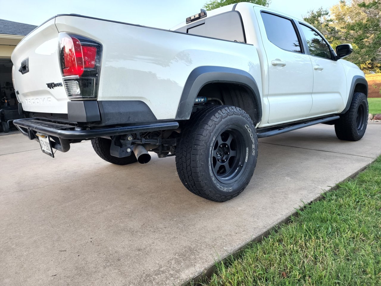

    first question i have for you is would you describe the rear's ride harsh and/or jittery? this has been discussed many times and the first step in solving that would be Archive Hammer hangers for the rear shackle mounts. those will remove the harshness and jitteryness. that may not be complete, however, and your suspension may require more replacements depending on your truck's setup. here's a pic of mine with those and a mild 5/8" lift on 31.5" tires.

    @su.b.rat - I wouldn't describe my rear suspension as harsh or jittery. It is fine during street driving until I hit a change in pavement height and then it feels soft. When going slow through bad washboard or dirt roads with deep pot holes it feels soft and any sudden drop results in a loud thud and what feels like it hitting a sudden stop.
    I will read up on these hangers and see if they might help. Thank you for the recommendation.

    you bet! what you describe sounds like it would benefit from those hangers, read up here: https://www.tacomaworld.com/threads/hammer-hangers-by-archive-garage.519625/
