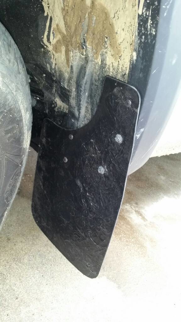

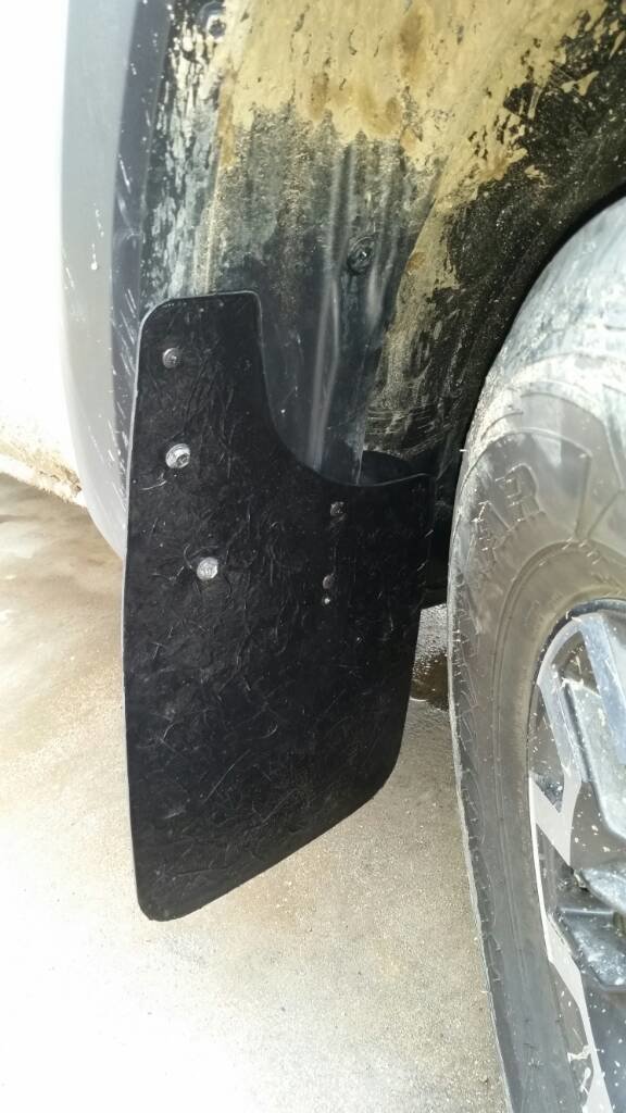

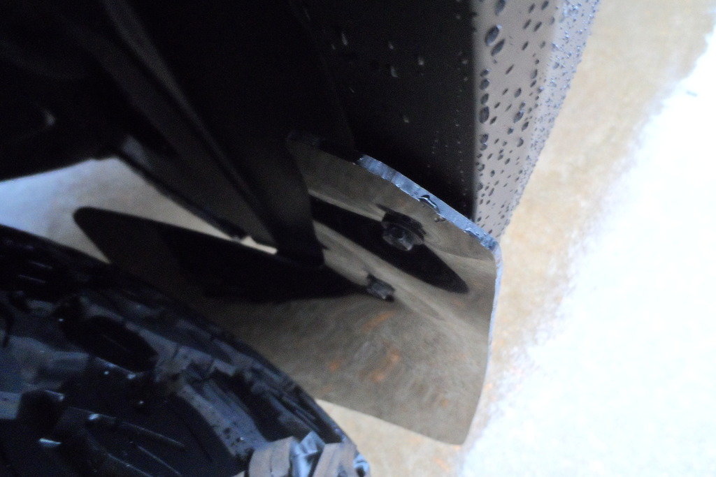

    I did one self tapper on the top and 2 self tappers into the plastic near the inside edge. Just be careful you don't instantly spin them and kill the holes you make. I have a picture, hang on. i did that to front and back

    Front
    We'll, these are both fronts

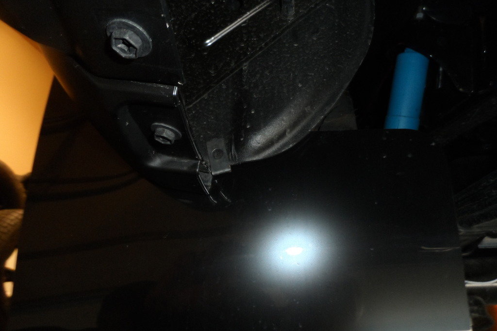

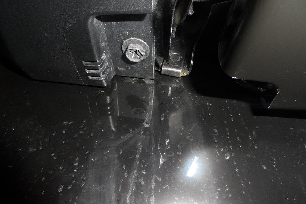

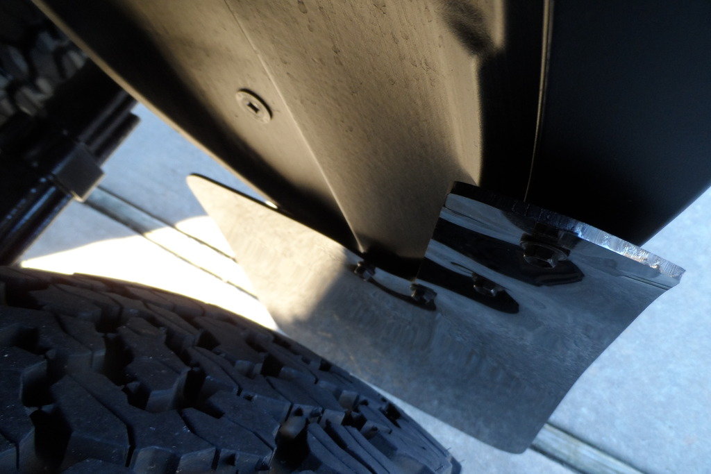

    Here's what I did.
    U-clip front
    Front before
    Front after
    U-clip rear
    Rear before
    Rear after

    You'll need to reach around and push the plastic to the head of the screw so it cuts through. It's soft plastic so it will bend away. And don't drill too fast when it catches or you'll strip it right through
    If one ever pulls through I'll just put a washer and a nut on the back

    Also, have someone stand behind the truck to make sure they are angled and positioned correctly before you even mark the hole locations.

    These are 8.75 inches off the fender in the front and 9.25 inches off the fender in the rear. They sit about 8.5 inches off the ground due to rake.
    These were installed AFTER going through mud at Cleghorn. I just hosed the fender out and not the rest of the truck

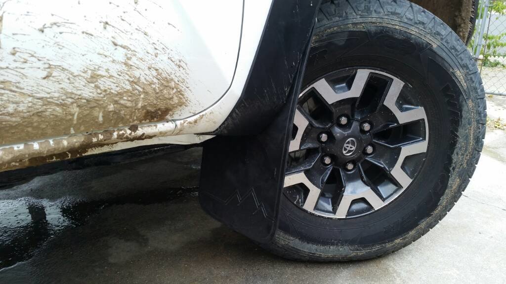

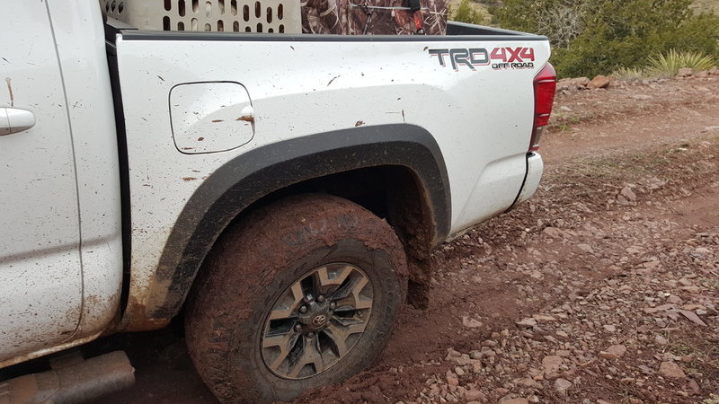

    Took another trip this weekend this time up on San Carlos reservation. Had to cross a good size Creek 6 or 7 times throughout the day. Had water up to the bottom of doors and no leaks. Plasticolor Flaps did their job! All in all about 60 miles of off pavement driving that day. Shot plenty of quail
