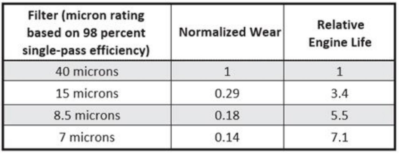

    Many owners would say the bigger issue is the micron level of filtration for standard filters (non synthetic). I'm not sure the micron level of all the different filters, those nutty lube guys at BITOG probably know.
    But, silica dust is an average 10 microns in size, so if you live in a dusty area or gravel road it'll just pass through the filter. That's why most all modern oils, even dino can go 10k miles and beyond with good filtration. It doesn't wear out by 10k miles, just gets polluted with contaminants in the oil (silica, gas, coolant, etc) and the TBN falls.
