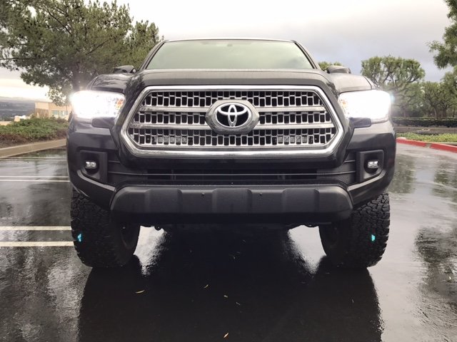

    The Truck:
    2016 DC Short Bed
    4x4
    Tech Package
    Bed Cover
    Work:
    Front:

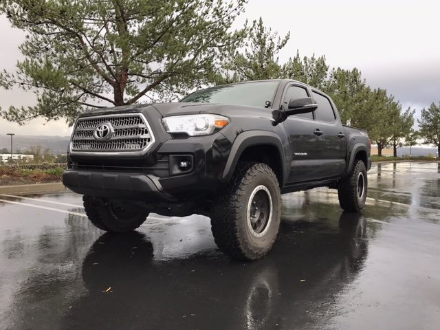

    - OME 2885 Coils + 2 Driver Side Trim Packers
    - OME Nitrocharger Sport
    Rear:
    - Toltec 1/2 Block w/Stock U-Bolts
    Wheels/Tires
    - 16" Method Double Standard's
    - 285/75R16 BFG All-Terrain Tires
    Headlights: LED Only - 110W H11 Bulbs
    https://www.amazon.com/LEDONLY-H11-...srs=13889482011&ie=UTF8&qid=1480208763&sr=8-2

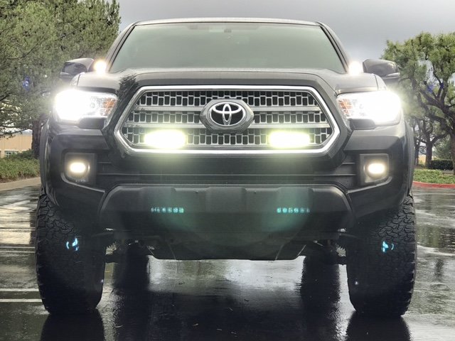

    Puddle lamps: Rigid A-Series - Low Power
    - Wired into the door switch.

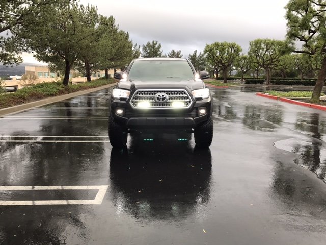

    Grille Lights: Rigid SR-Series 6" Spots

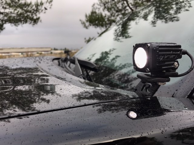

    Ditch Lights: Rigid Ignite - Spot
    - Brakets: https://www.ragofabrication.com/products/2016-toyota-tacoma-ditch-light-brackets

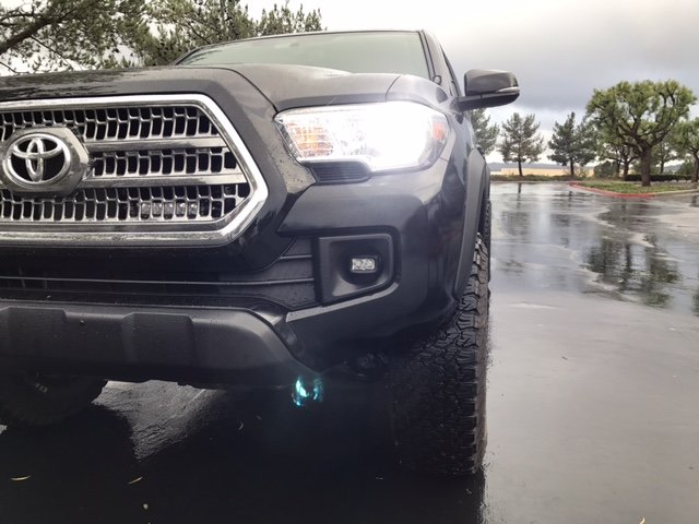

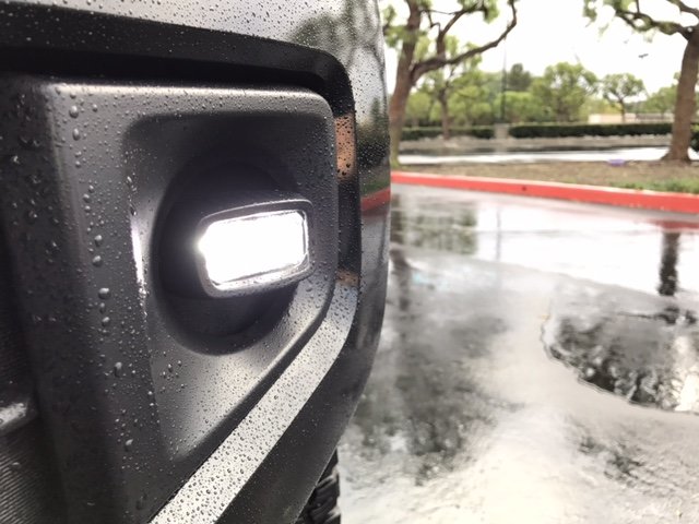

    Fog Lights: Rigid SRM Spot - Wired into the Factory Fog Switch
    Brakets: Custom

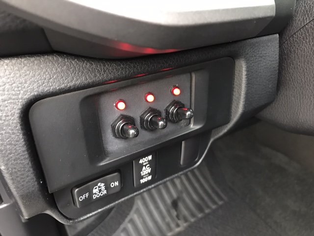

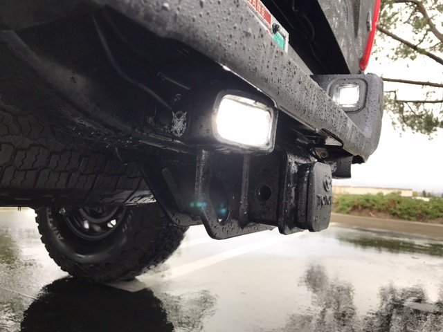

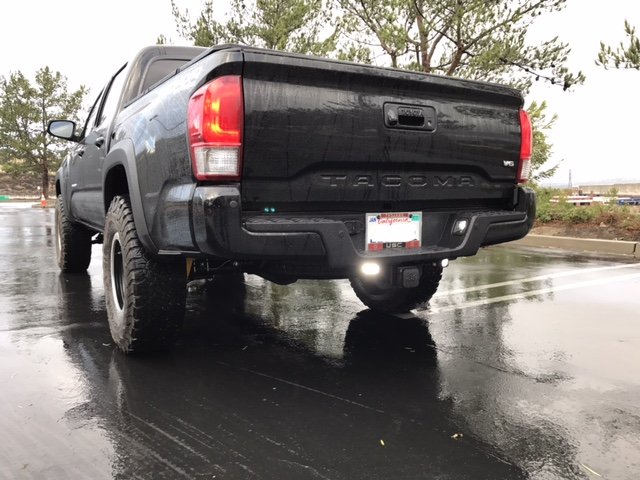

    Rear Lights: Rigid SRM Flood Wired into a (2) Position Switch
    1. ON
    2. ALL OFF
    3. ON w/Reverse

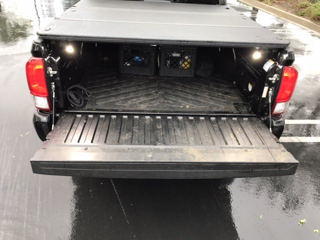

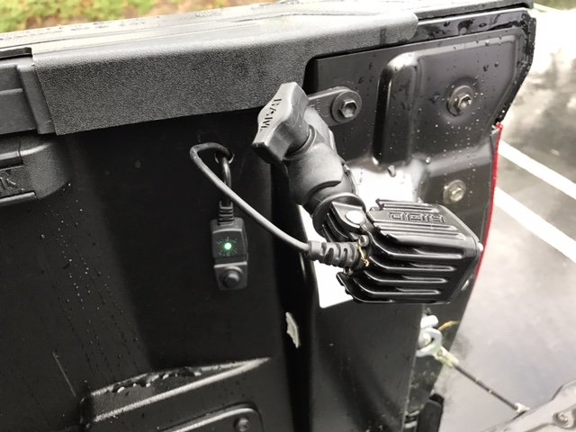

    Bed Lights: Rigid Ignite Difussed
    - Mounted using Factory Bolt and Ram Mounts

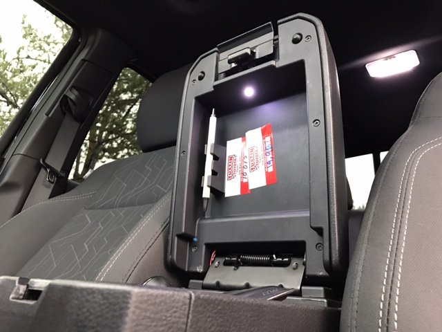

    Glove Box Light: Wired off the 12V Outlet
    https://www.amazon.com/gp/product/B01ADHUXGU/ref=oh_aui_search_detailpage?ie=UTF8&psc=1
    Factory LED (Same LED over the Qi Charging Pad)

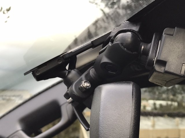

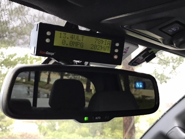

    Scan Gauge Mounted Over the Mirror using Ram Mounts
    Next Up:
    - Leer 100XR
    - 7ft Roof Rack
    - w/Roto Pax, Shovel, HiLift, Zombie Apocalypse Equipment, Ect.

    I've been a huge fan of the rigid ignites ever since I got them for ditch Lights. Their output for how tiny they are is crazy.
    What is that thing yours are plugged into in the bed? Looks like a 1"x3" box with a button and green led

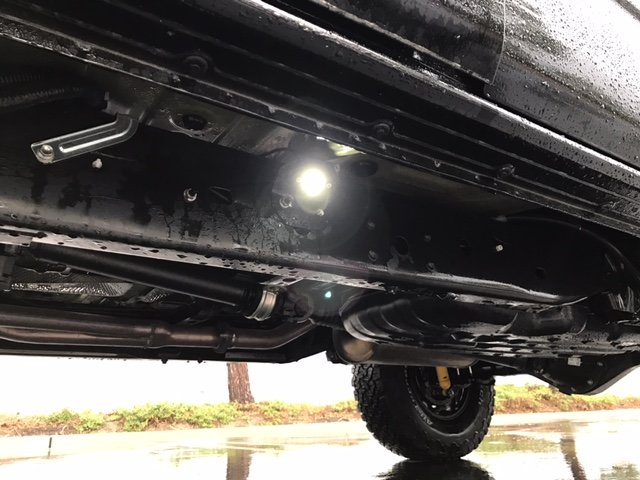

    I agree, the Ignites output is beyond what I expected. Puts my SRMs with 2 LEDs to shame.
    That little box is the switch for the lights mounted in the bed. I run my dog at night so I needed some light on the field.

    Nice truck man, I like the floor lights in the back. What tint % did you get on your windows? They seem to match nicely.

    hey Jeff, that's a sweet truck looks great!! I like the lights. I have a ton of questions. How did you mount the rear flood lights?

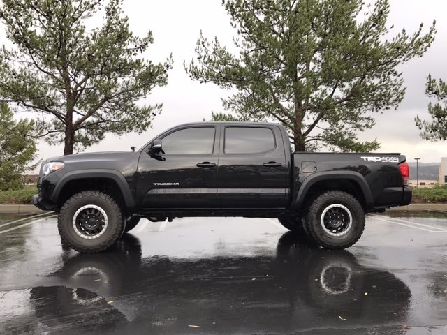

    Noob question here, any rubbing with the lift and tires? I would love to do the same. Lastly, what does this mean "+2 Driver Side Trim Packers" TY

    Thank you! Its 15% on all windows, except the windshield.
    Thanks! If we are talking about the lower, reverse lights below the license plate: There are 2 bolts that thread through the bumper and there is about 3/4" thread exposed, I used a nyloc nut and mounted them to that! I found the nuts in my collection of hardware, so I am not positive on the size.
    I rubbed just a little, typically in reverse. I am also not running my sway bar, so there is a lot more movement of the front wheels, especially in articulation. If I used an aftermarket upper control I would have been fine because they build more caster into the arms which pushes to tire further towards the front of the fender, keeping it off the body mount/fenders. When I say +2 Driver Side Trim Packers, I am referring to these. They are used to even out the lift, Tacoma's like to lean to the driver side. These spacers go below the coil on the shock to prop up the spring, resulting in more lift.

    What do you think about your fogs? Can you post an output pic of them? I was thinking of getting a pair of them for my fogs, but driving pattern instead. I'm even more stoked about them since they came out with there PRO like that's 170% brighter than the older ones:)

    Interested in your lighting setup in the rear... backup lights with 2 position switch and your bedmounted lights. Any specifics on that? Or tips on how to run the wiring from the battery? Or did u just run off the taillights? Thanks a bunch. All I’ve done so far are dual side facing floods and would like to do another flood facing the reAr.

    Truck looks sick man! Who made those fog light brackets?
