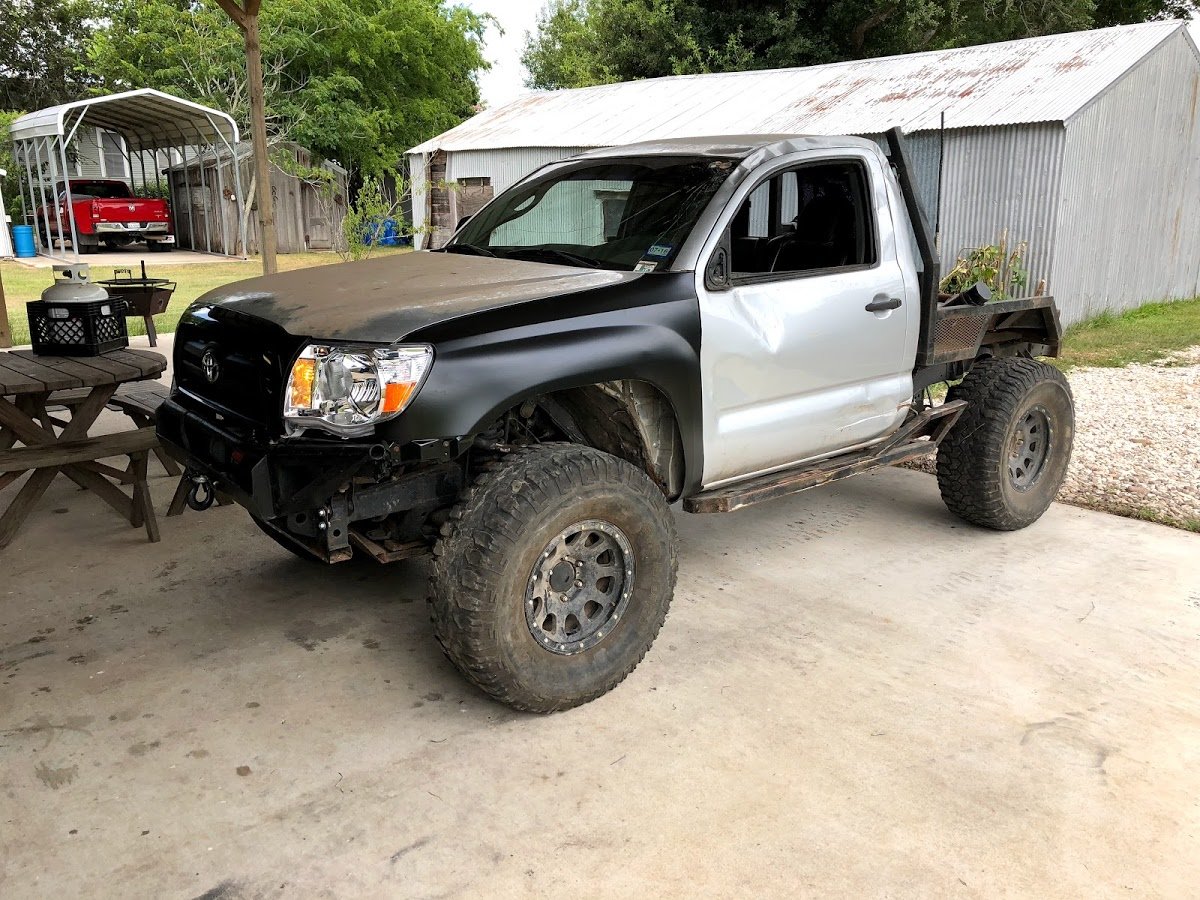

    Kase had the door so i did some bending of the hinges to get it to latch again.
    6Hs32_5twTTAPm5N9OGMoxj0IAcxg9ZLh4beXbVz_184bb2d36764d448fb5dbc723d62712427141def.jpg

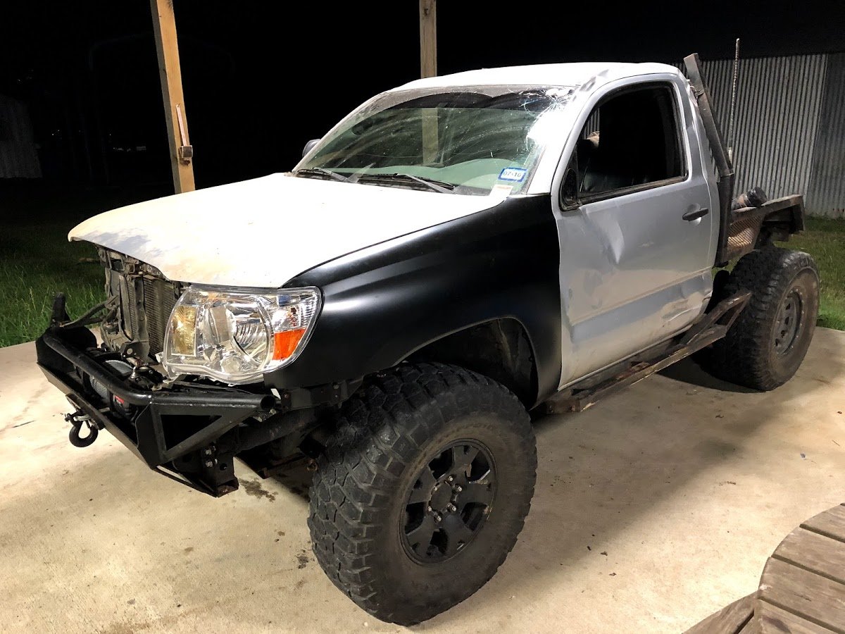

    Front end re-installed.
    ad_DXZ7bYA3iaoLHBfIHE2ZqAT92yO_qOoMJPkWX_d4138a2ca48ff03267a53f8f8ecba78253e77110.jpg
    Trimmed about 2" off the fenders to clear the 35s at full lock. They will be trimmed much more once the SAS starts.
