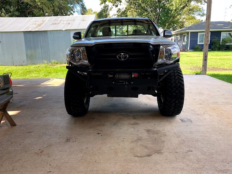

    New diff went in and drove the truck around for the first time. Not bad. Expected some wobble, but drove nice and straight. It does have some ticking coming from the top end so a valve job is in order. It looks mean with the new 32s.

    New windshield and back glass are being installed today in the Taco. Also the 37s have been mounted and are going on this evening. Cant wait to see how it looks with the powder coated FJ steelies.

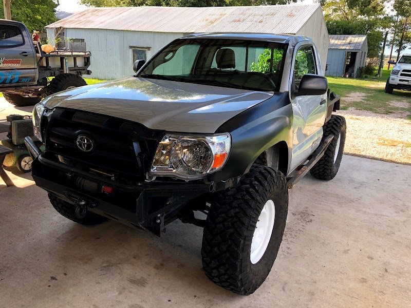

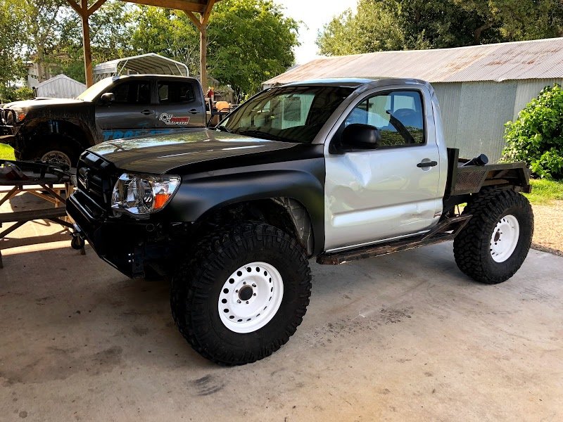

    A few things happened yesterday. My windshield and new back glass were installed without issue. Now i can easily get it inspected after a little exhaust work. Also mounted up the 37s. This is when i noticed the issue on the passenger side. As you can see in the last pic, it is cambered in hard at the top. So much so, that it contacts the UCA. The drivers side doesnt do this and has plenty of room lock-to-lock to not hit anything. Its close, but doesnt. I crawled under and noticed the alignment tabs were flat on all 4 tabs (passenger and drivers side). Apparently this is a common issue. Even with adjusting them all the way in, i still couldnt get the camber fixed enough to not touch the UCA. This leads me to believe the spindle is probably bent from the roll or from wheeling. A wheel spacer would fix the rubbing on the UCA, but is a band aid IMO. I also need new lug nuts as the ones on there previously have too much shoulder to work with these FJC steelies.
    So my solution is to weld some of the TC alignment tabs onto the LCAs and try to get an alignment done to confirm the spindle is bent. If it is, Nathan @SMKYTXN says he has a set of spindles left over prior to his SAS to hold me over in the meantime. It sure looks mean though with the 37s. Cant wait to get a bed on it and see how she looks.

    After some work on the truck the last few days, i finally took it for a test drive on the 37s yesterday. Since the spindle was tweaked on the passenger side causing some ugly stanced camber issues, i took it all apart and applied some heat and some press to it. The result removed the camber but for some reason still caused the tire to contact the UCA. I didnt have this issue on the drivers side. After some more research im sure the LCA mounts are also tweaked.
    So in order to fit the tires, i had to use some 1.25" wheel spacers that Nathan had. I HATE wheel spacers. Had a bad experience once on my crawler and i try to avoid them at all costs now. The spacers now caused a new issue...the tires got into the firewall now when turning. A little BFH and some cut off wheel action took care of that for the most part. I still rub on the passenger side a little when cut hard and reversing. nothing on the drivers side. Once again im sure something is tweaked over there. It did drive nice and straight though for the most part. Got it up to 65 without issue. The 4.88s help, but its still slightly under powered. I may fix that later. Overall im pretty pleased.
