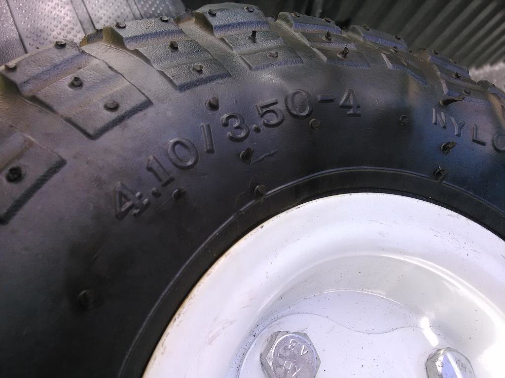

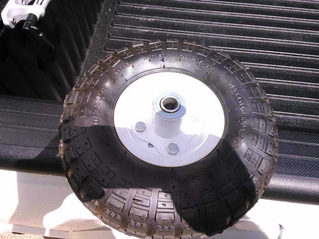

    To remedy your TPMS light issues, from not having the sensors installed... This is a $6 fix in takes 5-10 min.
    Go to Harbor Freight and buy this wheel/tire:
    Haul-Master - 10 in. Pneumatic Tire with White Hub - 30900 Deflate the tire
    Unbolt the (2) halves of the wheel
    Insert the TPMS sensors between tube and the tire's sidewall
    -make sure the sensor side (soft side) is against the tube
    -make sure the casing side (soft side) is against the tire
    Reassemble wheel
    -make sure the sensor isn't touching wheel
    Inflate to desired psi...
    -Place behind or under seat in vehicle
    TPMS light should go off within moments
    -no harm to sensors or vehicle
    I had to do this because I upgraded from my original 16" steel wheels to my 16" TRD FJ Trail Teams wheels... there are seperate TPMS sensors for OEM steel and OEM aluminum wheels. The sensors are attached to the wheel at different angle. Similar issues may arise with aftermarket wheels. This is a way to turn the TPMS light off.

    This is not the same
    -The tire has a tube in it, that presses against the sensor
    -The pipe bomb mod is rather dangerous, dependent upon your abilities and materials
    Mine has been great behind my seat since June, no pressure loss as of yet.
    Additionally, the tire just being in the cab will greatly increase the longevity.
    ...I also have these wheels/tires on a tricycle for my niece and nephews to ride when they come over. No issues with those since install in 2010

    Yes, you just slide the (4) tpms units in between the tube and the tire (making sure the soft side of the tpms unit is against the tube).
    Then inflate to 30+ psi
    Then place in truck and wait a few sec.. light will go off
