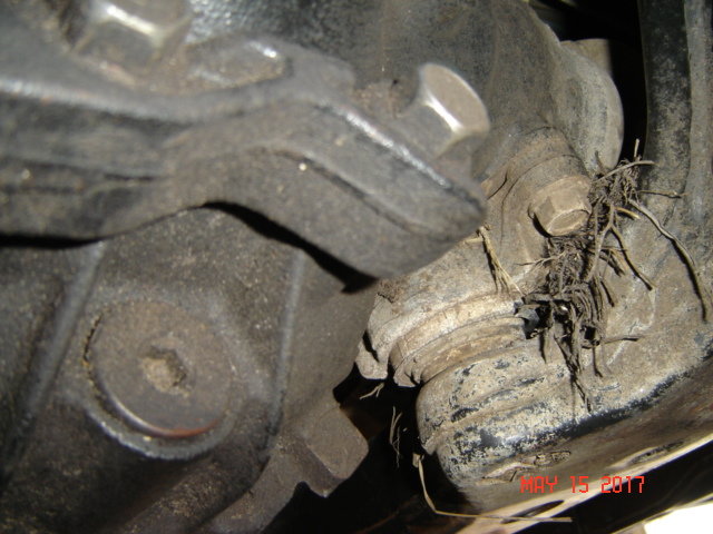

    Thanks for the URL’s to the pictures but all of those appear to be on the back side of the axle. Our unit is on the front of the ale and very close to the front cross member has anyone here removed one like this?

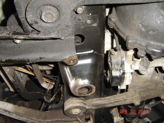

    Hi here are some pictures.

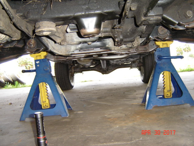

    I said I was a heavy equipment guy do you think those jack stands will hold the front of the Tacoma up?
    This is the front axle of our 2010 Tacoma. It just doesn’t look like I can get the actuator out.
    What do you all think?

    Pull the two front bolts that hold the Diff up and let the Diff hang down. You can then get the actuator out. 30 minute job to get it out and back in.

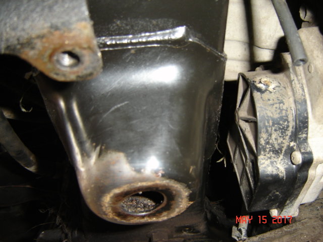

    here are pictures will i be able to get that unit off now?
  14. May 15, 2017 at 8:17 AM

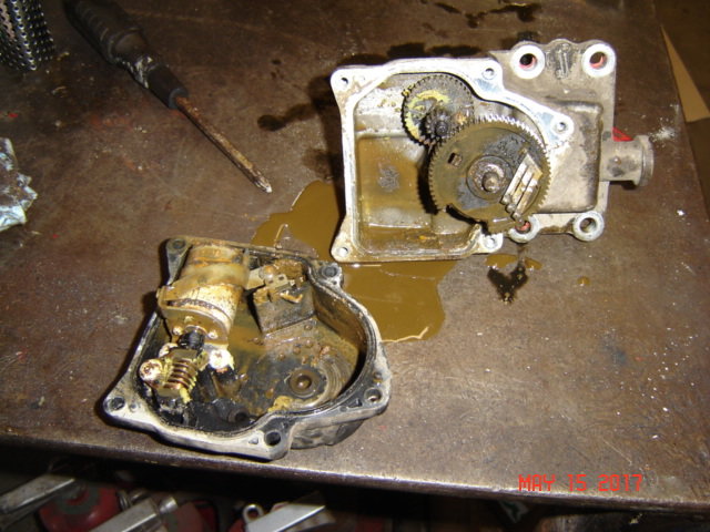

    I got it off I dont think there is any repair for this one.

    Worth giving a shot. Spray it out with brake cleaner, wipe it down, run 12v from your battery to the motor and see if it spins. If so, check the swipe arms that make contact on the contacts on the black cover. Bend them if you have to to make sure they make contact. Wipe the contacts real good to get rid of corrosion. If not, then buy a new one
