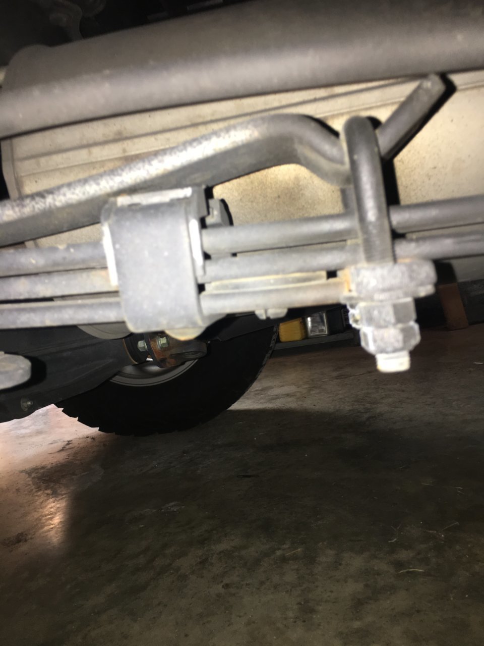

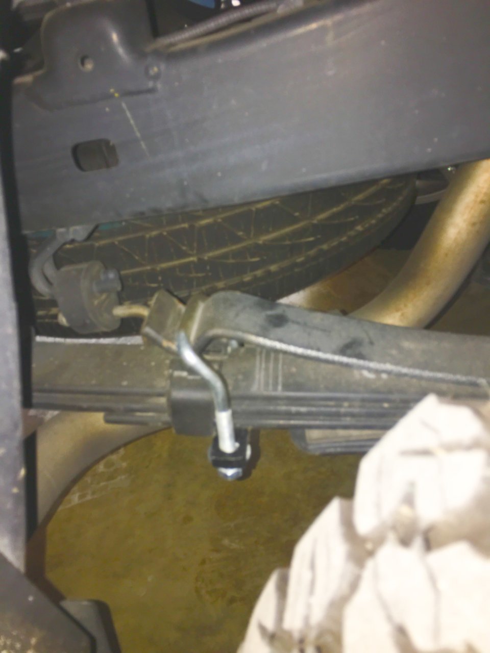

    I dont mean to crash the thread but I have a related similar issue with my 17 TRD sport access cab 4x4. I had no noise from OEM setup. @ 5k miles I installed a pair of Hellwig EZ-980 kit “add-a-leafs” to the rear.
    A slight fitment issue with insufficient clearance between the OEM Leaf “band” on the stack and the Hellwig U-bolt plate caused me to email Hellwig.
    They responded instantly with a box containing a U-bolt with a bit more bend or offset. This placed it far enough past the “band” so I could tighten the plate bolts adequately - and I thought all was rosey.
    Then the problem appeared. Whenever I take off “spirited” from a stop, the momentum shift rearward causes a “clunk” on the right rear springs only.
    I have triple checked everything, looking for springs rubbing or binding, bolts too loose, bolts/hardware interfering, and even compared the right installation to the left rear - and I see no potential issue or signs of a possible cause.
    AI have been unable to reproduce the noise by rocking etc. in my garage, so it’s tough to troubleshoot “real-time”. I now have 11k miles on the truck.
    I sent pics to Hellwig and have not received any reply as yet - other than saying they forwarded them with my description to their eng team.
    There are many posts everywhere about squeaks - but this is no squeak. It only happens when I take off with enough torque to shift the load rearward. No other ills are happening and the kit rides and handles with/without loading - perfectly.
    I would love to hear of anyone else experiencing this - and hopefully a hack to fix it.
    I found 1 possible post with a similar description - where the guy made some isolation rubber shims and inserted 2 on each end between leafs, on both sides of his truck.
    But I am uncertain that this was the same problem. Again - It only effects the right side.
    Thanks for reading. Rear/forward ends of the stack shown in pics below. A78C1C86-5744-4A7C-9663-ECACDA7BDDF4.jpg2B40027F-8ABC-4438-9486-30030B778194.jpg

    That looks weird to me. Maybe that's how helwigs are supposed to look

    It is correct. They are installed over top the OEM pack and under bump stop. The OEM U-bolts securing the set to the rear axle tubes are first removed and re-installed after sliding the AOL in place. Then the two Hellwig offset U-bolts are installed as in pis at each end of the stack.
