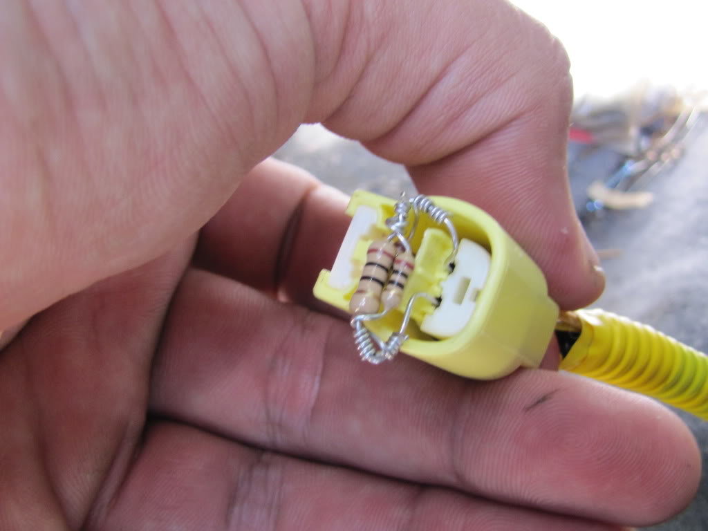

    I've been wanting bucket seats ever since i bought my truck. The problem i ran into was that the 09-10 tacomas come with airbags in the seats. I read around that a resistor of 3.3ohms will trick the system into believing the airbag is fine.
    I found this was successful about 50% of the time. Well, i learned the trick is to disconnect the battery before you unplug the airbags. if you dont and the light comes on they wont go off until you have the system reset by the dealer.

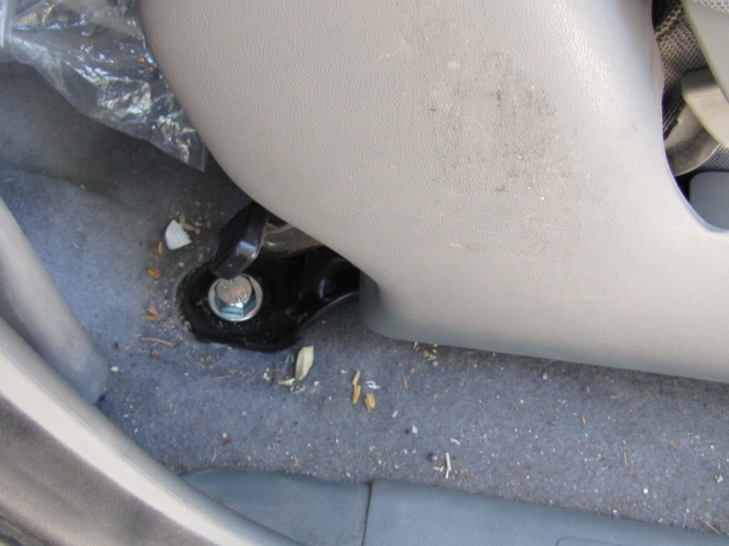

    looks good man......holes for the bucket seat tracks were under the carpet already?

    yep!

    all i did was to but $3 worth of 10ohm resistors. 3 10ohm resistors paralleled gives you 3.333ohms. Perfect to "trick" the airbag system...

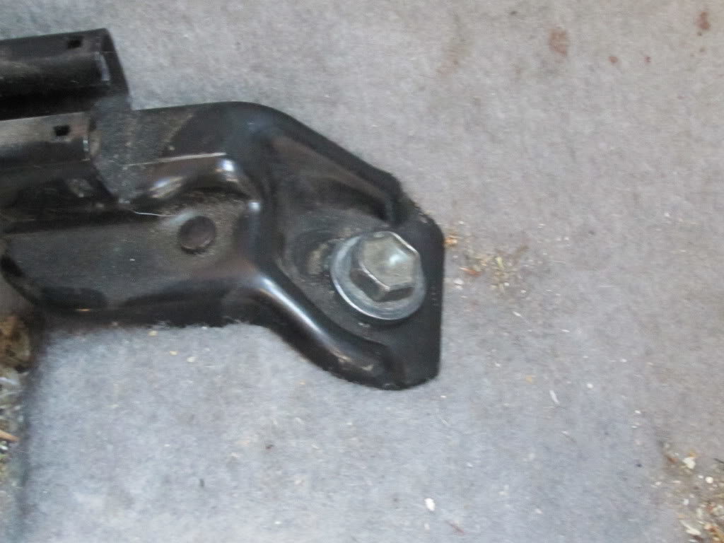

    so all the mounting holes are under the carpet. i cut holes just larger than the bolts...

    to trick the airbag sensor you need to put in a fake airbag (3.3ohm resistor)
    i didn't solder but will when i get a chance i used 2 1/4w and one 1/2w resistors for each "airbag simulator". Some companies charge 25-30 dollars for one. (i used the 1.2w resistor because it fits snug in the pin holes of the connector)

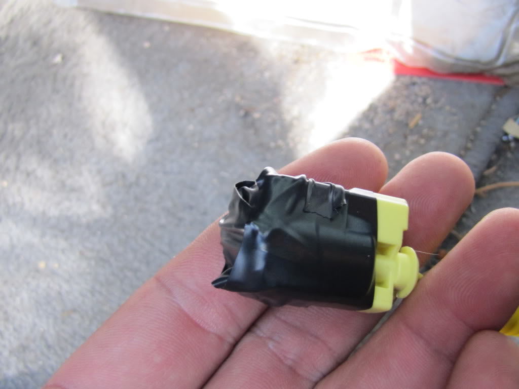

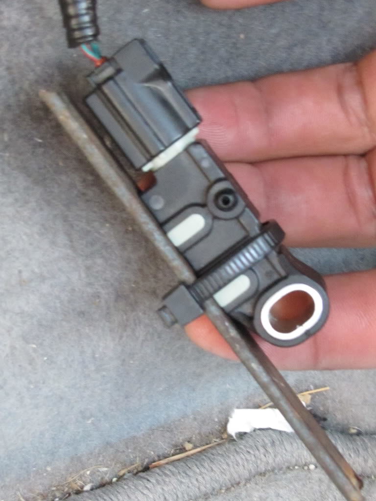

    one thing i had to do is use a torx bit to remove the rail sensor. this sensor turns off the airbag if the seat is too close to the dash. not really necessary since i cant drive with my seat any notch other than all the way back so i disabled it with a seat rail simulator. The way it works is it uses magnetism to send pulses like a position sensor through the metal via magnetic flux as the connector. so all you need is a piece of steel to complete the circuit.

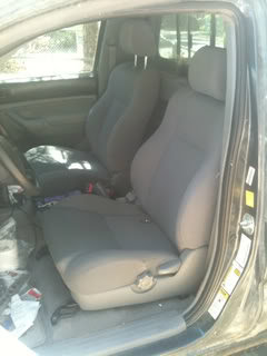

    oh, btw heres the final picture i apparently never posted

    what size bolt did you get and is that metric? grade 8 bolt?
