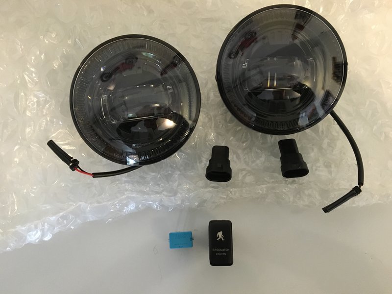

  18. Aug 25, 2018 at 10:17 PM
    #78
    the macf
    the macf Well-Known Member
    Jan 7, 2010
    #28916
    339
    Daily Driver - 09 RCLB Barcelona Red base, Sold - 08 BSP X-Runner TRD SC 332rwhp
    I’m stuck and need help.
    2009 base no factory fog option
    Ordered some TRS led fog lights and an Amazon harness and switch and add a fuse.
    Wired everything up and double checked all connections.
    I used the add a fuse in slot number 5 (power outlets) of the dash fuse box. I am still getting power to dash outlets so I know it’s good. Ground wires all have solid connections to bare metal. Still nothing
    My switch isn’t lighting up nor do I have power to the fogs.
    https://www.amazon.com/gp/aw/d/B0717BBGBN?psc=1&ref=yo_pop_mb_yo_pop_mb_pd_t2
  19. Aug 25, 2018 at 11:43 PM
    #79
    the macf
    Jan 7, 2010
    #28916
    339
    Got power. Needed a second fuse.
    Except now it’s constantly powered despite being on a keyed fuse slot.
