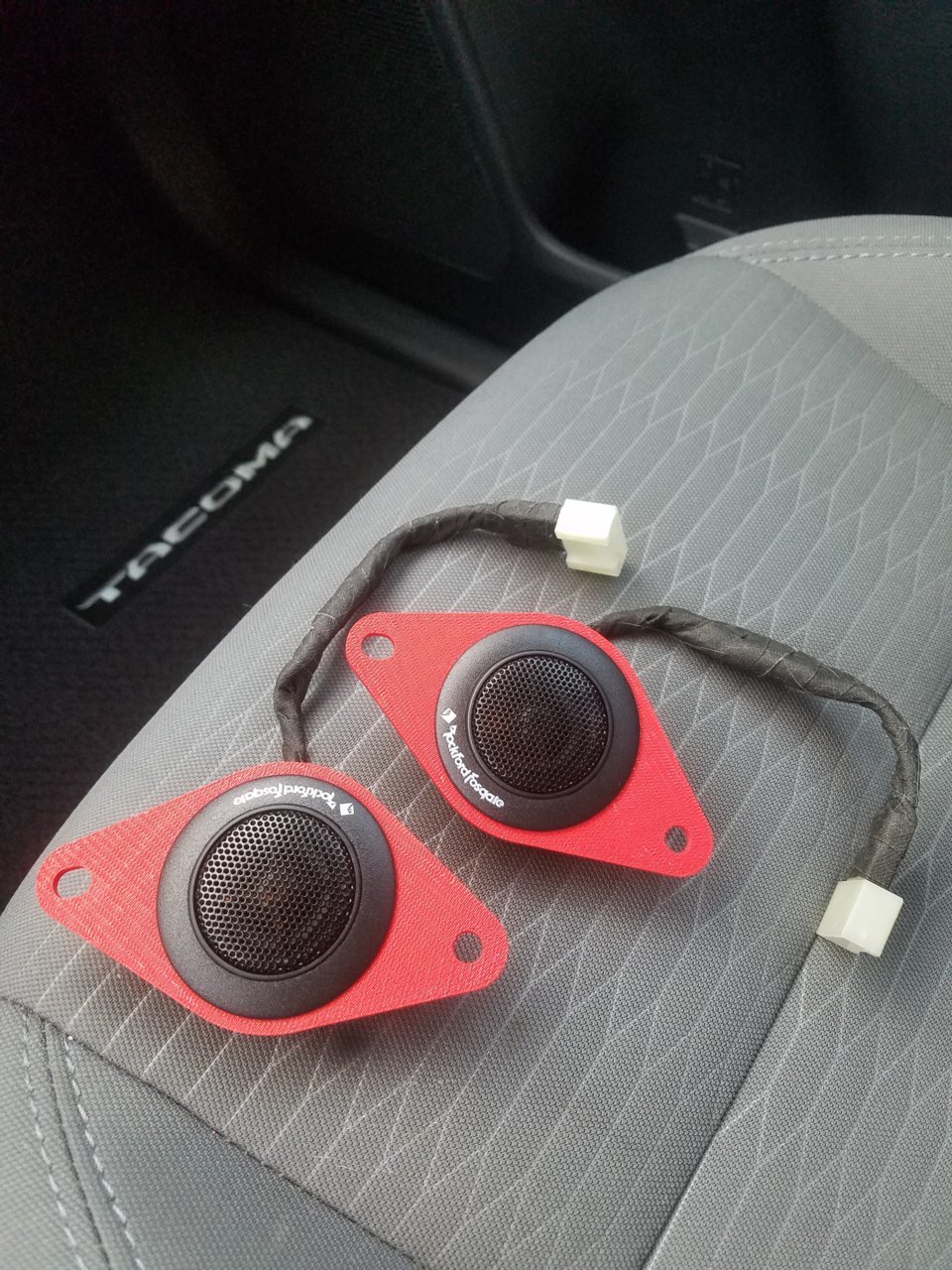

    Yes, you can add any tweeter you like. Just need an adapter plate and harness.

    No I got mine from Taco Tunes when I bought my sub box and amp turn on harness.

    Where can I get the adapter plates?
  17. Dec 4, 2019 at 7:30 AM
    #17
    Deacon Blues
    Deacon Blues Well-Known Member
    Sep 7, 2017
    #229363
    1,468
    Colorado
    2017 SR5
    Member here vietjdmboi 3D printed them for me.
