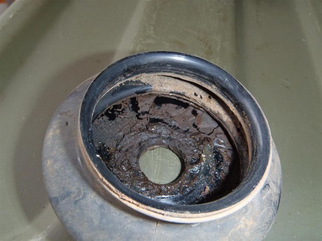

    No press needed to change a balljoint with the LR UCA.
    You mentioned mud. This is the inside of my LR UCA balljoint boot after one year. I avoid mud at all costs. Looks a little dirty yea? Cool thing about SPC (company that makes LR UCAs), is they offer replacement boots for cheap and replacement balljoints for a reasonable amount.

    SPC has redesigned their bushings and their BJ boots. The new boots fit much tighter and I have no concern of contaminates. My last set, warrantied by SPC, wore the bushings and a ball joint out in under 1 year. SPC and Wheelersoffroad were great to deal with and I had the new ones in in like 1.5 hrs so simple fix really.
